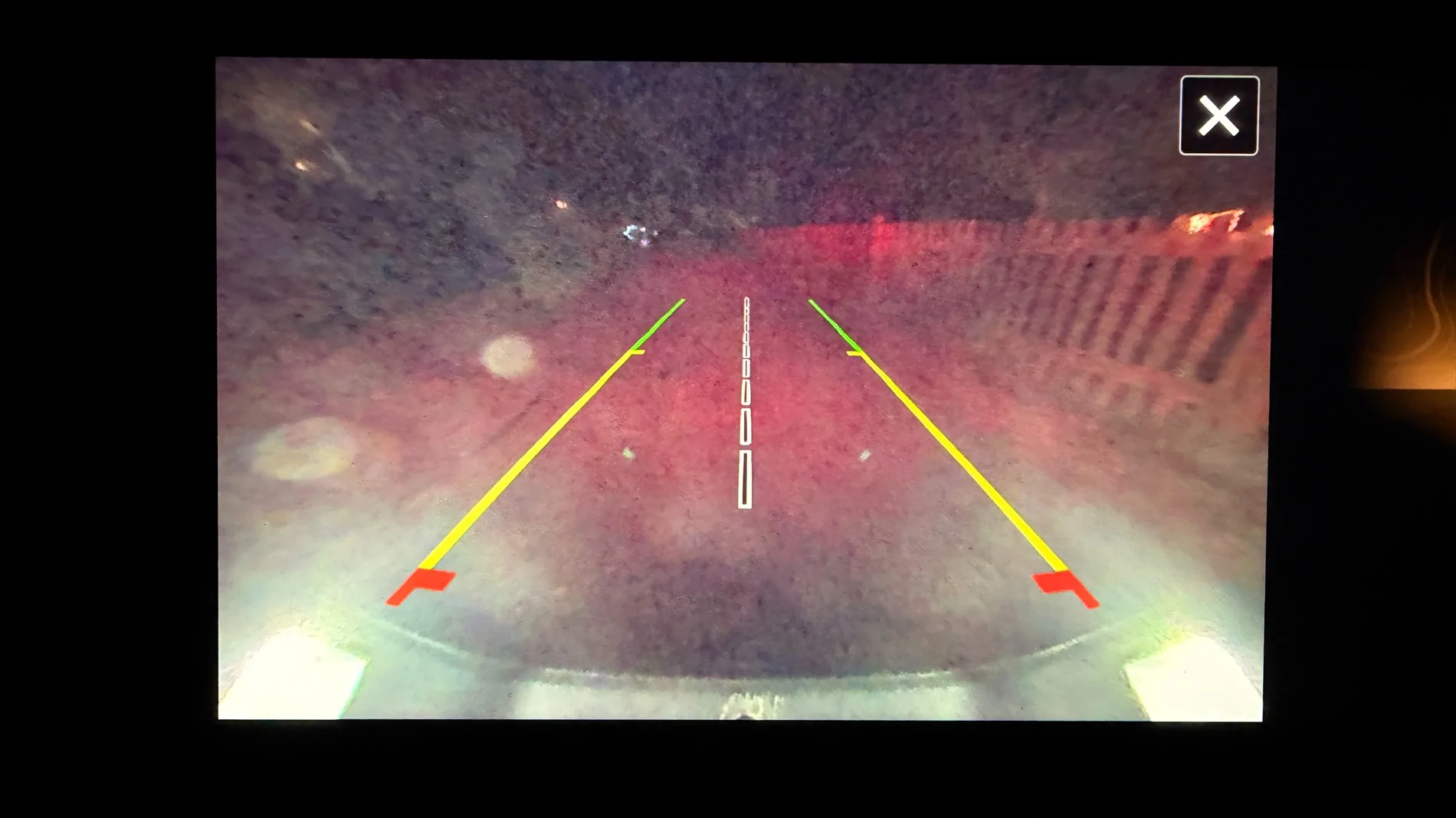

I'm sure you all know how bad the license plate lights bleed into the reverse camera image at night. For reference, this is mine before the mod:
Jeep Gladiator Reverse camera license plate light bleed - my fix IMG_0728

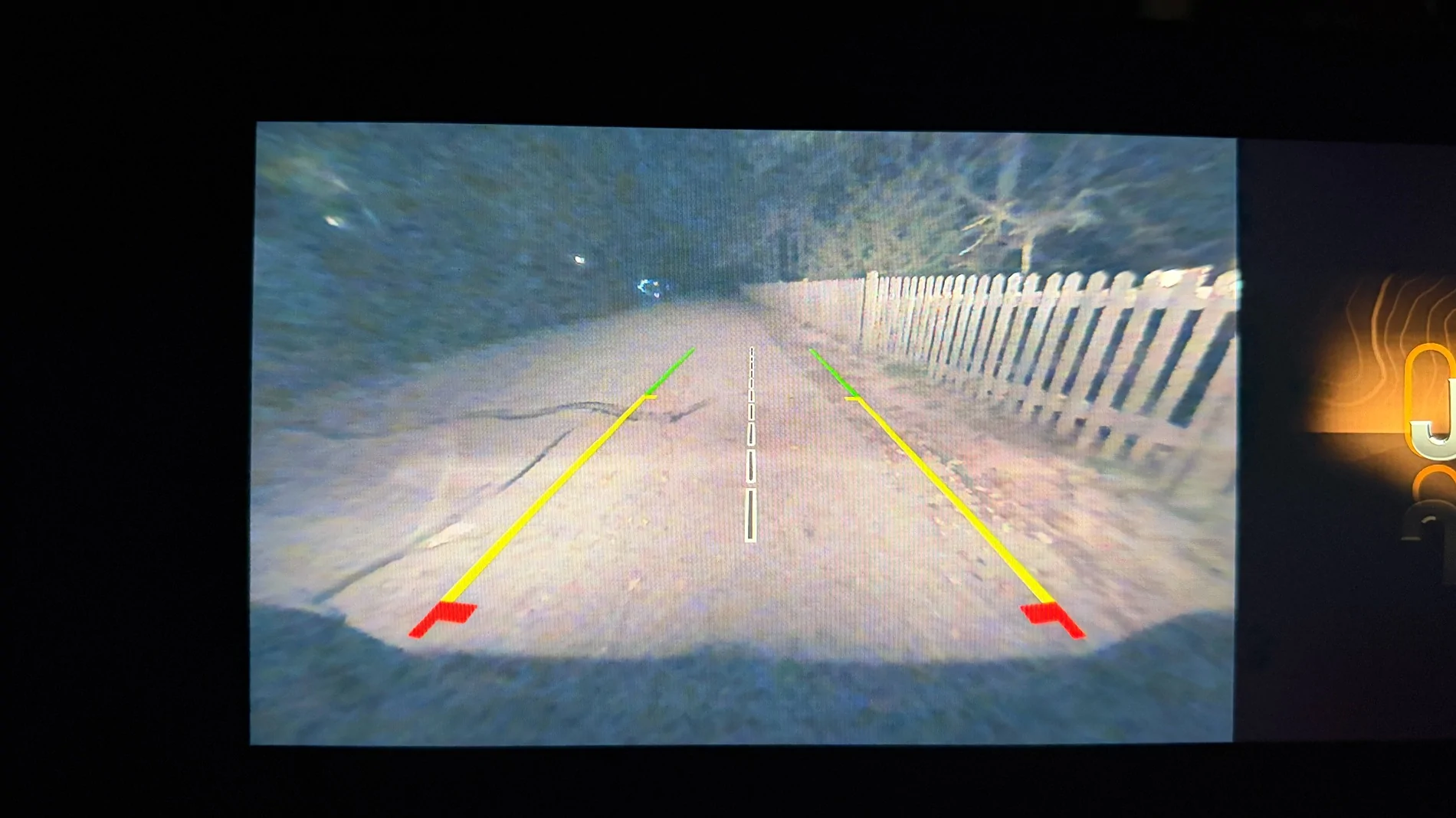

And after:
Jeep Gladiator Reverse camera license plate light bleed - my fix IMG_0730

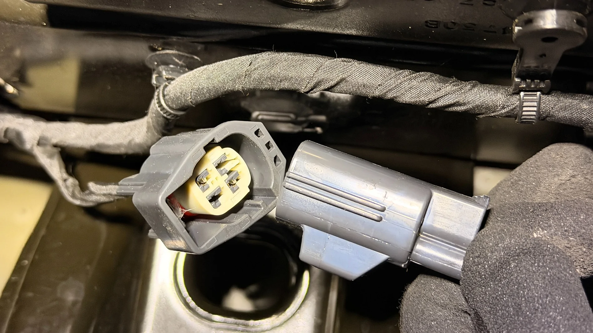

All it took was a normally closed relay (like this one), and tapping into the reverse light wire of the hitch connector. There are ground lugs in the chassis that you can tie to so you're only running a wire for the positive side to the hitch cable. I broke into the positive wire of this connector:
Jeep Gladiator Reverse camera license plate light bleed - my fix IMG_9704
And used spade connectors which I weatherproofed. These allow me to undo the mod by just disconnecting the bypass to the relay and restore the original connection. The nice thing about this fix is if the relay or any of the connections fail (unless of course the license lights themselves), the lights will stay on.
