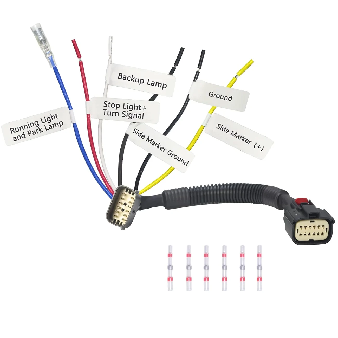

I grabbed this harness from Amazon. My intent is to use it as a non-invasive way to trigger a relay for my Vision X reverse lights when I finally move them over to the new Gladiator. When I first installed them back in '21 I was still working and spending a lot of time in urban areas and I felt that they were just too bright for everyday use, but I really need them for backing down my very long, very rural driveway, so I just put them on an aux switch. Now I'm retired, and my city driving is very rare, so I'm just going to trigger them off the reverse lights on the new Gladiator. I have a Tazer already, but there is really no reason why you can't use this to trigger a relay for the camera instead. Heck, with the proper relay you can even do both.

Same can be done with a single relay and some wires...........

3) Same can be done with a single relay and some wires...........
1) My 2021 Willys has crystal clear image, compared to the 8.4" screen in the 2024 Renegade Limited I had for a loaner which looked pixelated. even compared to my grandparents 2017 Chevy Colorado Z71 or 2019 Equinox LS, the image is at least 720p or 1080p in my 21 vs 480p in everything else.
2) Before I took the Willys in for the warranty stuff recently, my Tazer would randomly just refuse to turn off the plate lights at times. Everything else would work fine, just still had plate lights on in reverse. Haven't had that issue since I got it back, pretty sure they did an update. Or maybe this time the unmarrying process actually worked right haha.
3) I'm thinking about making this harness to be PnP and look factory or better. Just so I don't NEED the Tazer plugged in to use this function.

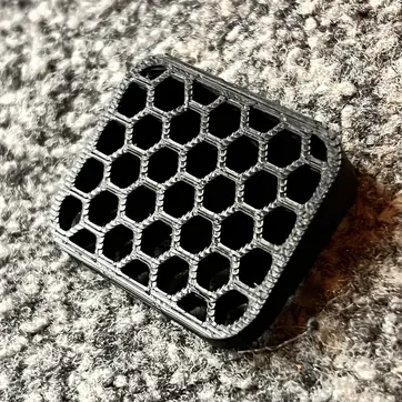

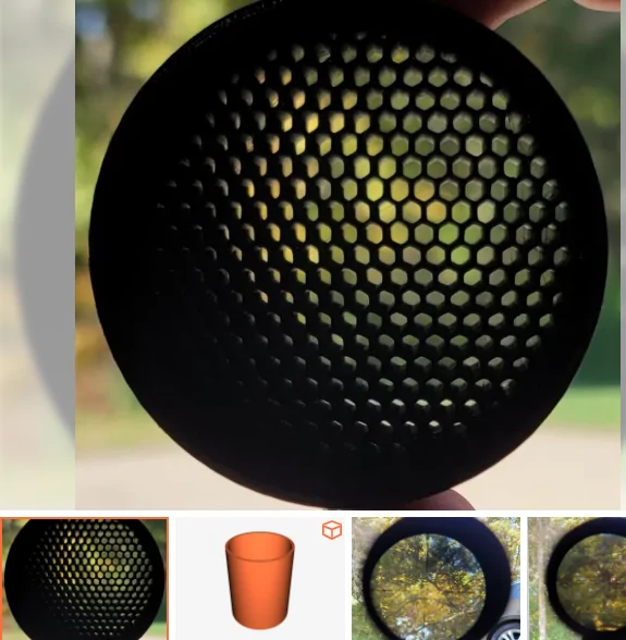

Sorry if I'm not supposed to drag up old posts, but the idea I had kicking around in my head is for a killflash - basically a honeycomb filter that only allows the light to shine in the axis of the cells. It'd fit inside or replace the bezel and is pointed at the license plate, and nowhere else.
Wonder if this can be 3d printed?
Interesting idea....but it would have to be in a 45 degree (or whatever) angle the plate lights are mounted at..right?

https://cults3d.com/en/3d-model/game/uh-1-airsoft-killflash-sovietonion

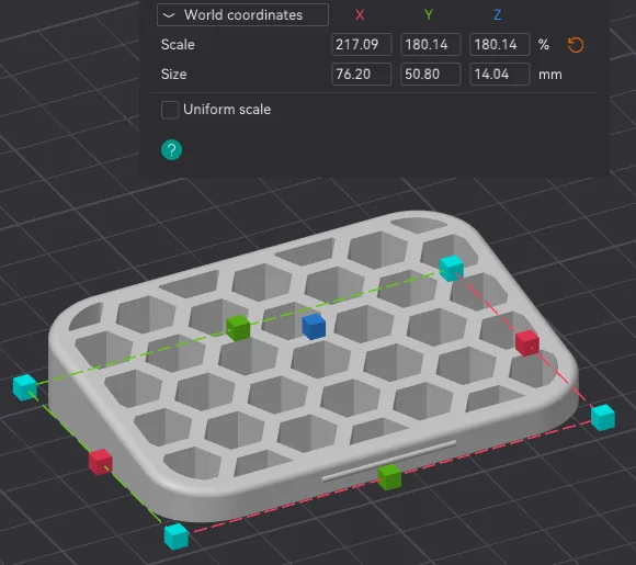

Jeep Gladiator Reverse camera license plate light bleed - my fix 1778268140504-e8
3" (76.2mm) x 2" (50.8mm)
I am gonna play around with this and see what shakes out. Will confirm the actual light bezel size when I get home and see if there is some way to integrate/mount it cleanly.

Exactly. The honeycomb needs to be pointed at the license plate, not straight out like the optics killflash.
You would block too much light. Just use a relay. By law the light must make the plate visible xxx feet away at night. These barely do that as it is. Don't overthink or reinvent the wheel....relay it
