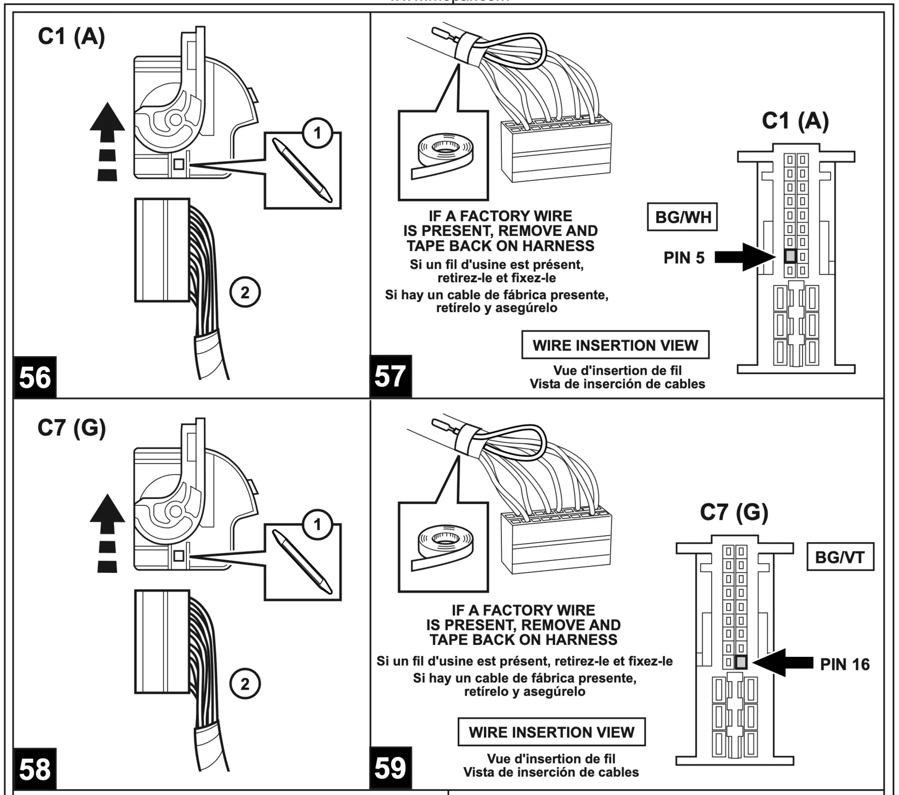

Did anyone figure out if the Ram lamps physically fit the Gladiator?
I've attached the installation instructions for Mopar Ram Cargo Bed Lamps.
The harness has a ground wire and two additional wires that go up to the front. Maybe those two are B+ and switched, or it's 3-way switched.
