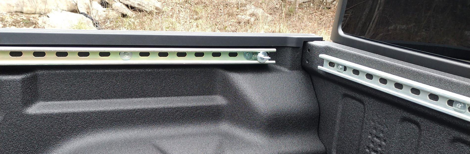

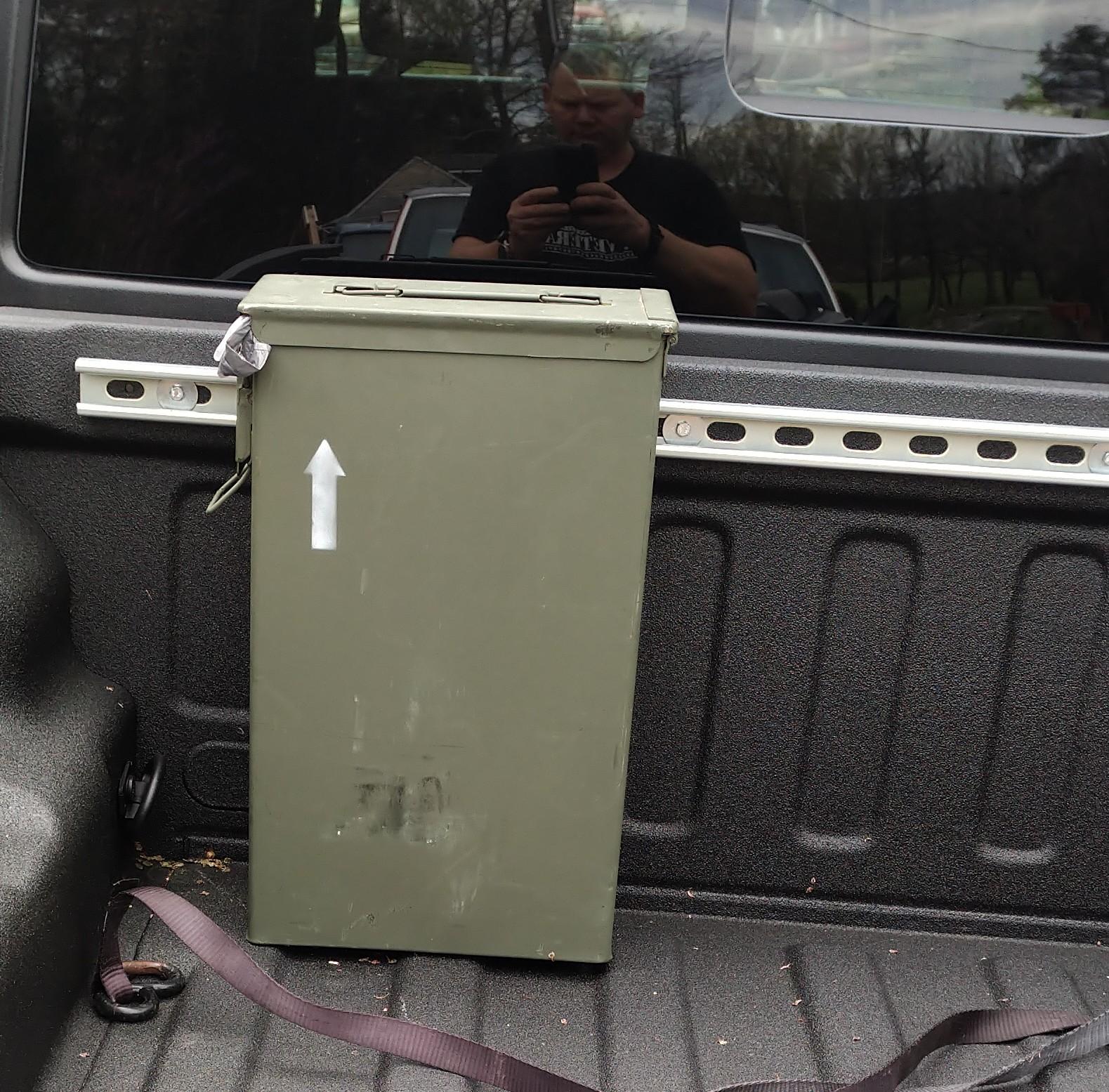

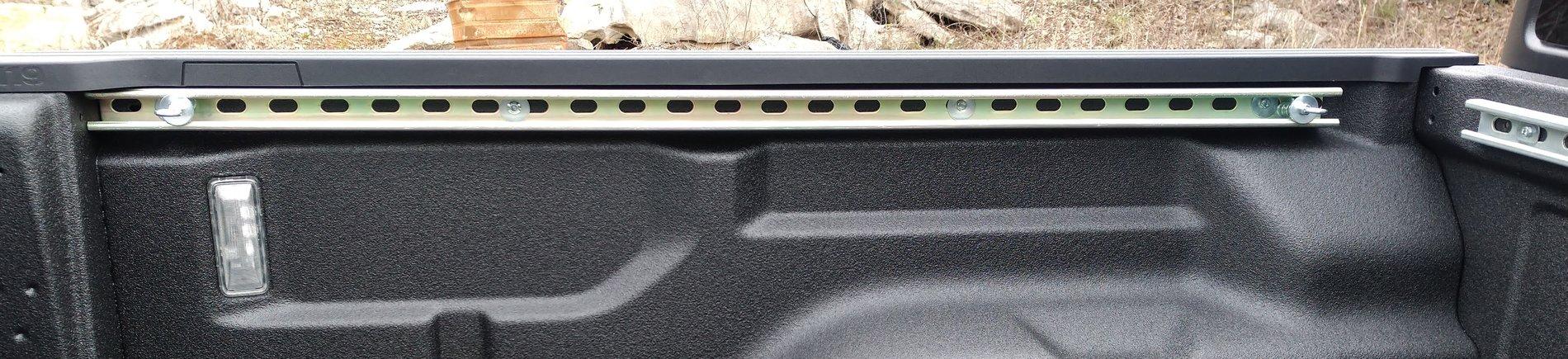

Thanks to you and the others that have done this, I copied it on front rail I used the half width strut. Then I added a tall "ammo can" too I'm going to modify how it's mounted some more probably and re paint the can, have can like that on my XJ I used for recovery gear. Not sure I'll use this one for that. Might be use for rachets straps and tie downs.
Jeep Gladiator Bed Rails On The Cheap IMG_20200223_133350~2
Jeep Gladiator Bed Rails On The Cheap IMG_20200223_133345~2
Jeep Gladiator Bed Rails On The Cheap IMG_20200322_153902

i added a "normal" ammo can. Never heard of a tall one. Where did you get it?
They are for rockets, mortar or NVG (night vision device's) surplus stores and such have some times.

I had to wedge a coat hanger in track to hold cam nut inline to tighten bolts for the can I mounted. One of reasons I will probably re mount it differently.
