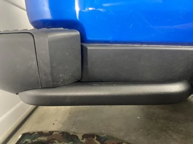

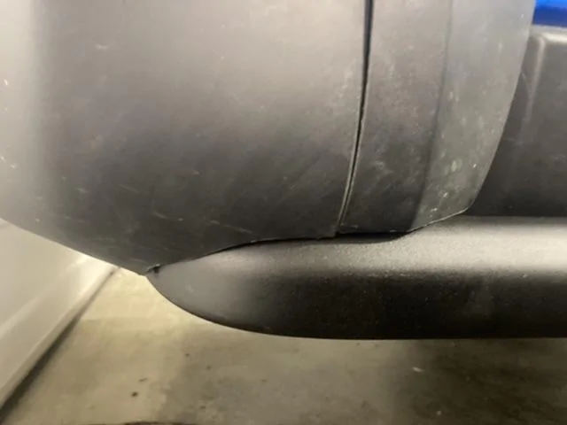

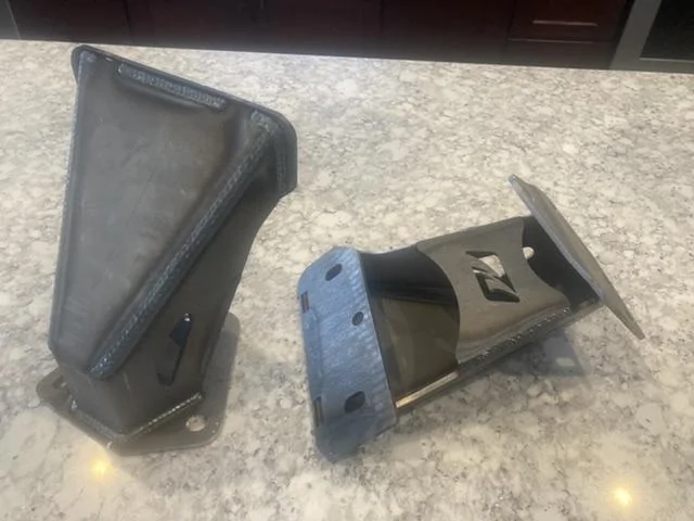

Thanks guys your posts helped me a lot, got it close enough that I’m not using the trim gasket. Very happy with how it looks and went, I did the Motobilt brackets , pretty impressive. .......Jack

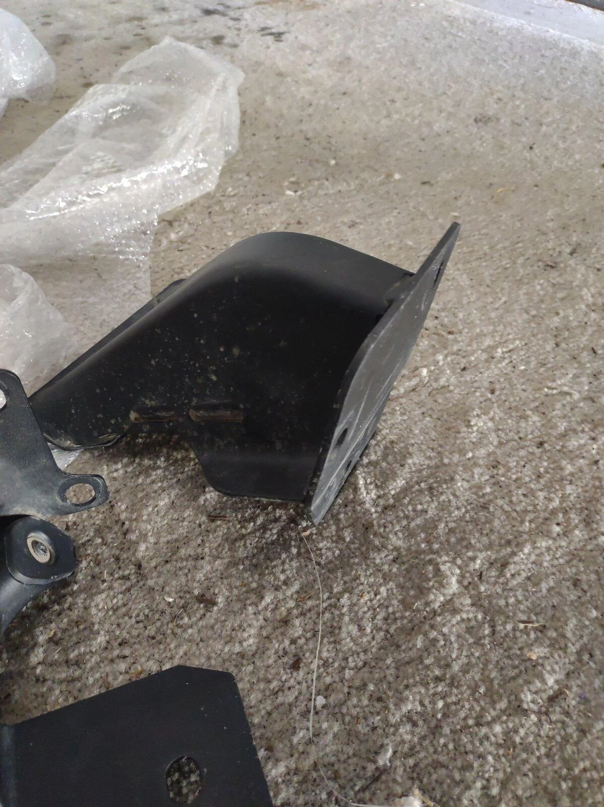

The brackets that attach to the bumper end with the 2 bolts have to be removed and they are not used. The new brackets for the rails replace these brackets.
The brackets and bolting up the rails is straight forward and easy.
You need to take the time on trimming the plastic on the bumper.

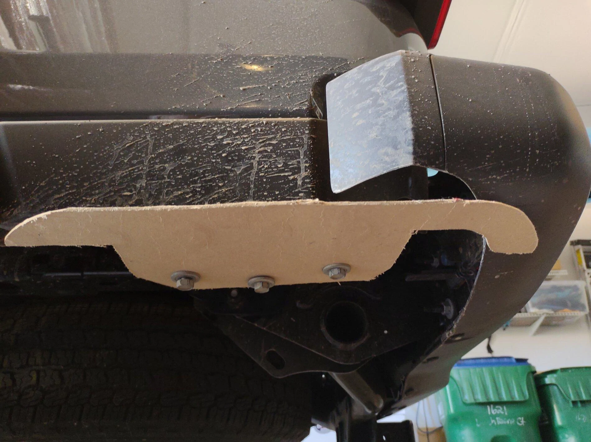

Got that part. But what about the main brackets that attach to the frame? Got it. Made a cardboard template for the bumper cut. Should work for both sides.

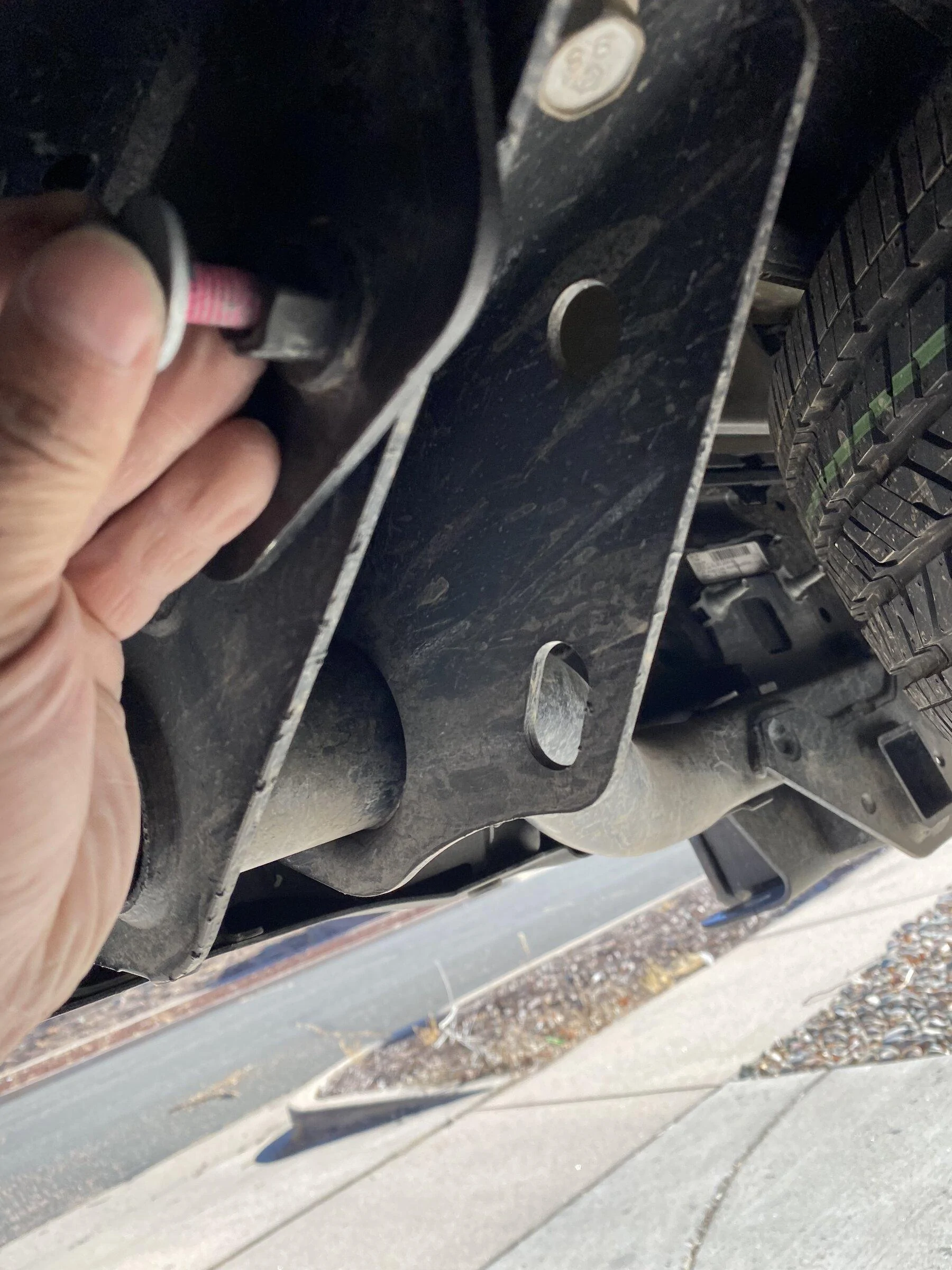

These are the bolts you need with order numbers to mount the rock rails to the frame of the truck.
Can you confirm we need (2) of these long bolts? I read a shopping list in another thread, and it said we need (14) of the 6512870AA bolts and that’s it. I’ve never seen these long ones. Thanks in advance
DocMike
May 28, 2020
2,554
4,766
Colorado Springs
Education
I just added these to my JT. The longer bolt is the one I am missing. I'll hit up Jeep Next week for the two longer bolts. I think the diameter is a bit bigger too. Because my shorter bolts felt loose in there.
Jeep Gladiator Installing Mopar Rear Bed Rock Rails on Overland and Sport Gladiators IMG_9761
DocMike
May 28, 2020
2,554
4,766
Colorado Springs
Education
Correct me if I am wrong, but the long bolt goes there. The other bolts do not thread in there.

I just installed a set on my Sport S. I started on the passenger side and used my Dremel and cut off disc .... it was a PIA so when I moved over to the driver side I used a hole saw for the radius cuts. The second side went much faster. I did find it easier to first remove the inner steel plate from the bumper ... then remove inner plastic corner plate. There are some white plastic clips you'll need to remove. If you take care they will pop right out ... otherwise you'll break the tabs on the actual corner piece. I did this and had to reconnect using some push tabs.
