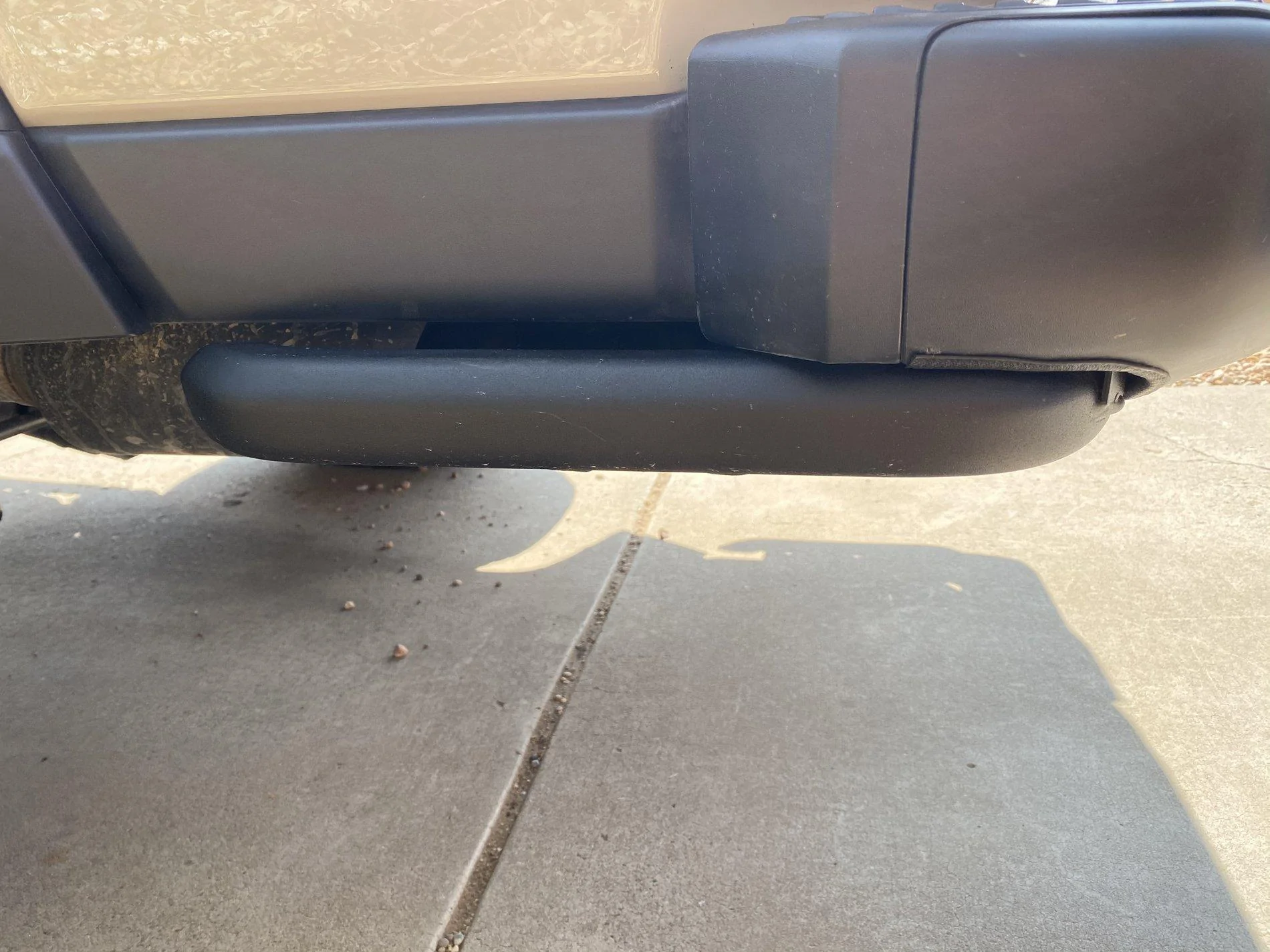

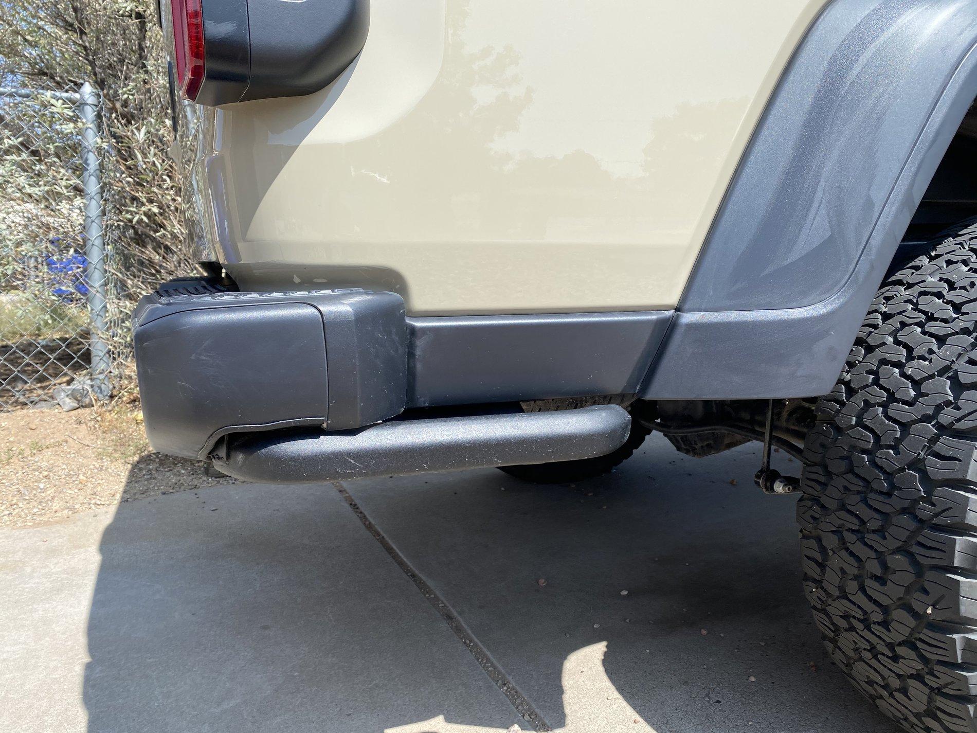

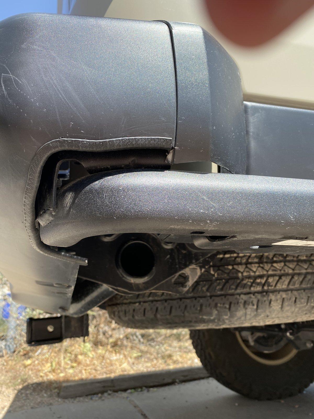

If anyone is wondering if the Mopar Jeep Rear Bed Rock Rails will fit the Sport and Overland Models, they will with a little work..
There are 4 pieces to the rails, 1 frame bracket that attaches to the frame with 3 bolts and the Rock Rails themselves attach to the bumper with 2 bolts and 3 bolts to attach to the frame brackets.
The frame brackets were easy to find, the actual Rock Rails not so easy…
They obviously don’t come with any bolts or instructions.
I wanted the rails for some protection, but primarily wanted to fill in some of the Gap at the back of the Bed.
I always liked the look the Rails give the JT.
My guess is most after market rear bumpers will fill in the area the Rock Rails use now, and probably incorporate some type of step. *Rubicon owners in some cases might have to remove them if they go to an aftermarket Bumper.
I plan on staying with the stock bumper for now, so this was my best option. *Just about $400 for everything, which is a expensive for what it is…*
The one difficult part is trimming the bumper to accommodate the Rock Rail. You have to trim off about 3 inches in the pattern of the Rock Rail.
You also have to remove 2 brackets, 1 metal and one Plastic, on each side of the bumper for the Rock Rail to attach. The Rock Rail replaces these brackets.
If anyone else decides to do this here are a few suggestions.
  1. Don’t remove the bumper to trim it for the Rock Rail.
  2. Leave it in place and take your time to trim it out.
  3. How you trim/cut the bumper is very visible, so go slow and steady.
  4. I trimmed the bumper with a razor and then filed it to Rock Rail.
  5. I also used 1/8 edging trim to give it a better finished look.
This will work for now, but if a good "light weight" rear bumper becomes available, I'll have some rear rails for sale.

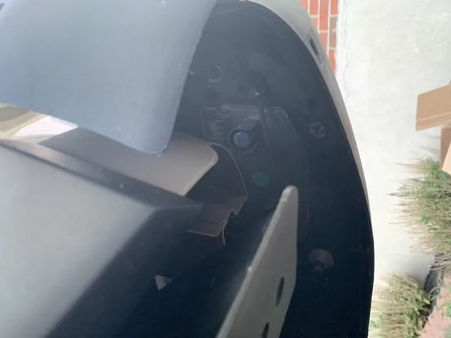

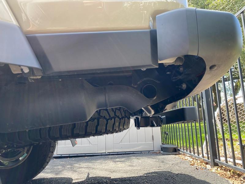

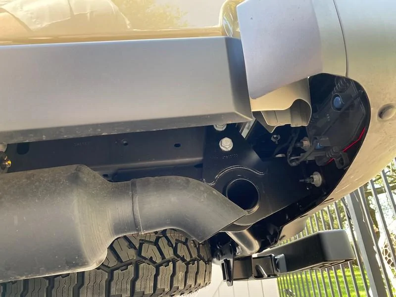

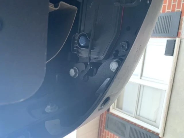

Has anyone installed this on a sport or overland with blind spot safety package? The reason I ask is that I have several prox sensors around the bumper and it looks like the plastic bracket that some have removed is what’s mounting the prox sensor in place. Not sure if I have enough space to mount the rails over the bracket and sensor. Don’t want to cut the bumper and find out that I’m out of luck. I took a pic of what I’m referring to on the LH & RH side.

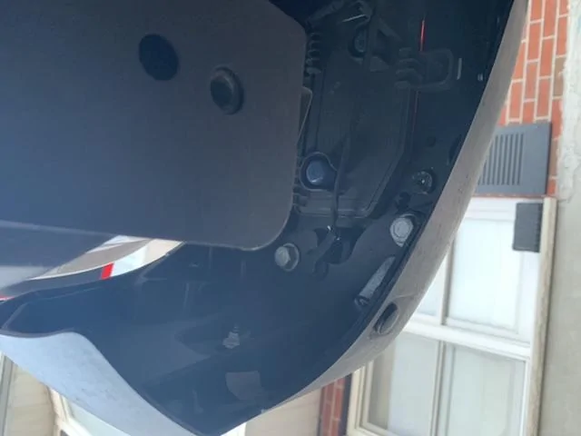

I guess I posted too soon. What I thought were the prox sensor leads were actually just plastic hangers for the prox wiring. I ended up pulling out the plastic and metal brackets on each side until I started running out of daylight. Got the sill boxes up and called it quits for the night. I took some more pics of the brackets that must be removed and will post tomorrow. I’ll also post the specifics on hardware used because I wasn't 100% sure based on the posts and available info. I ended up to going to Ace Harware with the sill boxes to make sure.

Cutting was pretty easy. I rough mounted the left on the right and right on left upside down since they are mirror images and traced the outline. I then used a sharp razor blade knife and trimmed away the necessary areas. I bought some 1/8” trim from McMaster as suggested in a previous post but may not use it since my cuts were extremely close to the rail outline.

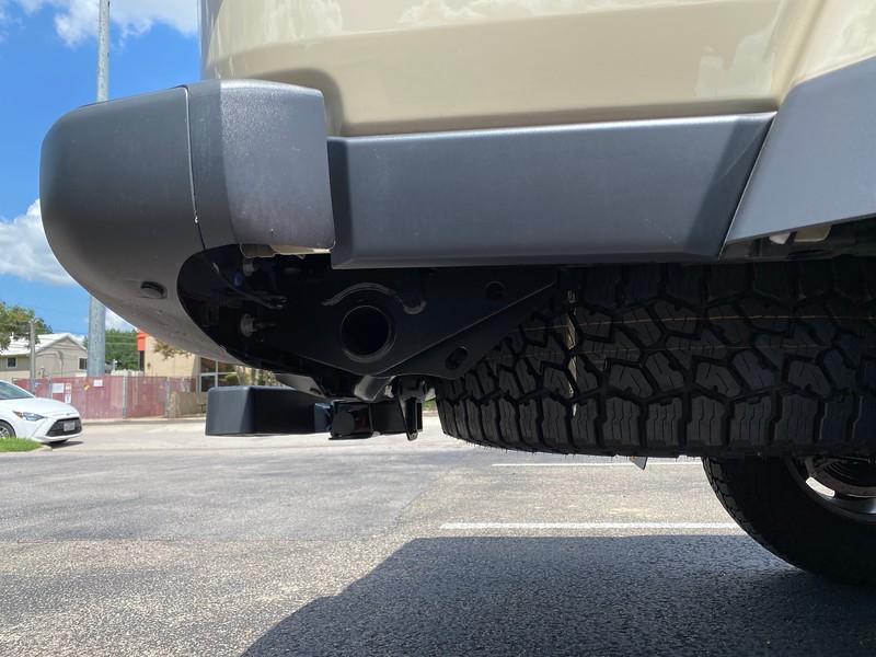

I was curious about adding these to my Mojave.
Mojave comes with a plastic bumper, but can you tell from these photos if this "Mojave" bumper already has the precut shape for these rear rails to work without cutting the bumper ?
Also if you guys have some photos of how the brackets attach it would be appreciated, thanks.

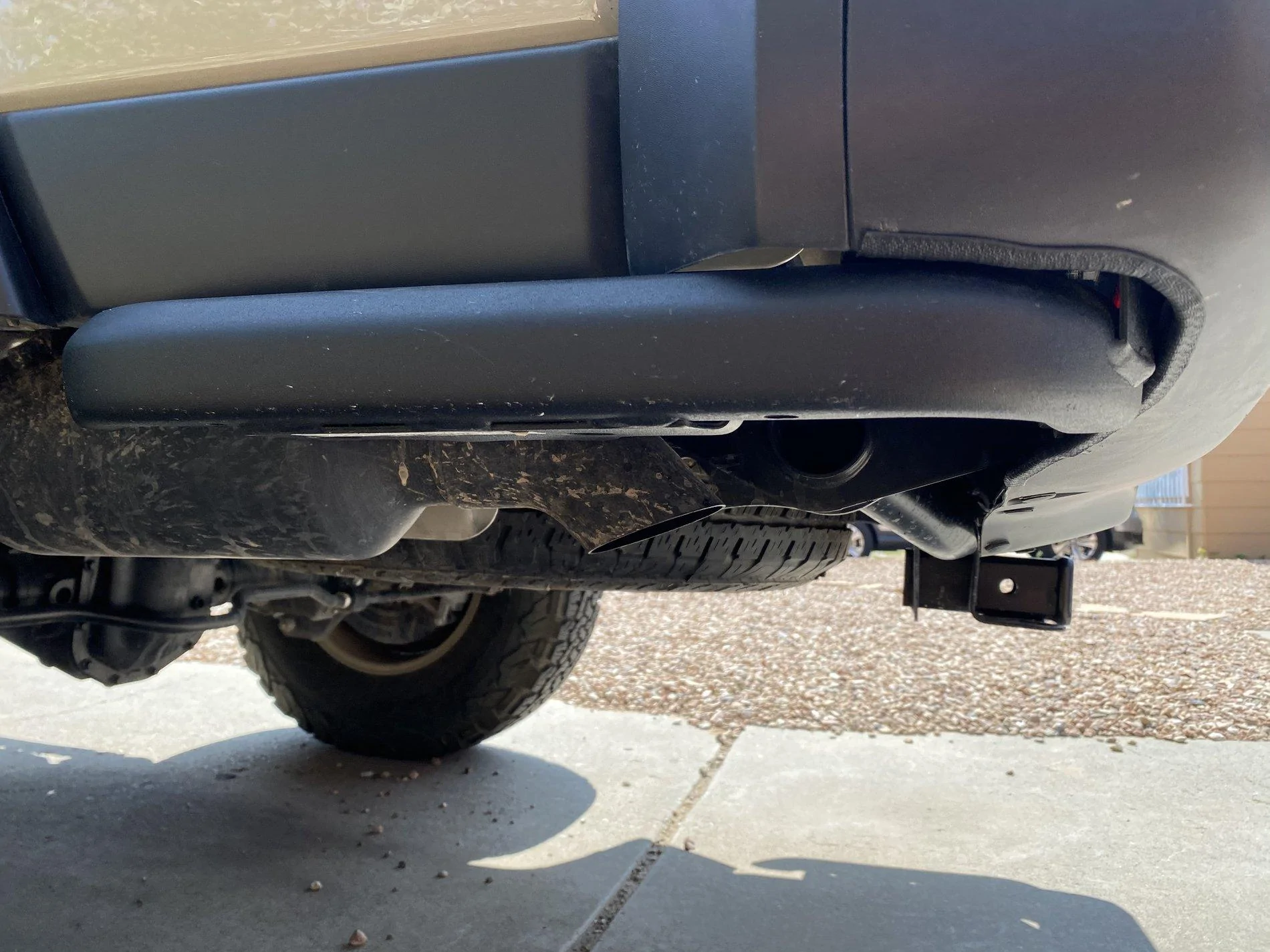

Found the bracket and sliders on eBay fresh take offs for 300 total. Still not ideal but better then full price. Just finished the mod and still short two bolts. Need a little adjustment but so far looks good. This will work until a new bumper comes along.

no you will have to cut and no you don’t have the bracket. The part numbers are listed above in this post. I would probably just buy the Motobuilt ones since they work with the sliders I believe. Shows a picture which the Jeep made ones looks similar.
https://motobilt.com/collections/je...r/products/gladiator-rear-bumper-frame-mounts
