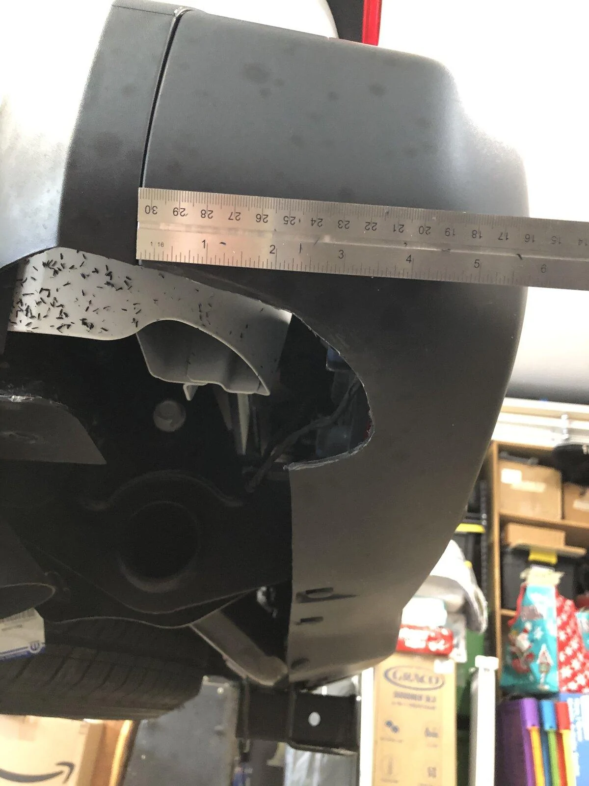

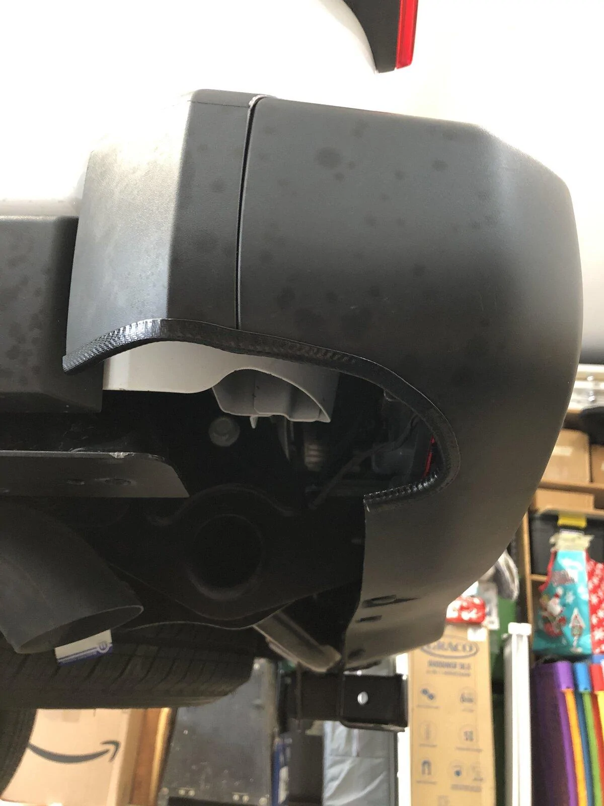

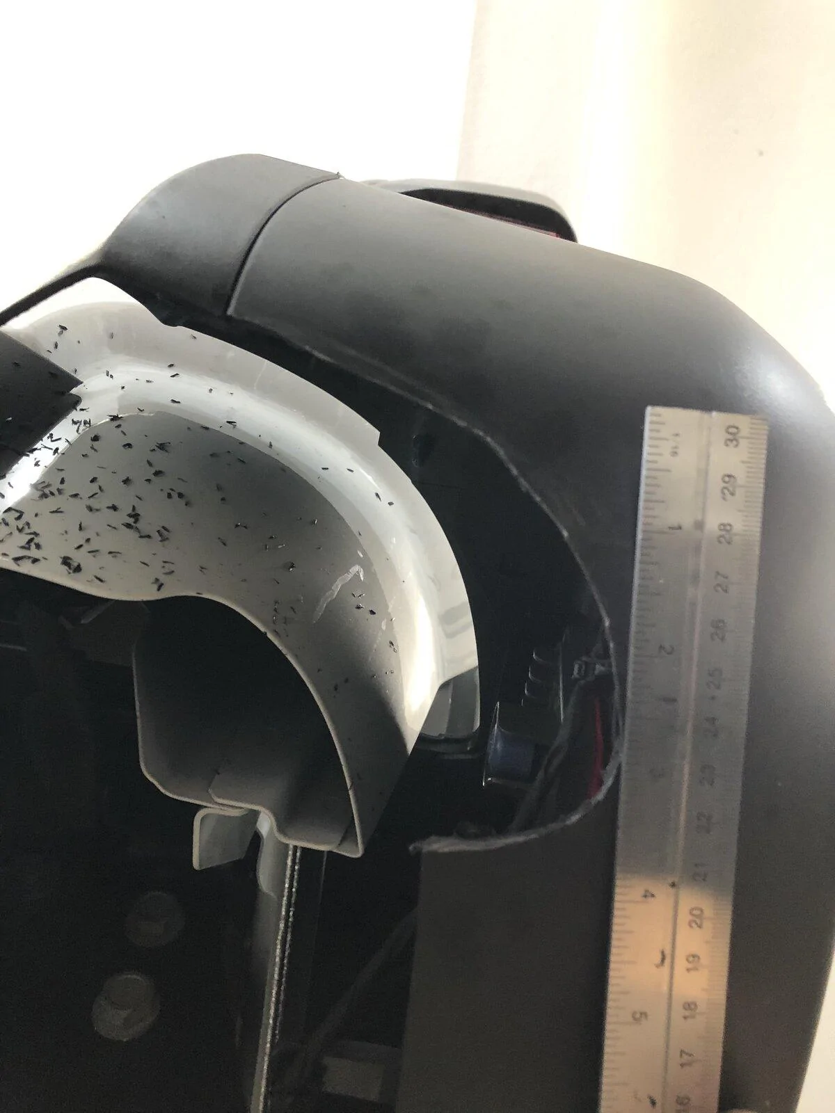

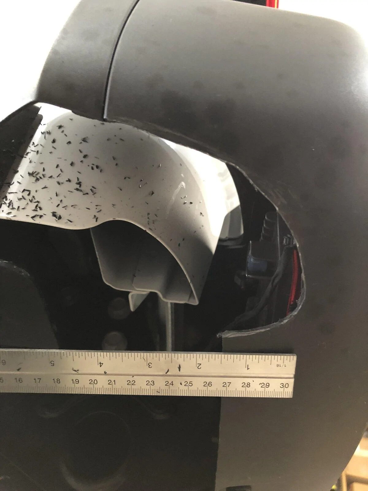

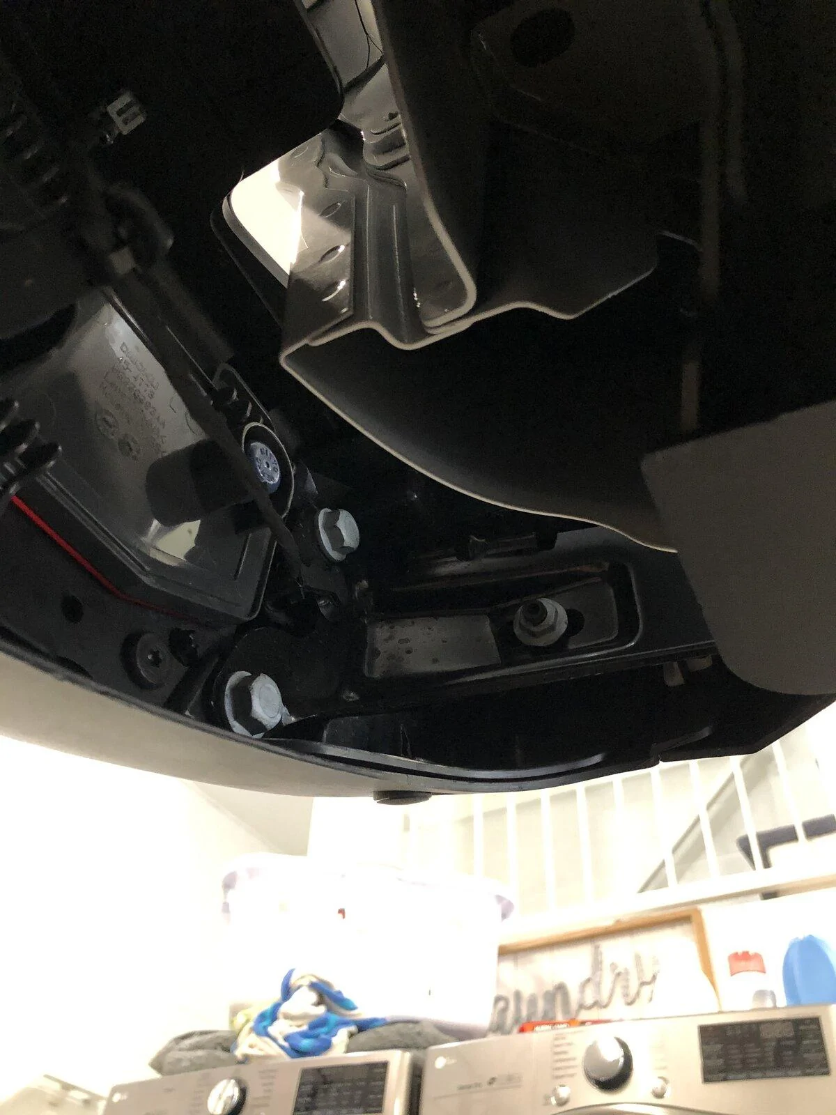

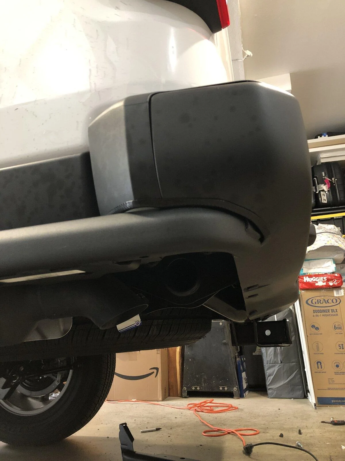

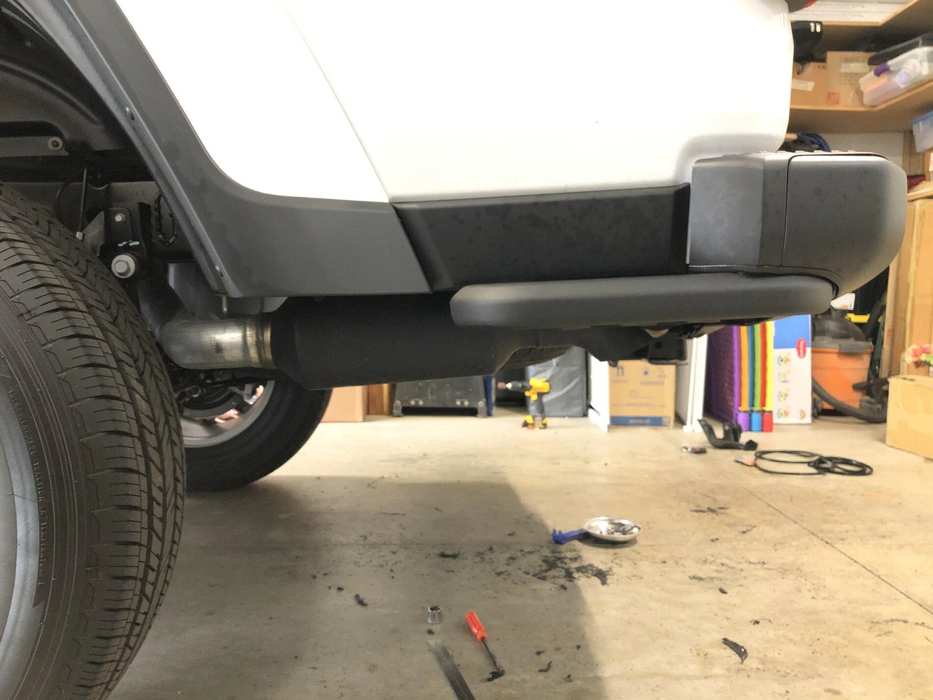

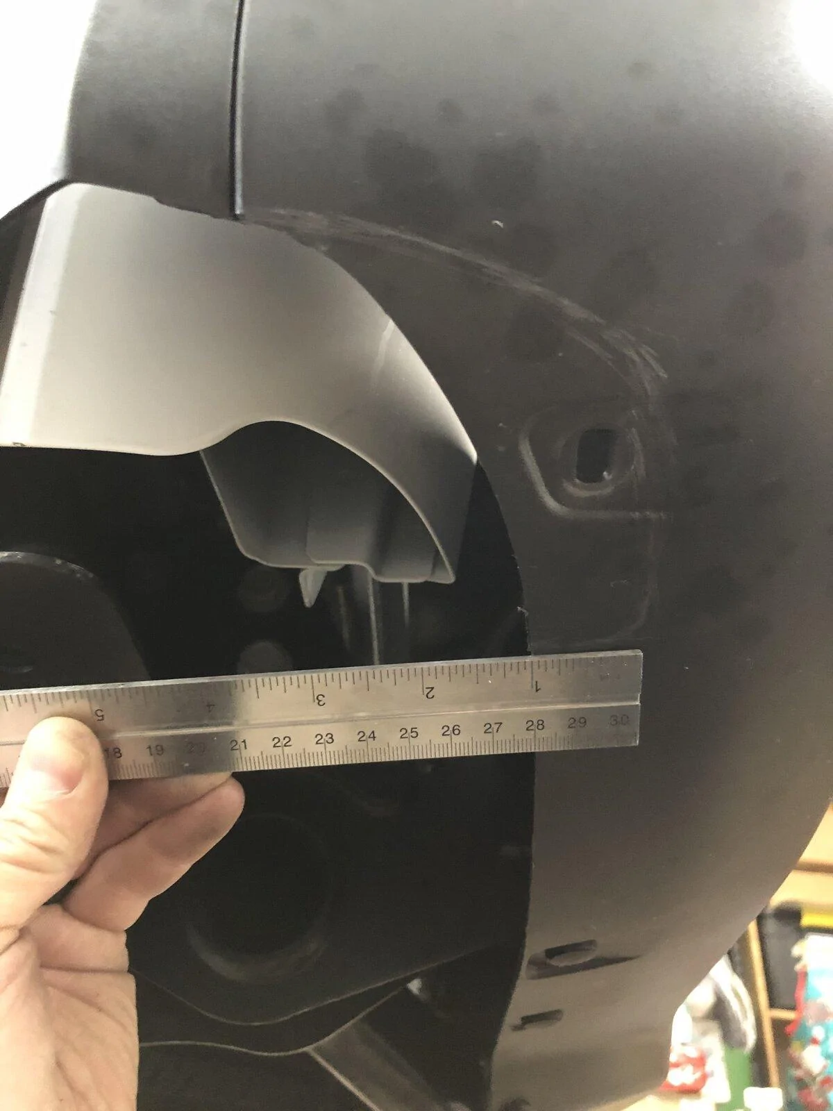

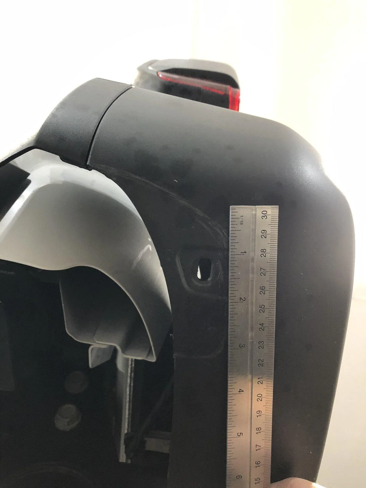

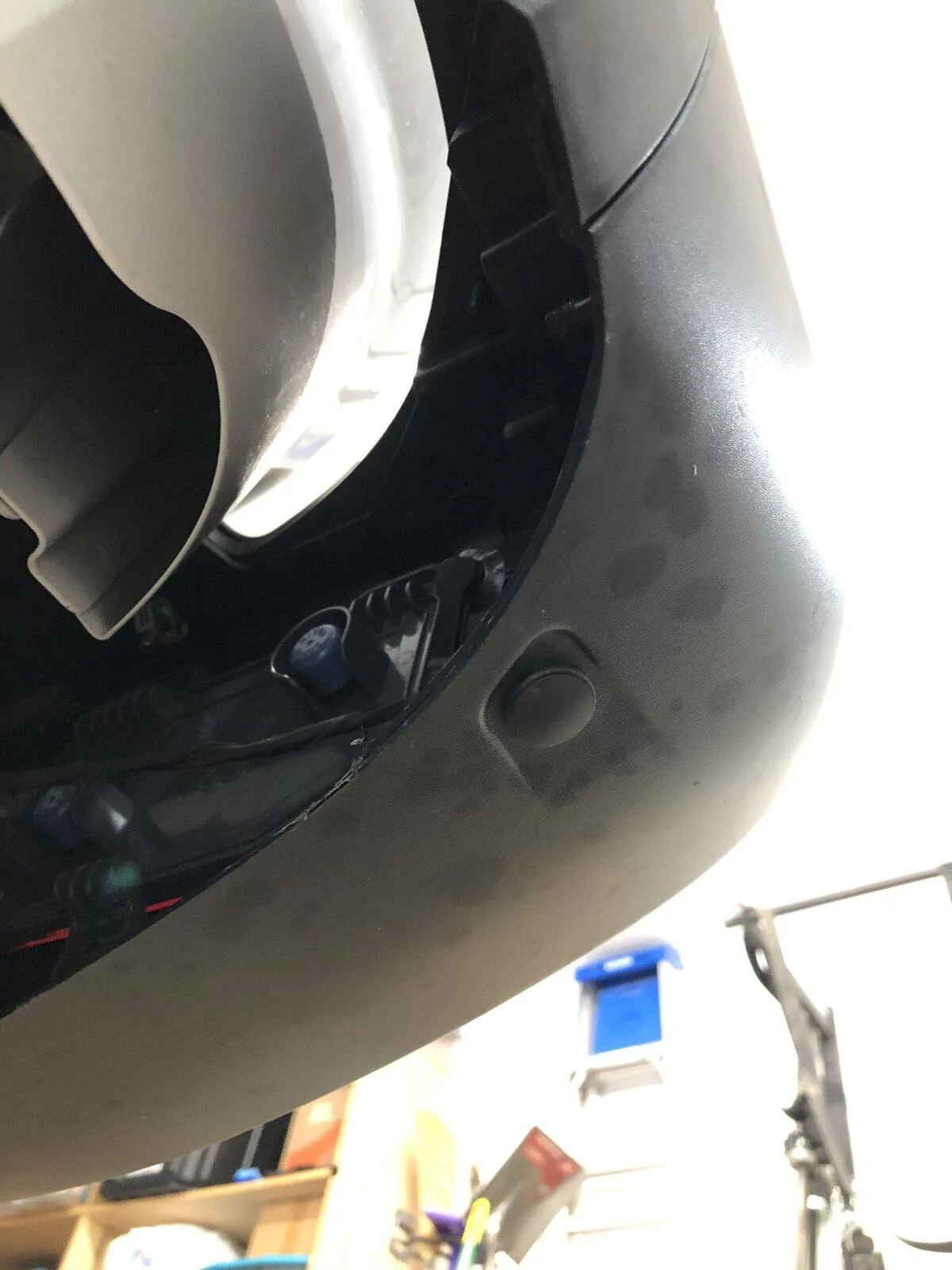

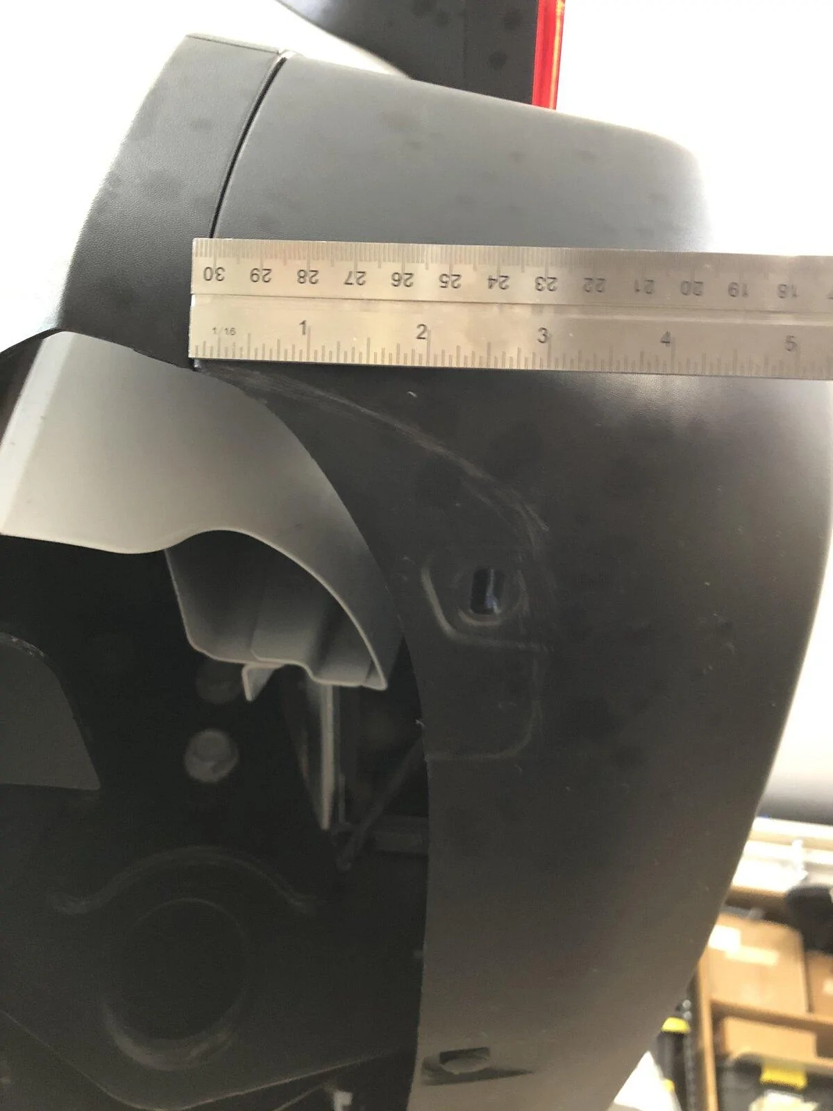

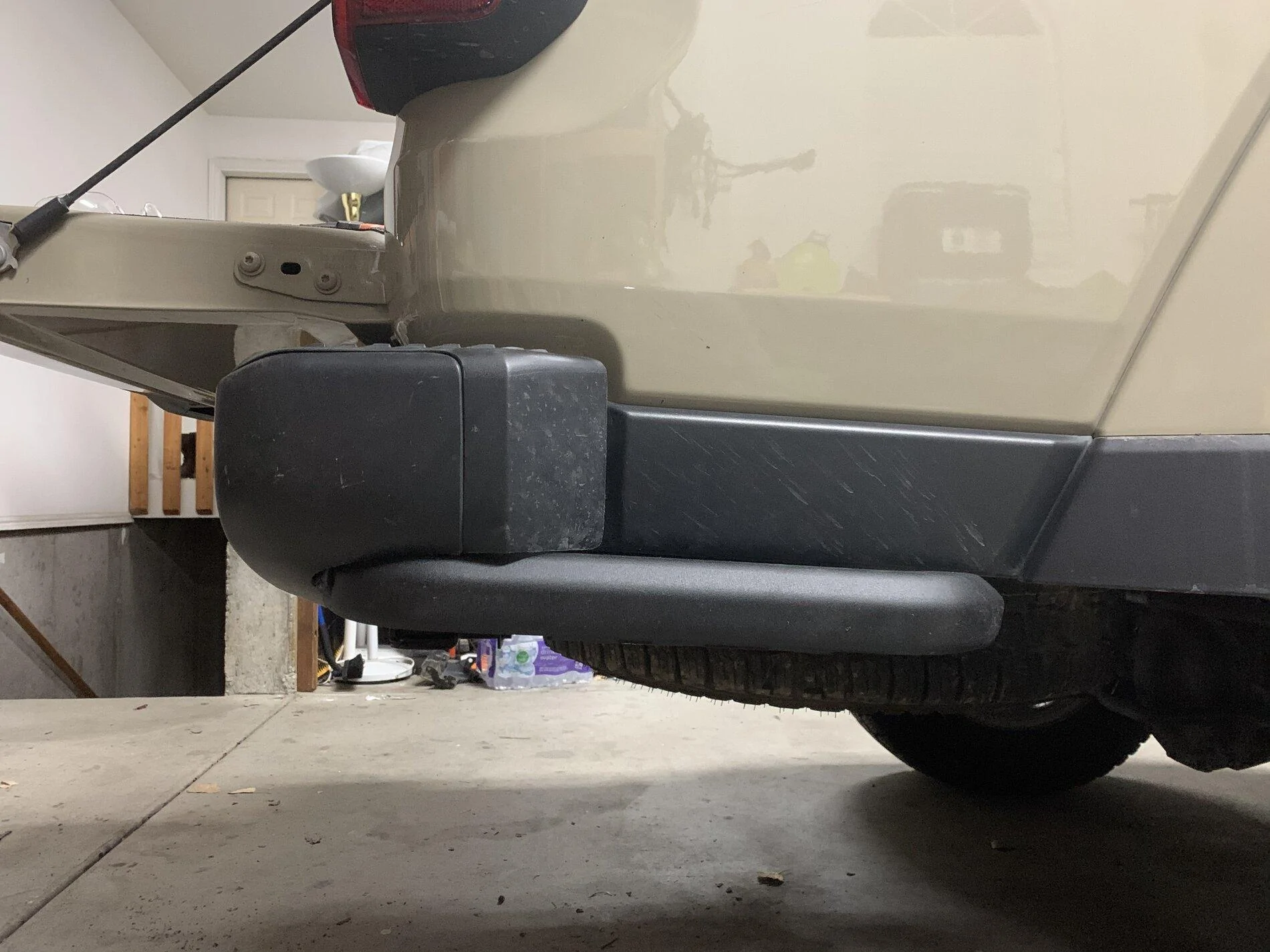

I was curious about adding these to my Mojave.
Mojave comes with a plastic bumper, but can you tell from these photos if this "Mojave" bumper already has the precut shape for these rear rails to work without cutting the bumper ?
Also if you guys have some photos of how the brackets attach it would be appreciated, thanks.
no you will have to cut and no you don’t have the bracket. The part numbers are listed above in this post. I would probably just buy the Motobuilt ones since they work with the sliders I believe. Shows a picture which the Jeep made ones looks similar.

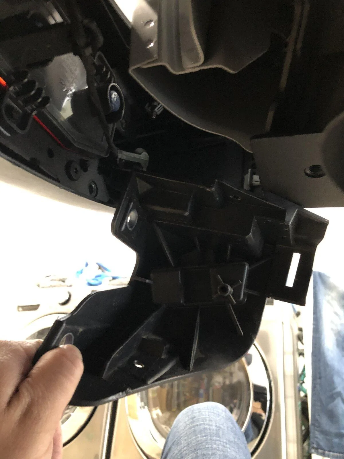

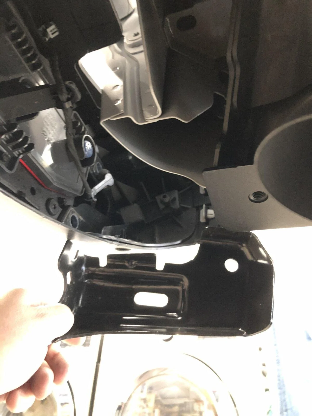

Any pictures of how and where the frame brackets attach to the frame. Wish there was a video of an install.

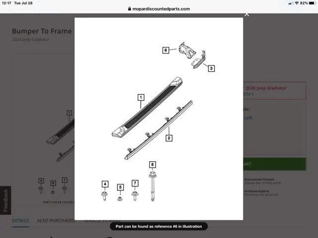

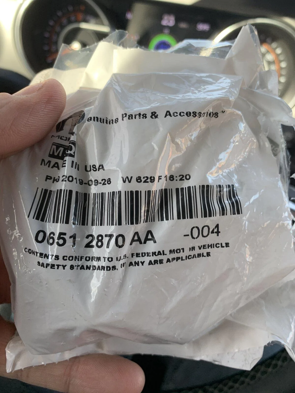

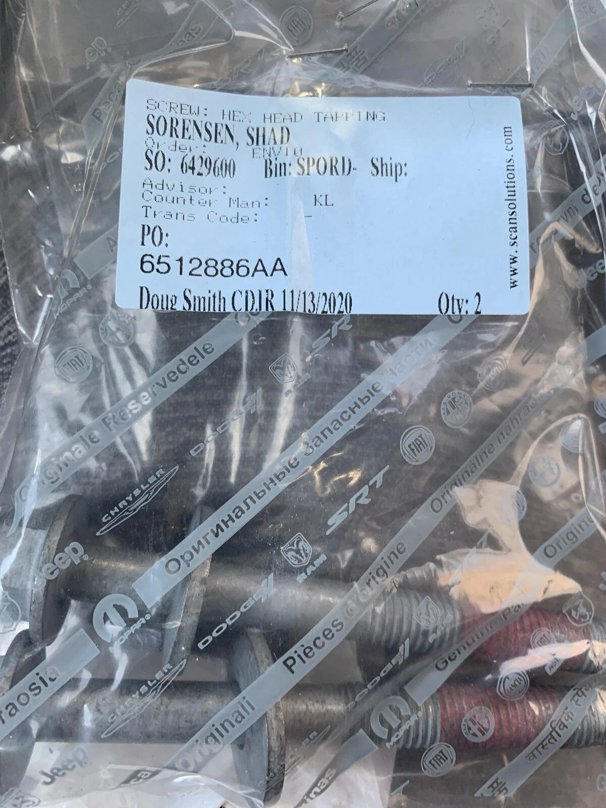

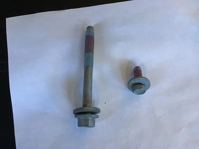

What are the size of part number of the torx bolts that attach the rail to the frame bracket and the rail to the bumper? I know there are 3 that go into each rail to mount to he bracket.
Sower3213
Jul 5, 2020
Rapid City, SD
2020 Jeep Gladiator Sport S
Full-Time Volunteer

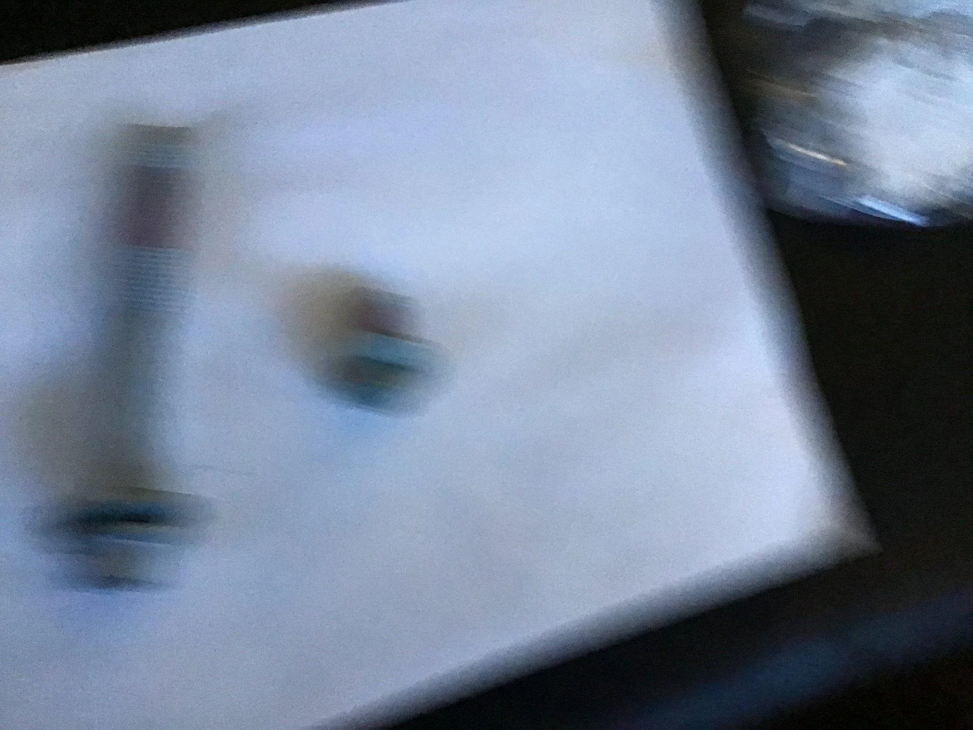

You need 5 small and 1 large bolt for each side. I just took the diagram photo to my local Jeep deal - Jim Click in Tucson (Great parts dept) and they knew exactly what I needed. I’m sure your local folks can take care of you.
