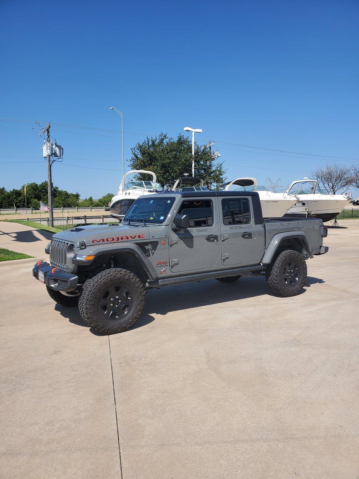

2in aev with geo brackets and 37 bfg. No noticeable difference in ride quality.
Minimal power loss. I do not have a heavy foot and no hills where I live. Still averages 17.5

Good to see that the 37's fit well on the stock rims. I am doing the same 10/11. Did you use any spacers? Do you have any rub at full turn?
No rubbing. Backspacing is different on Mojave wheels compared to all other models

Got my 37's installed yesterday. Really happy with the look and no rub even at full turn. Also, I like the fact that the tires don't stick out to far beyond the flares. I had bought some 1.5" spacers in case there was some rub. I may add one to see how it looks before returning them.

If you go back some in this thread, I have the AEV 2 inch Mojave lift. The 35's would have shown to much of the wheel well's for my liking. Other than color, my jeep looks almost identical to 4573davidb's above.
