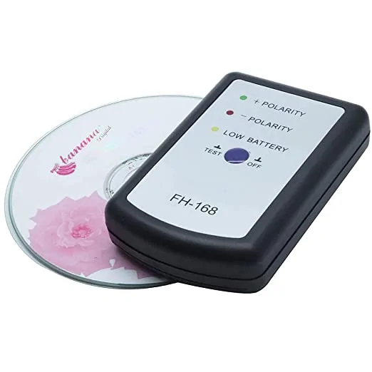

You can order a tester off amazon for fairly cheap or download a app off your phone, then just play the test tracks and hold the device next to the speaker. It will tell you if its positive or negative and just make sure they all match one way or the other.

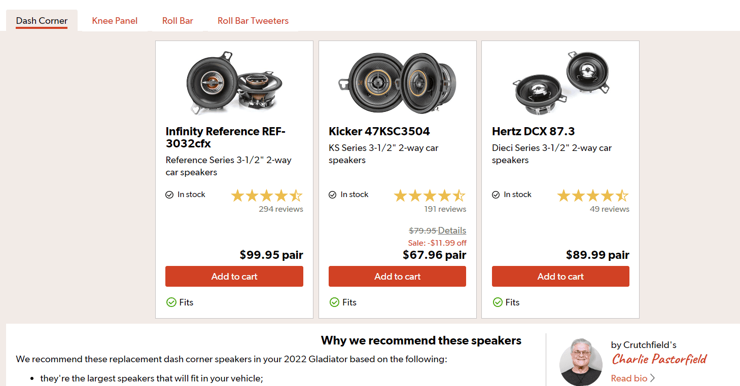

I saw somebody post that they really like the JBL club 322F for $80. https://www.crutchfield.com/S-kUTDiapBQwb/p_109CL322F/JBL-Club-322F.html
So I went to Crutchfield website, and they recommend 3 speakers for my dash, and they are all about the same price, and none of them are the JBL.
What are everyone's experiences and opinions?

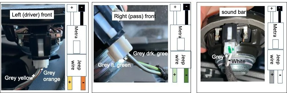

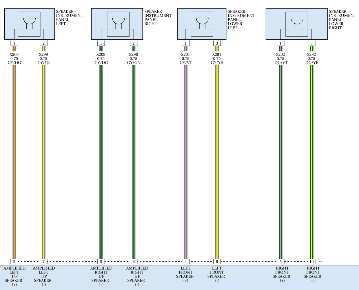

This diagram helped me

This screen shot of the factory wiring diagram has front speakers wired the opposite of your diagram. For the left, orange + and yellow -. For the right, dark green + and green -.

[/QUOTE]
I "borrowed" that image from another member ( @phranican ). Its been a minute, since I did the install.... having a senior moment... ha ha.... Now I will have to go back and take a look at how I have mine wired. Honestly, for this system it probably won't make any difference, but worth a look just for clarity... I will do a polarity test. Thanks for pointing this out.... if I do remember correctly, I used the diagram to help determine if I needed to repin the metra adapters.... just not sure now.
Im actually in the JT now... retracing my steps and things are coming back to me..... "This is in reference to the Left/Drivers side upper dash speaker".
When using a multimeter (not a cell phone app) to check the polarity of the "VEHICLES" speaker wire orientation... the positive is the Grey/Yellow and the negative is the Grey/Orange. ... so this correlates with the diagram I originally posted and does not confer with the one you posted/floating around on the forum.... its easy to do, you might want to go back and test yours if you haven't already done so.

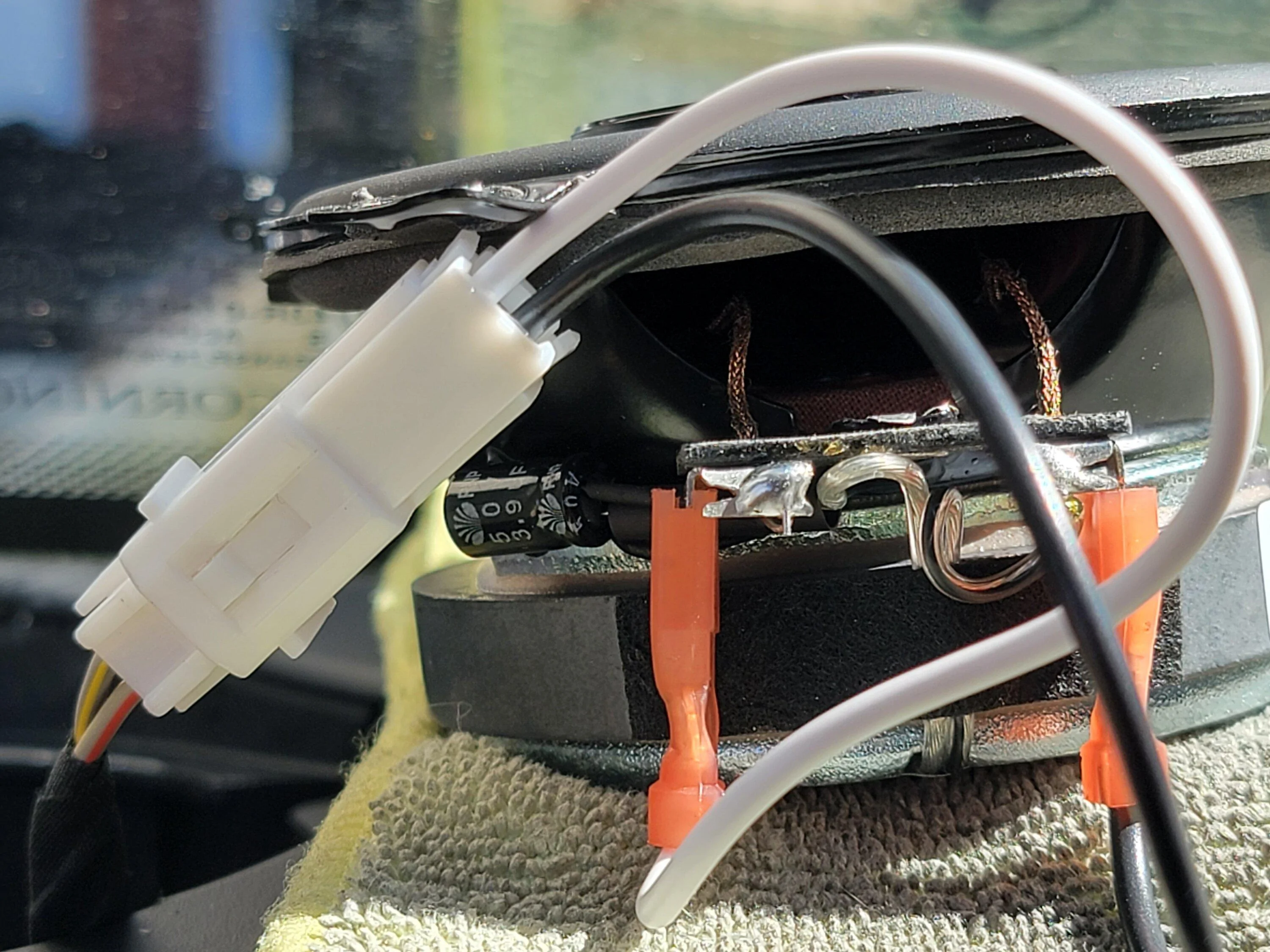

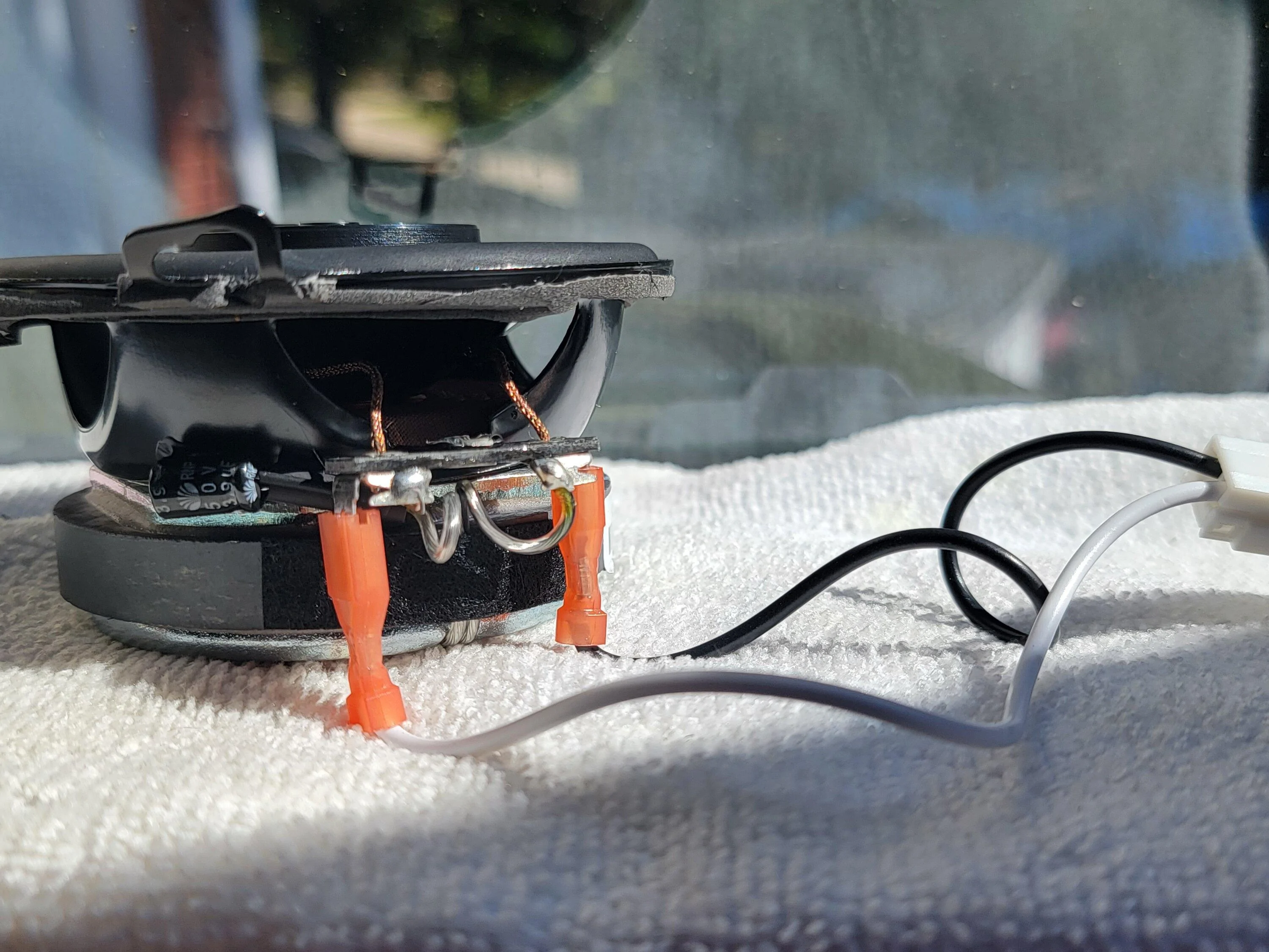

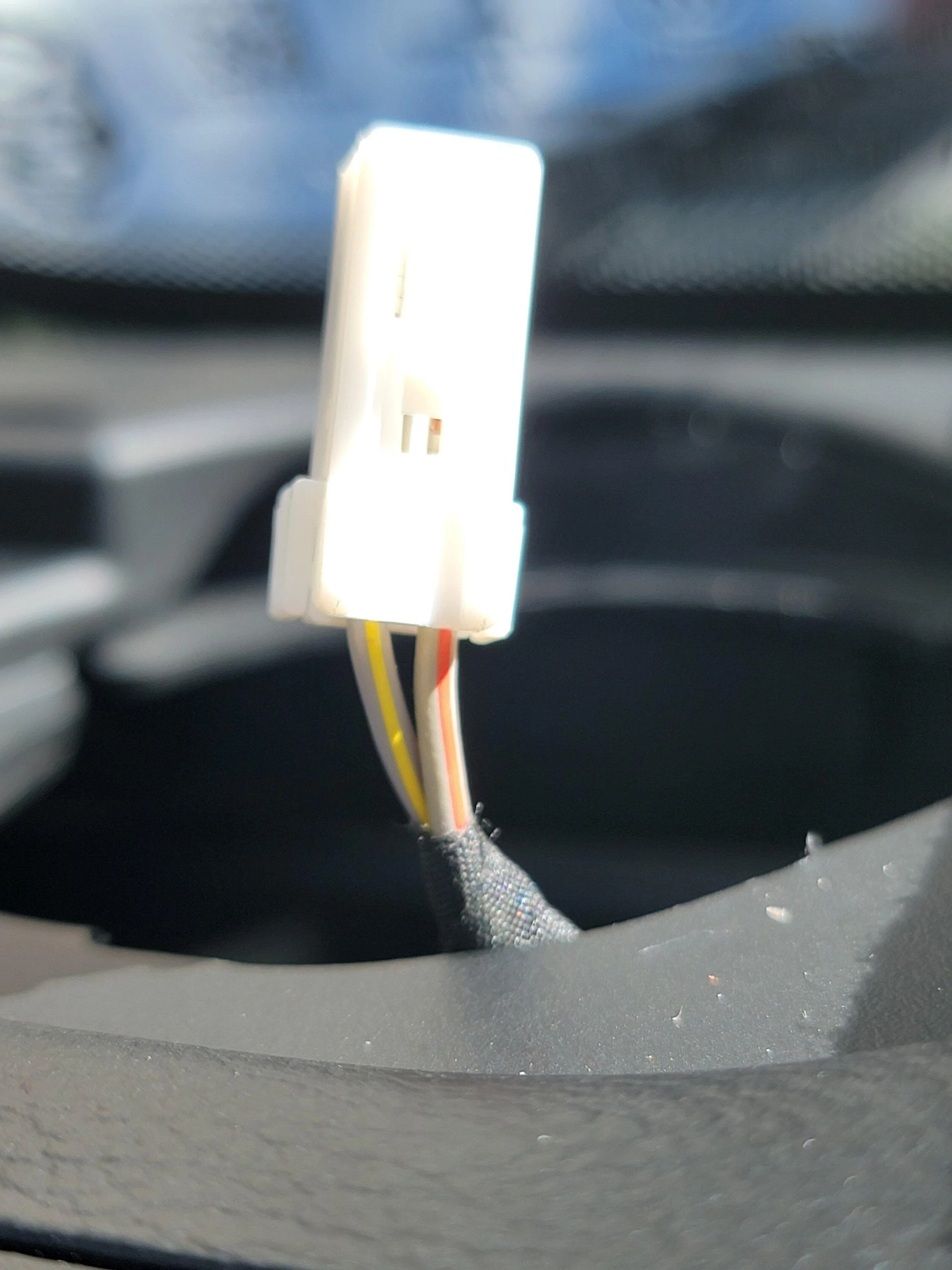

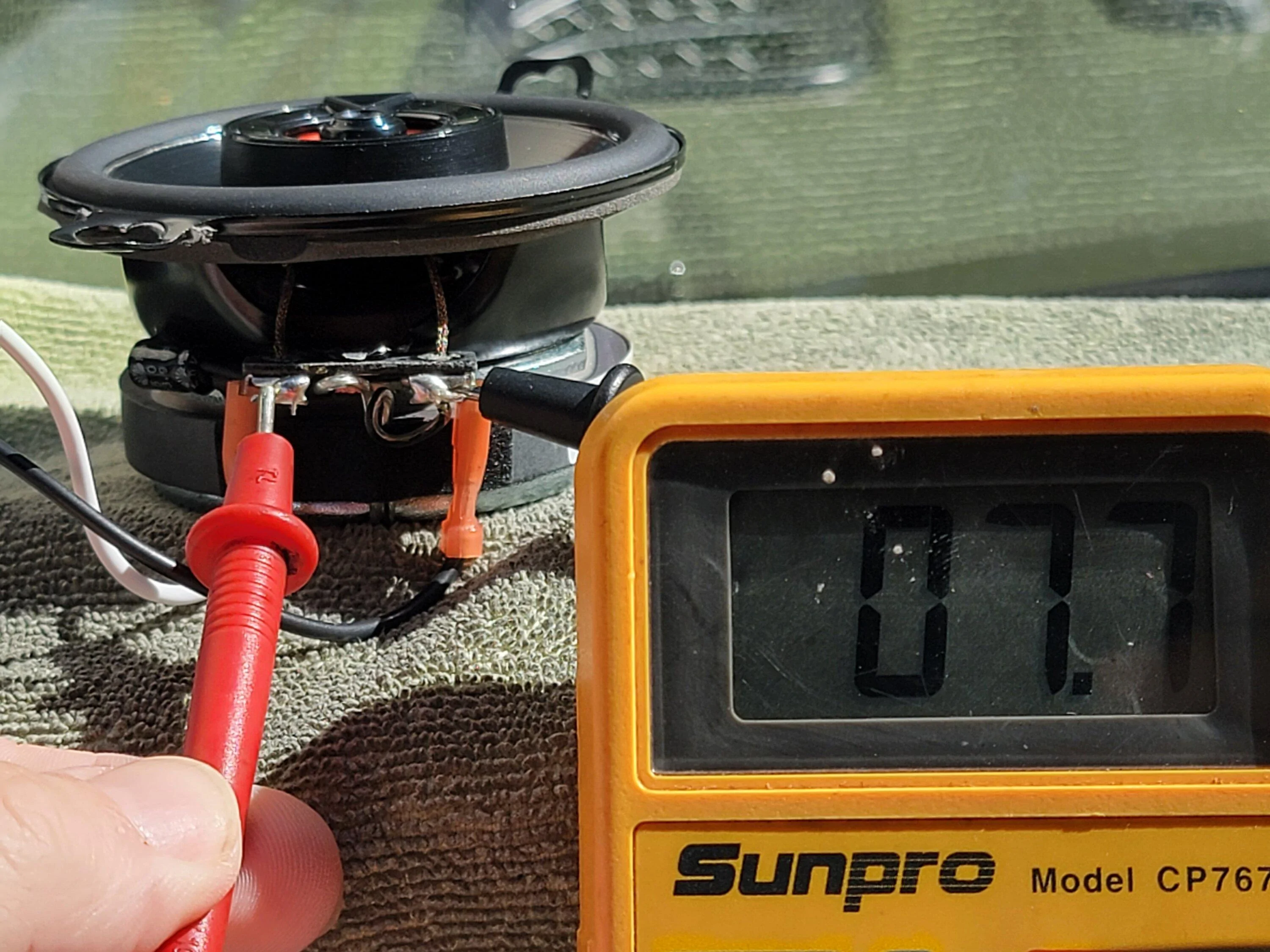

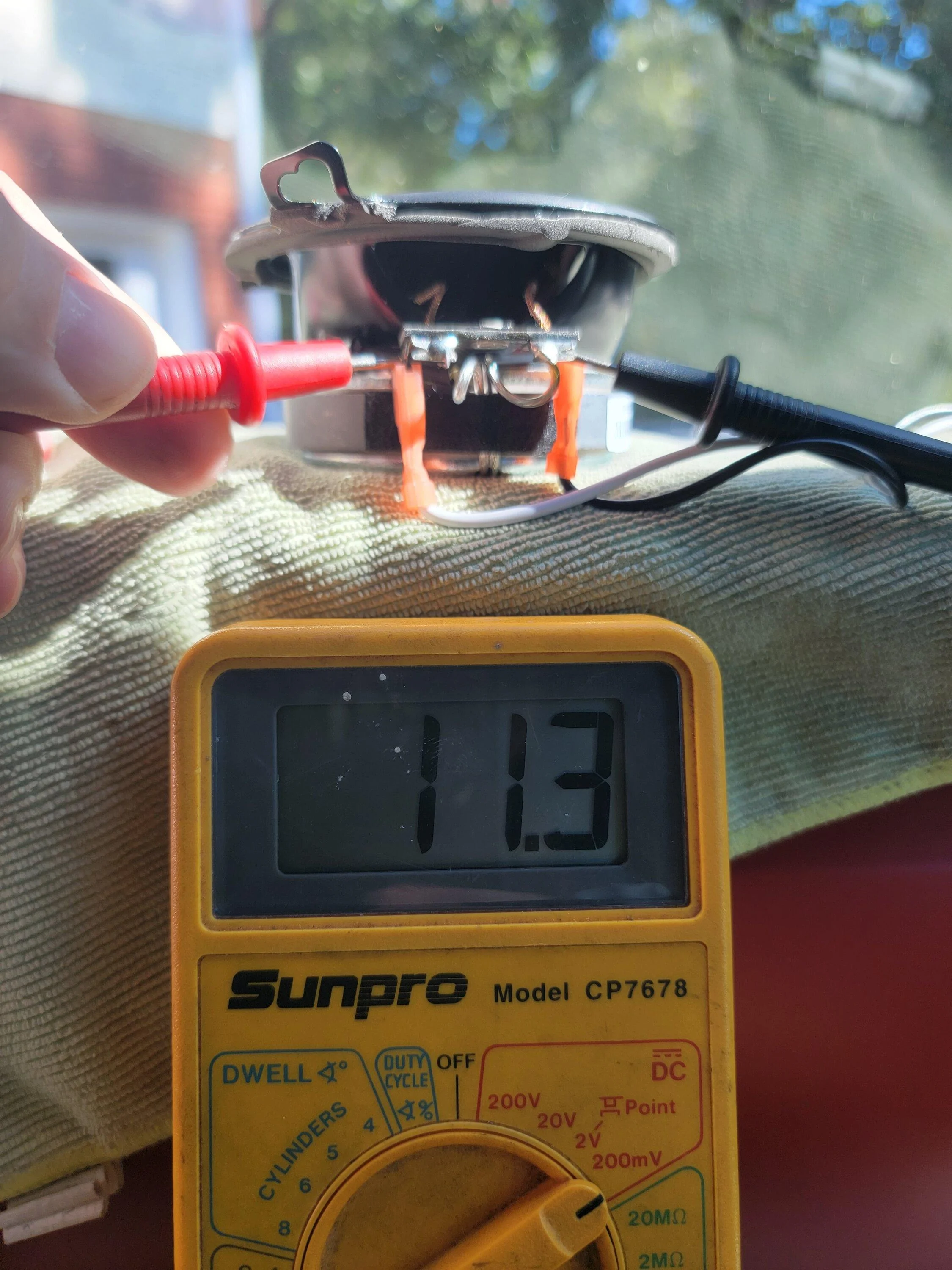

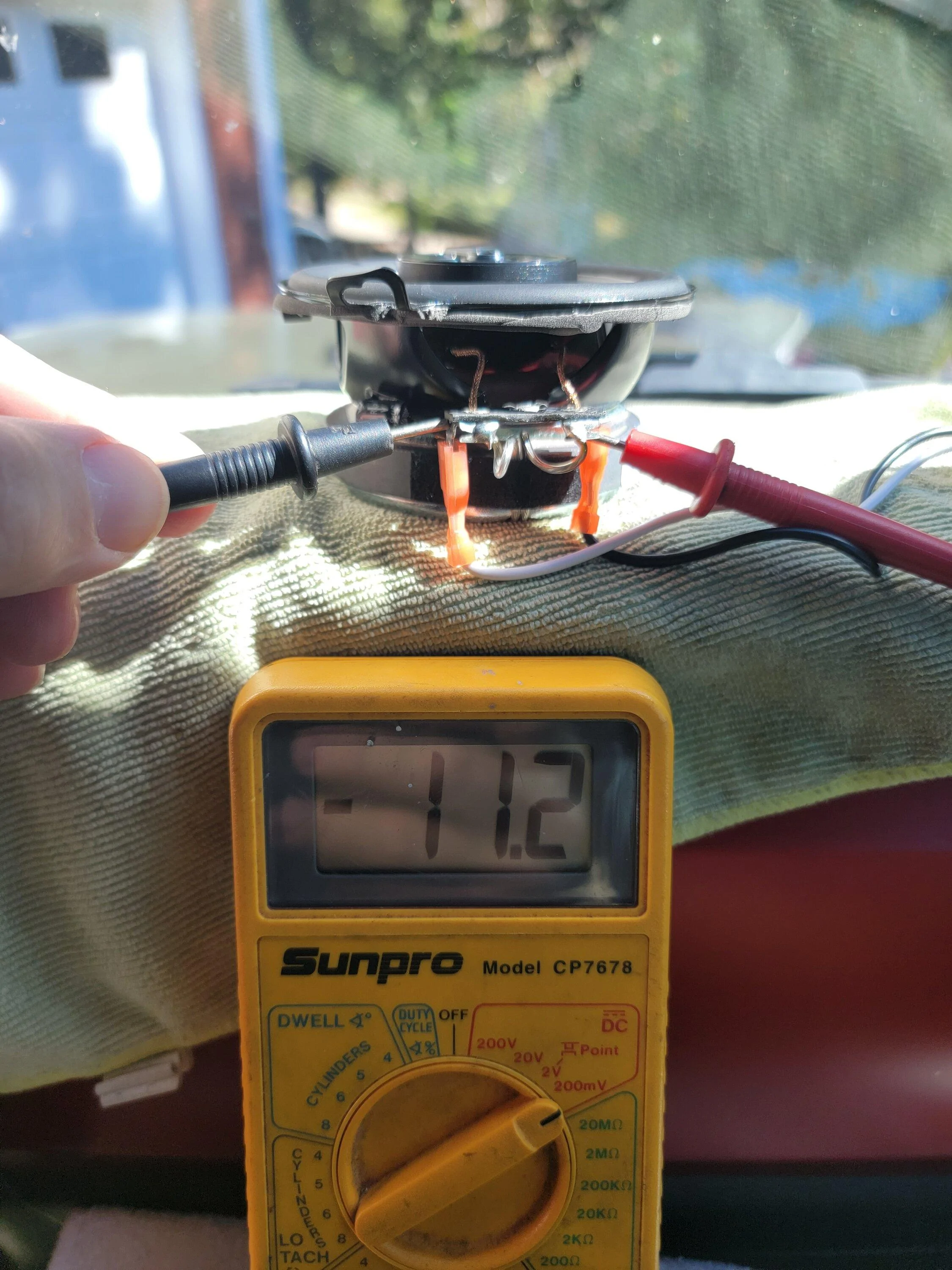

For clarity, I added some pics....
you can clearly see how the orientation of the +/- wires are connected to the factory plug.
You can see I have the white metra adapter wire connected to the positive post of the speaker and to the Grey/Yellow factory speaker wire.
Not so clear due to the glare and the difficulty getting the picture... but clear enough to see when my connections are made, with the positive lead on the postive terminal of the speaker, I get a positive multimeter reading. When switched, you see I get a negative reading.... so unless I have really missed something or made a mistake, MY positive speaker wire from the factory is the Grey/Yellow....
Jeep Gladiator Best 3.5" dash speakers? (direct replacement, no amps, no other speakers) 20221005_135621
Jeep Gladiator Best 3.5" dash speakers? (direct replacement, no amps, no other speakers) 20221005_135713
Jeep Gladiator Best 3.5" dash speakers? (direct replacement, no amps, no other speakers) 20221005_140712
Jeep Gladiator Best 3.5" dash speakers? (direct replacement, no amps, no other speakers) 20221005_141218

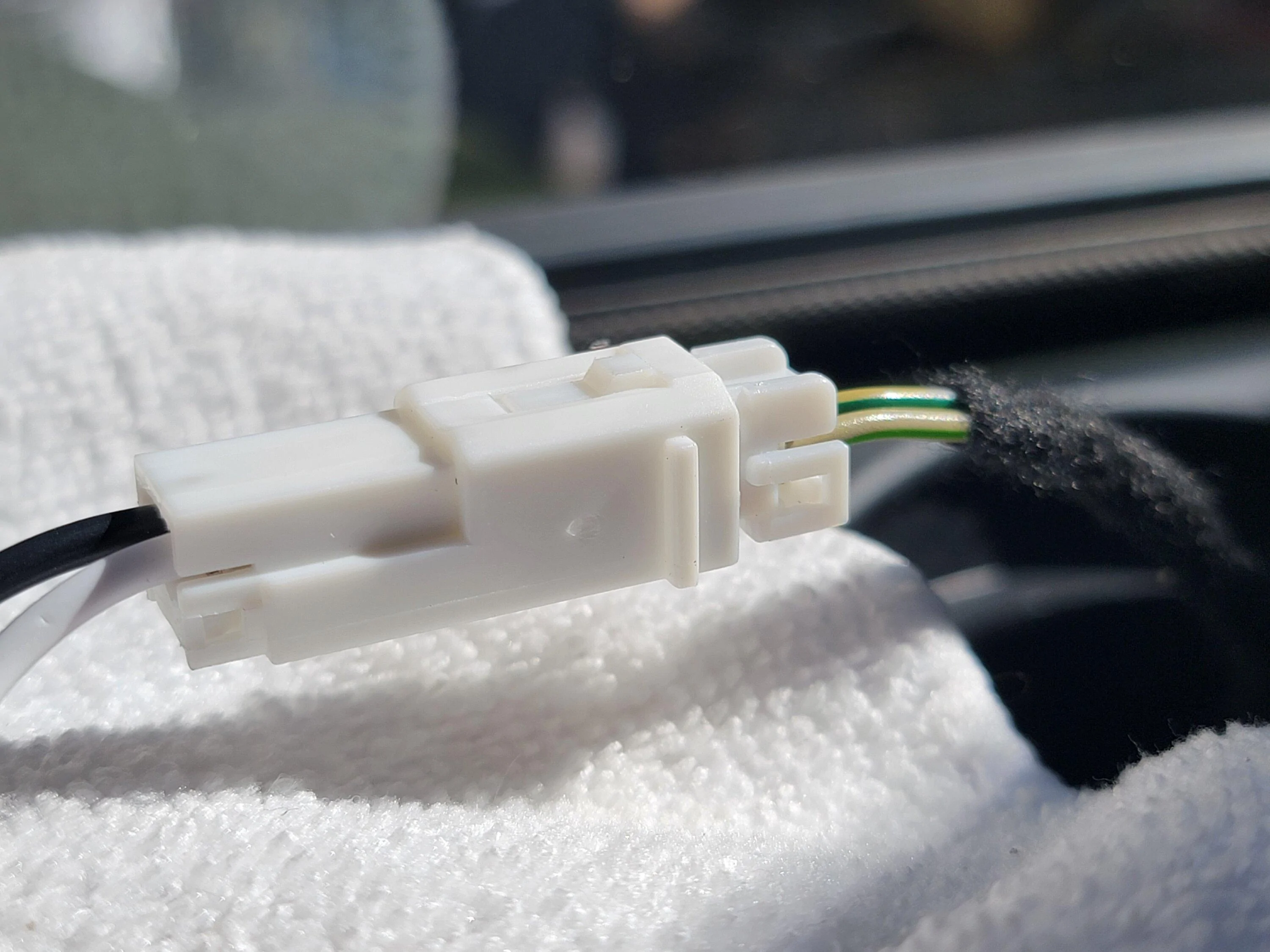

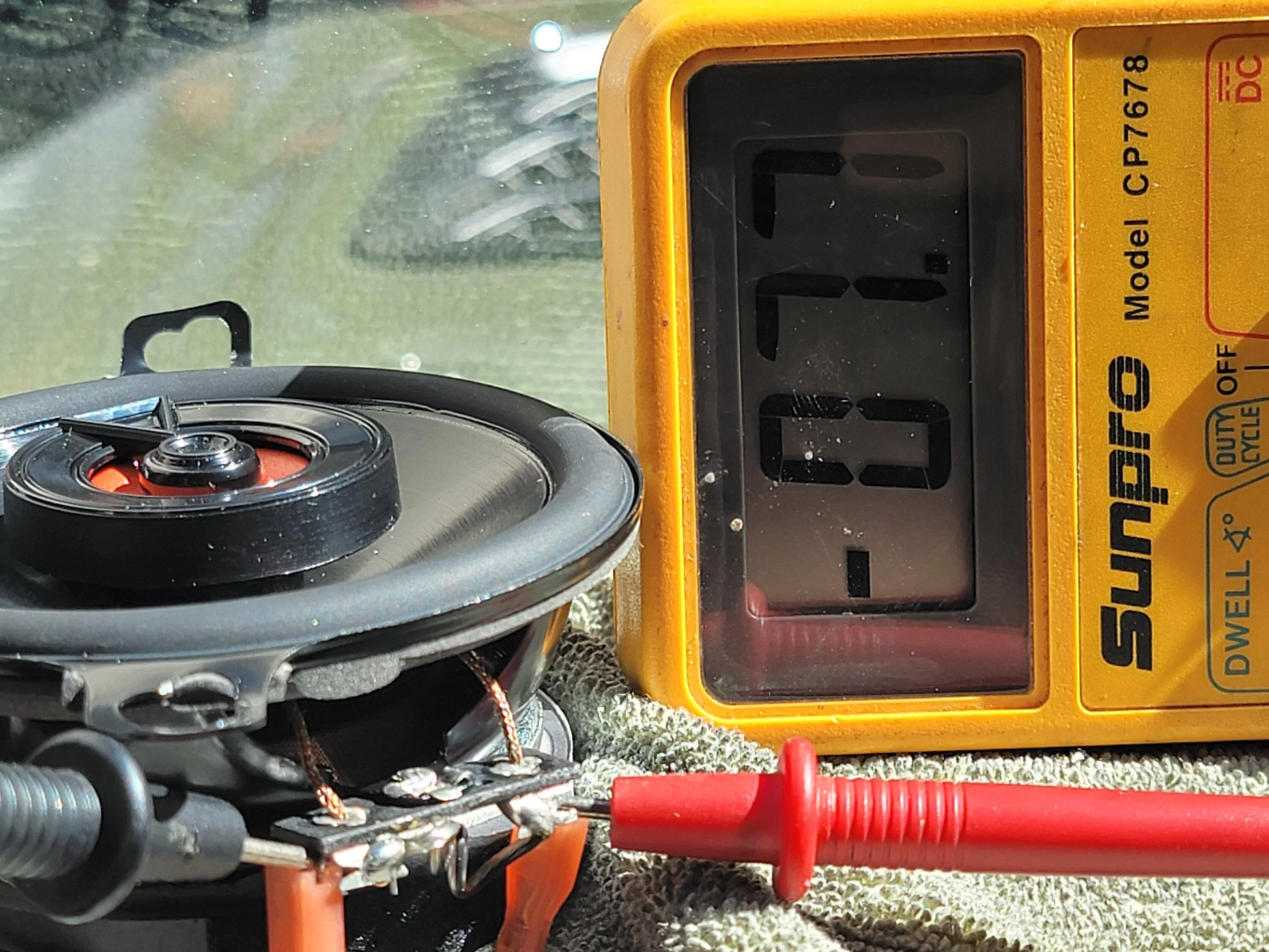

I just double checked the Right/Passenger side of the upper dash speaker and again it correlates to the diagram I originally posted.
Jeep Gladiator Best 3.5" dash speakers? (direct replacement, no amps, no other speakers) wirin
As you can see in the following pictures. My positive speaker wire from the factory is the Grey/Light Green wire and the negative is the Grey/Dark Green wire.
You can see I have the white metra adapter wire connected to the positive post of the speaker and to the Grey/Light Green factory wire. You can see in the pics, once again my connections are showing that they are correct and Do NOT correlate with the diagram floating around on the forum.
Jeep Gladiator Best 3.5" dash speakers? (direct replacement, no amps, no other speakers) 20221005_144755
Jeep Gladiator Best 3.5" dash speakers? (direct replacement, no amps, no other speakers) 20221005_144833
Jeep Gladiator Best 3.5" dash speakers? (direct replacement, no amps, no other speakers) 20221005_144553
Jeep Gladiator Best 3.5" dash speakers? (direct replacement, no amps, no other speakers) 20221005_144610
Let me know what you guys think.. ? Anybody else run into this ?
