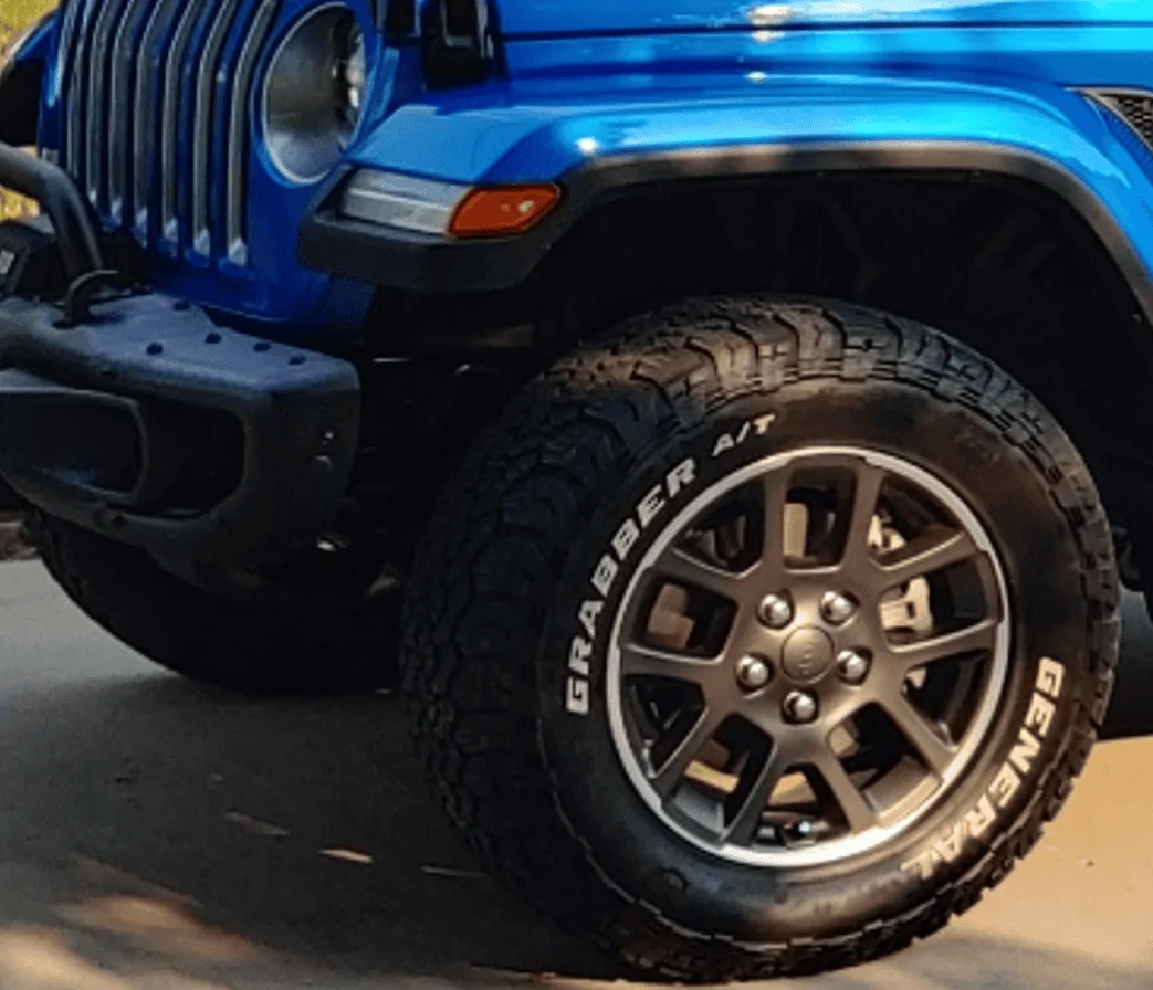

40,442
53,858
After reading dozens of independent reviews, reviews on tire sites, and head-to-head comparisons, I went with General Grabber A/TX
Then last winter, my decision was validated by the fact I have been driving several miles on snowy, hilly, curvy roads with snow and snow pack, and slippery spots and went to shift back into 2 wheel drive and found I had driven all those miles IN 2 wheel drive it did so well.
I've had Falken tires - Rubicon "take-offs" but I find these even better, so I'm comparing both on the same exact truck on Iowa winter roads.
I'm impressed and will buy them again when these wear out. On my truck on our roads, they beat the Falkens in the same circumstances on the same truck with me as the same driver.
(and as my neighbor says about his - they balance easily)
