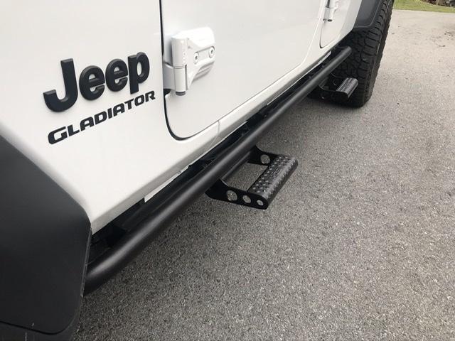

Thanks for your help and the suggestion. So far that's 2 endorsements for ACE and 1 for RockHard.
I used Ace on my jku from the first year I Bought it to last week (7 years later) Used to run blacks and blue trails 3-4 times a year and they held up fantastic. Slight rusting from all the abuse but nothing to be worried about.

I chose Rock Hard angled up and am very happy with them:
*quality, design, welds, powder coat are all excellent
*attaches to all sensible places on the Jeep--4 areas of pinch weld with two spots at each, 4 tub mounts, 3 body mounts.
*0.120" wall tubing, not thin stuff like exhaust pipe that would collapse easily
*reasonable weight with economical design that adds weight only where needed for best performance. Like having another passenger, and not a big one at that!
*protection from door bangers. Shortly after getting my 2017 Recon, some heaved herself out of her car, banging her driver's door TWICE into my rock rail! Taught me that rocks are not the only problem, rock heads too.

I had Ace Engineering sliders on my JKU. When I moved to a JT, I bought a set for it. They work great as steps, sliders, and can be jack points in a pinch. They also fir over the Rubicon rails if you have (or can get) a set; no pinch seam.
My only complaint is the driver side slider on my JT has a little rattle where isn't not fitting exactly right (after torquing to spec). I'm gonna have to pull it off at some point and see if there's a defect on the slider or mount point that needs grinding.

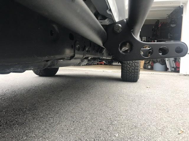

The Rock Hard sliders attach to both the body and the frame. That might be the dumbest thing I've seen today, but the day is young. They are out, and I would recommend that nobody use these for any real wheeling. Well, really, never use them at all.
There's a reason the body is mounted in huge cushion posts on this thing.

The Rock Hard Patriot sliders do not attach to the frame, just the body mounts, tub, and pinch welds.
Here is a video from them on the installation, showing the attachment points clearly:
A 'bash' with no supporting evidence?
A recommendation to avoid a product with no reason?
"There's a reason"?
Please educate rather than bash. If you are willing to share your knowledge, I'm happy to learn. Here's what I know (or at least what I think I know).
The ACE & RockHard sliders both attach using the bolts that secure the body to the frame "body-mount bolts" ... running through the frame to the body. While they are sometimes referenced as 'body bolts', they secure things to the frame. (fyi @whiteglad ... see 7:44 of the video you posted.) The RockHard sliders also attach directly to the body with additional bolts.
While I know there are some form of rubber spacers between the frame & body to limit frame vibrations felt in the cab, they do not allow a great deal of body movement independent of frame movement. If I'm wrong, enlighten me.
Some manufacturers of exo racks for the Wrangler only had their rack mounted to the body, claiming that exterior fixtures shouldn't connect the frame to the body. I get the concept, but I've seen no real life report, lab-style test, or demonstration showing that this is a problem. Other companies making exo racks used attachment points on the frame as well as the body with no known issues. So, I'm not convinced the dual-attachments are problematic.
SwampNut
Carlos
Apr 20, 2020
1,588
1,571
Peoria AZ
2020 Gladiator Launch Edition
Geek
I am. There are options out there for both of us. I've seen flexed-out Jeeps crack a tub, without anything attached to them. I saw it in person, not someone's story. So they clearly do flex a lot. How much worse would it be if you tried to connect a LONG section of frame and body. I think it's really dumb, and only works for mall crawlers.

That is a straight frame mount, and looks solid. It mounts very much like the Ace rails did on my JK. They look solid. I personally don't like the look of their design, but that's just my own preference. I think they are solid and wouldn't hesitate to use them if you like the look.
Also, I want to be clear that there's nothing wrong with mall crawlers, or people who only do light trails, and can use the Rock Hard sliders. If you plan to really flex your Jeep, I think connecting the body and frame is bad.
