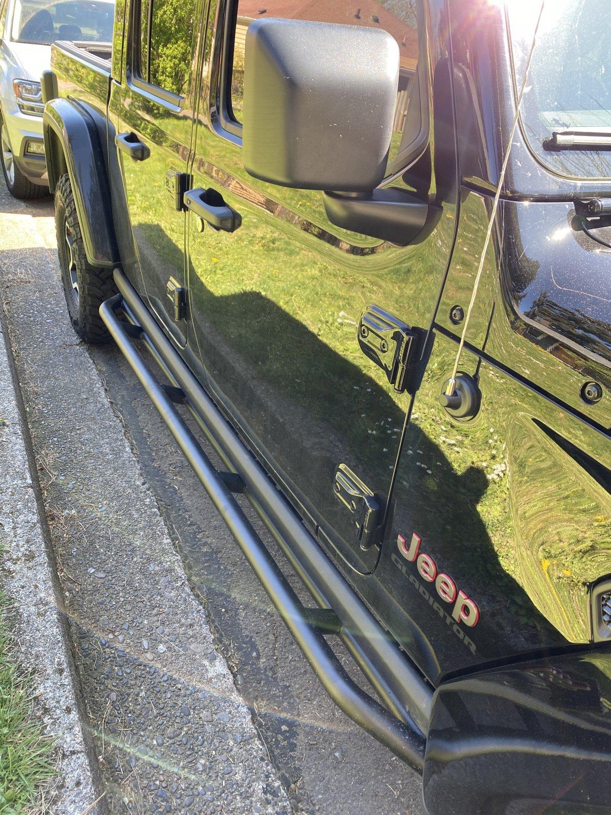

I have the Rock Hard ones, tubes down. Not lite but extremely well built and secured to the vehicle as well as anything I‘ve seen. The step is great but should come with anti-skid on it, I put some 3“ non skid tape on them and I am really pleased with them.
