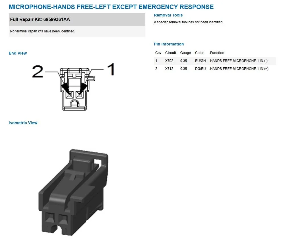

I ordered a pair of the Grand Cherokee mics but the wire color on them is red and black and the Gladiator is black and white what I need to know is how to pair up the wires as they are different colors Thanks for any help

Those colors are going to be the pigtail coming off the microphone. Unfortunately the wiring schematics are only going to show the vehicle wire colors that go to that pigtail connector.
99.9% of the time, two wire microphones will have black (-) and the remaining color being (+).
True of speakers, mics and a lot of other things - black is pretty universally negative and the other color will be positive. Usually safe going black to black.

Thanks for the info
