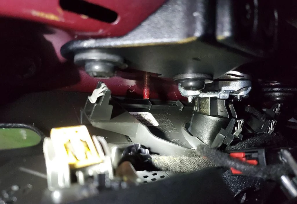

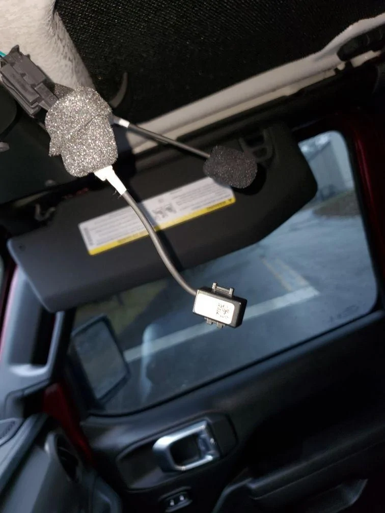

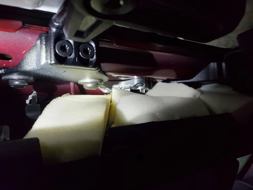

I placed a foam mic cover like the ones used on motorcycle mic's over the mic's then snapped them back in, put a piece of electrical tape over the top so there is no way they are moving then filled the entire void with ultra soft squishy thick memory foam pieces. It's a temporary fix. But does help. Getting the right side mic out is easy the left one is a bit of a pain. You need to remove the plug to the SOS system to get to it. You will get a notice on the dash that there is a problem with the airbag system if the vehicle is running. It goes away once you plug it back in.
Also, just for a test I traveled over the same section of road with the mic's hanging down outside of the over head plastic to see if there was some type of harmonics traveling down the plastics. There was just as much noise at 55mph with the mic's in open air. I talked to the same person on each test. He is having exactly the same problem with the 2020 Jeep Wrangler JL with the same system. We both have a vested interest in getting this figured out.

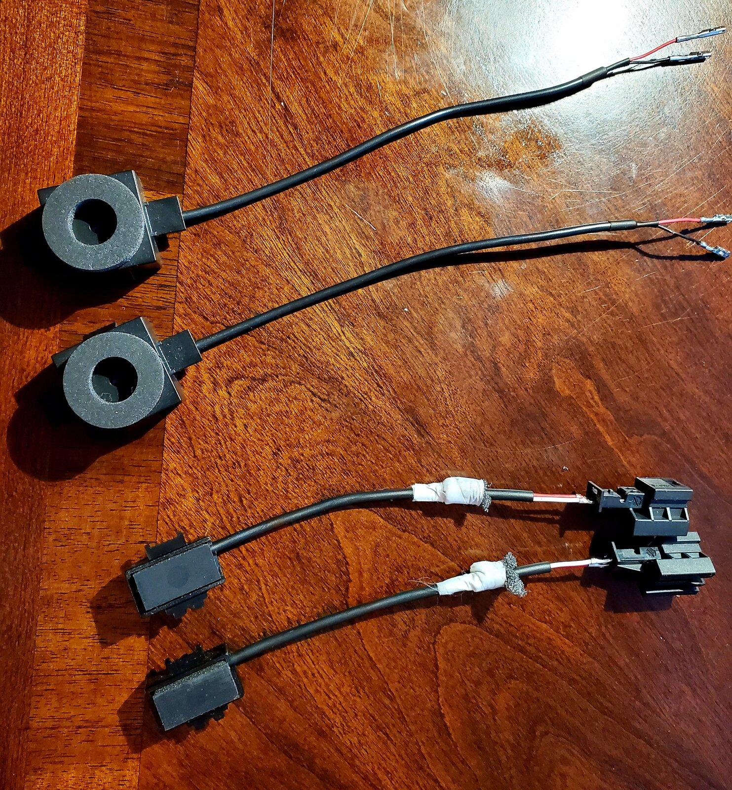

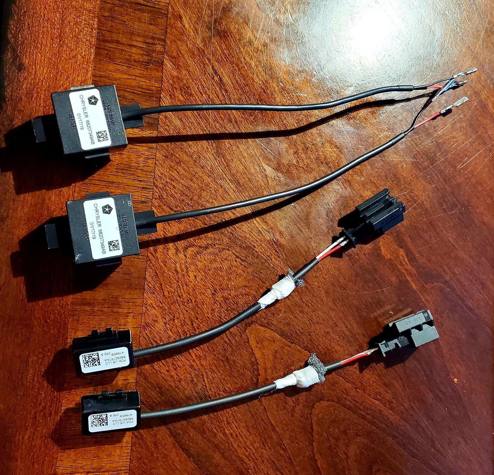

Update. My parts just came in. Gonna try something tomorrow. I am going to put these Jeep Grand Cherokee noise cancelling mics in the Gladiator once I change out the connectors. A friend of mine did this several years ago in a JL. See pics. The small ones are extras I ordered that are exactly what we have in our Gladiators. ?

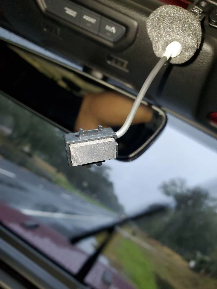

I am happy to report this has worked.
Ok. So that definitely worked. 98% improvement. I called several people at 70 mph and they said I was clear with very very little if any back ground noise. For reference I spoke with people that had iPhone, androids and landlines.

All though you need to retrofit the connectors and use some gorilla tape to re secure since it's bigger in size and doesn't snap in. This is an easy fix.
