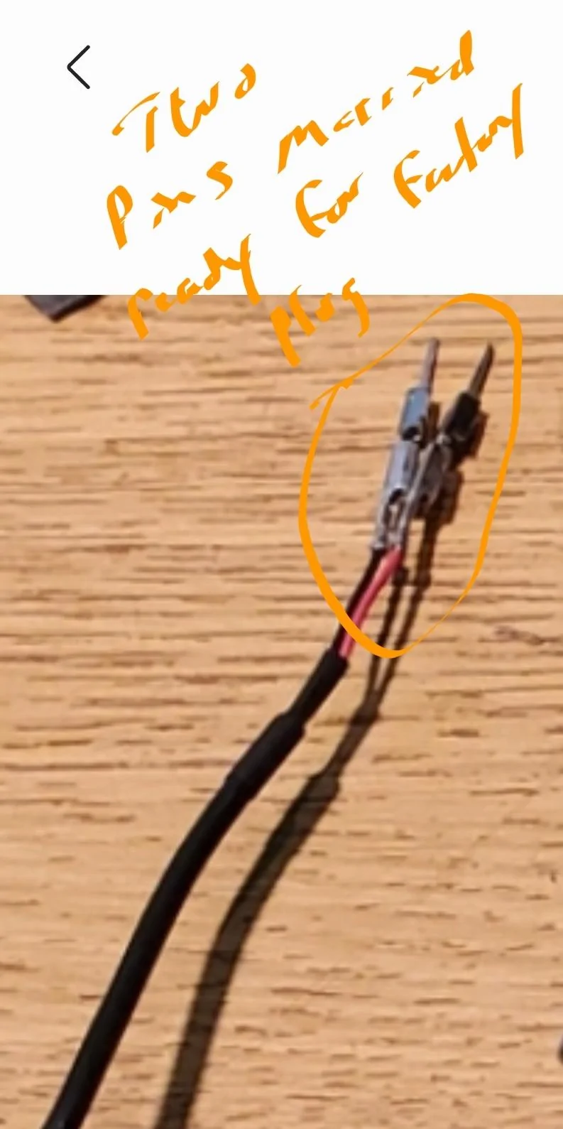

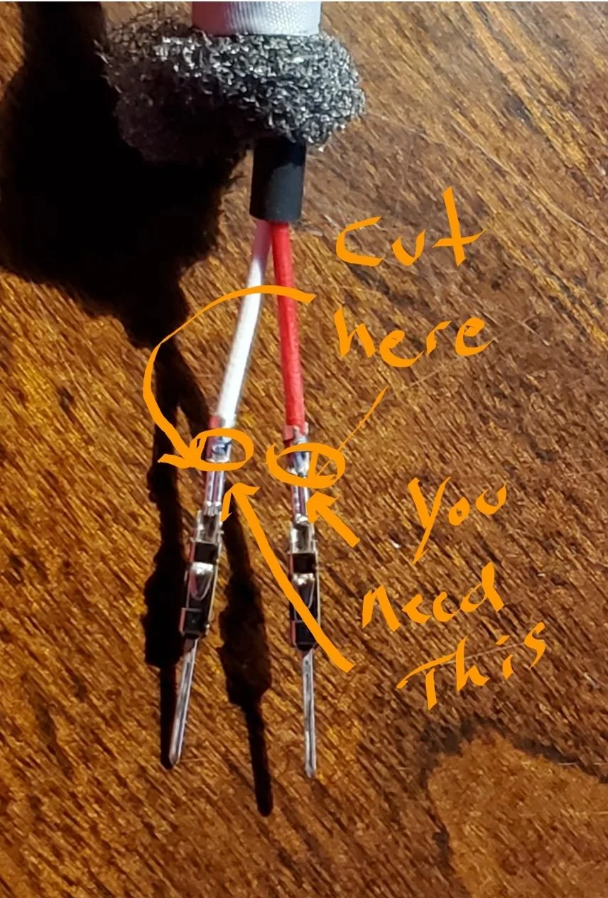

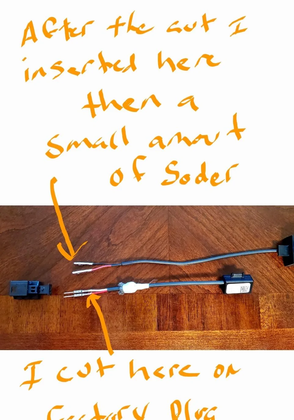

Here are some pictures of how I used the factory plug and married the two pins. This way there is no splicing of any wires. As you look at the pictures you will see how we cut the factory pins at the crimp. Then we used a small file to take the burs off from the cut. We pushed the factory pin cut off side into the end of the female side of the replacement mic. At the junction put a (little) soder. Once done look at the picture of the factory connector.

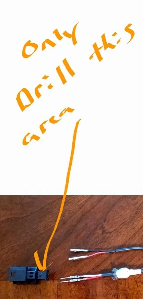

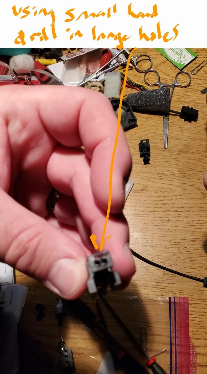

We drilled by hand the outer part of the holes so the soder part would push in. (NO power tools) you will notice the pins won't push far enough in to the connector if you don't do this step. DO NOT DRILL ANY THING BUT THE OUTER PART OF THE HOLES. THE PINS LOCK IN THE HOLES YOU RELEASED THEM FROM EARLIER>
Be Gentle. Once the pins are seated your done. Put them in the Gladiator.
