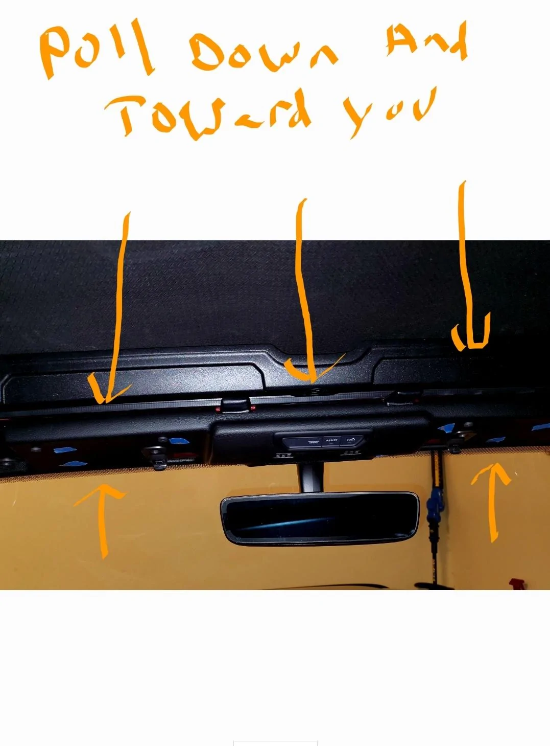

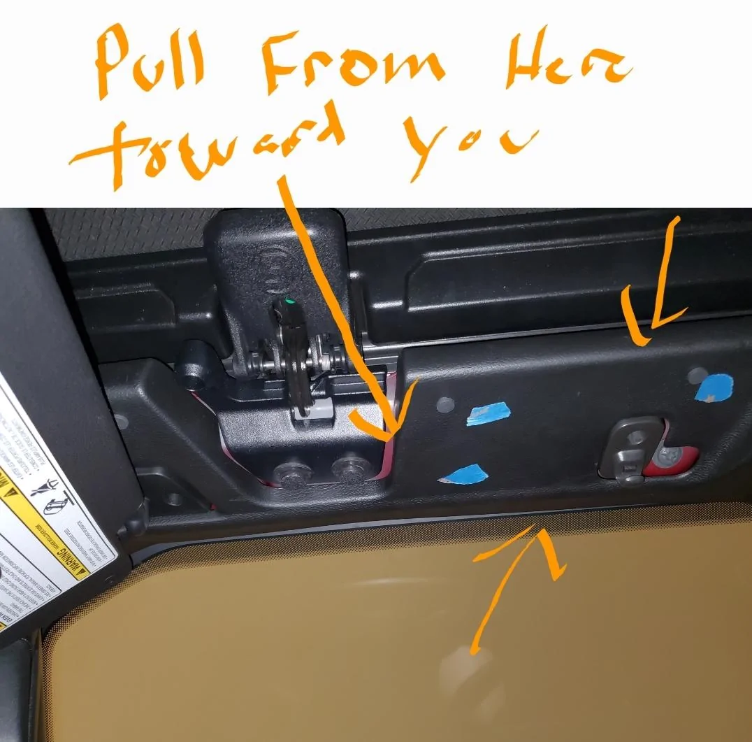

Any special tips on accessing the microphones / trim panel? I really hat breaking little fasteners and hearing rattles after I work on something.
Yes. The plastic pulls down pretty easily. I only pulled down the area between the visor tabs. I did not remove the entire piece. I will post pics with tape marking each area where a clip is. Give me a few minutes
I did not use any trim tools. The blue tape is where the clips are.

. Pull down and towards you. Work from the outer edge towards the mics.

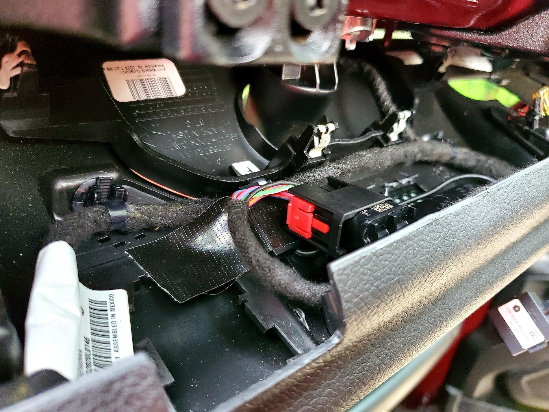

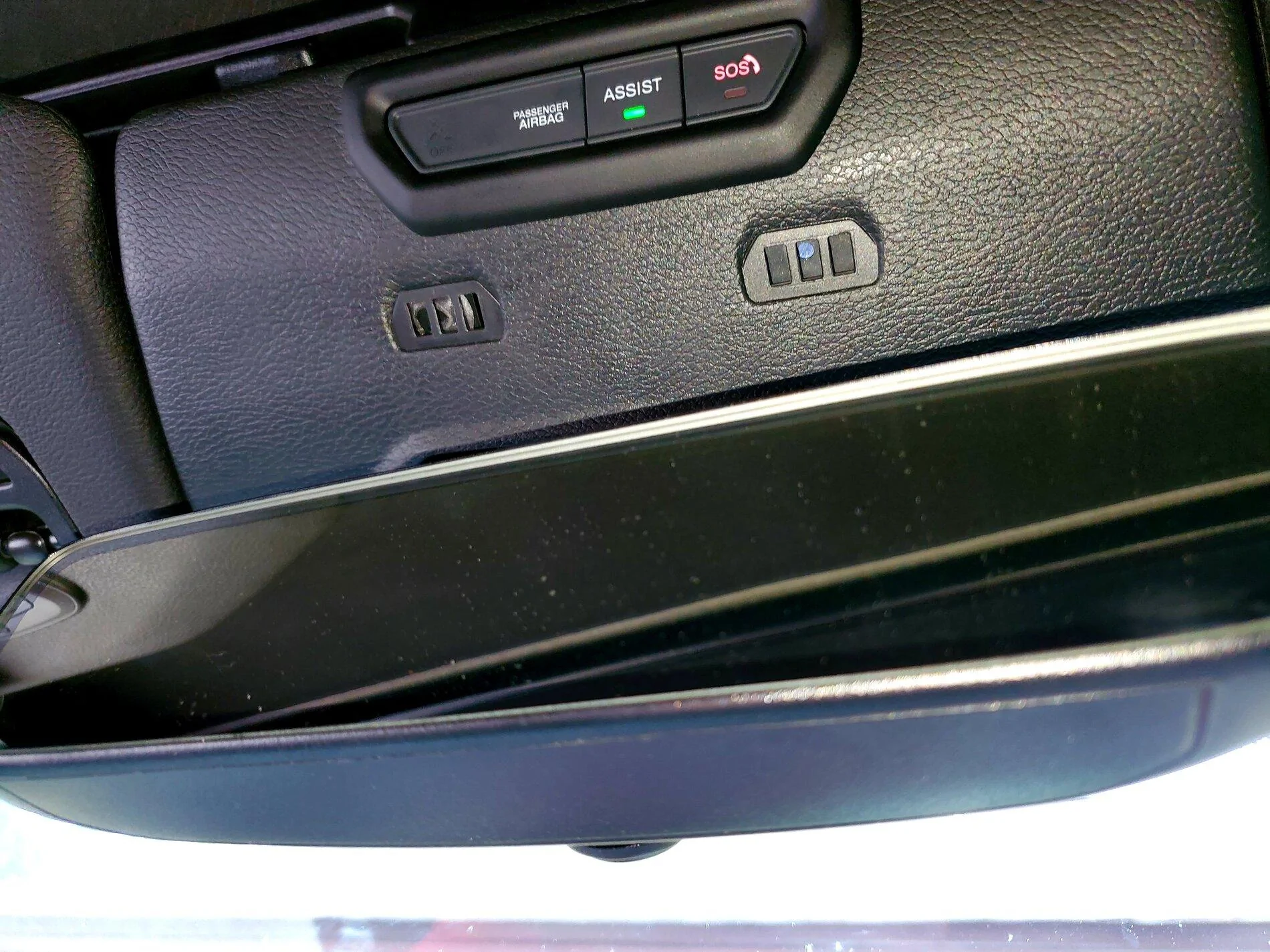

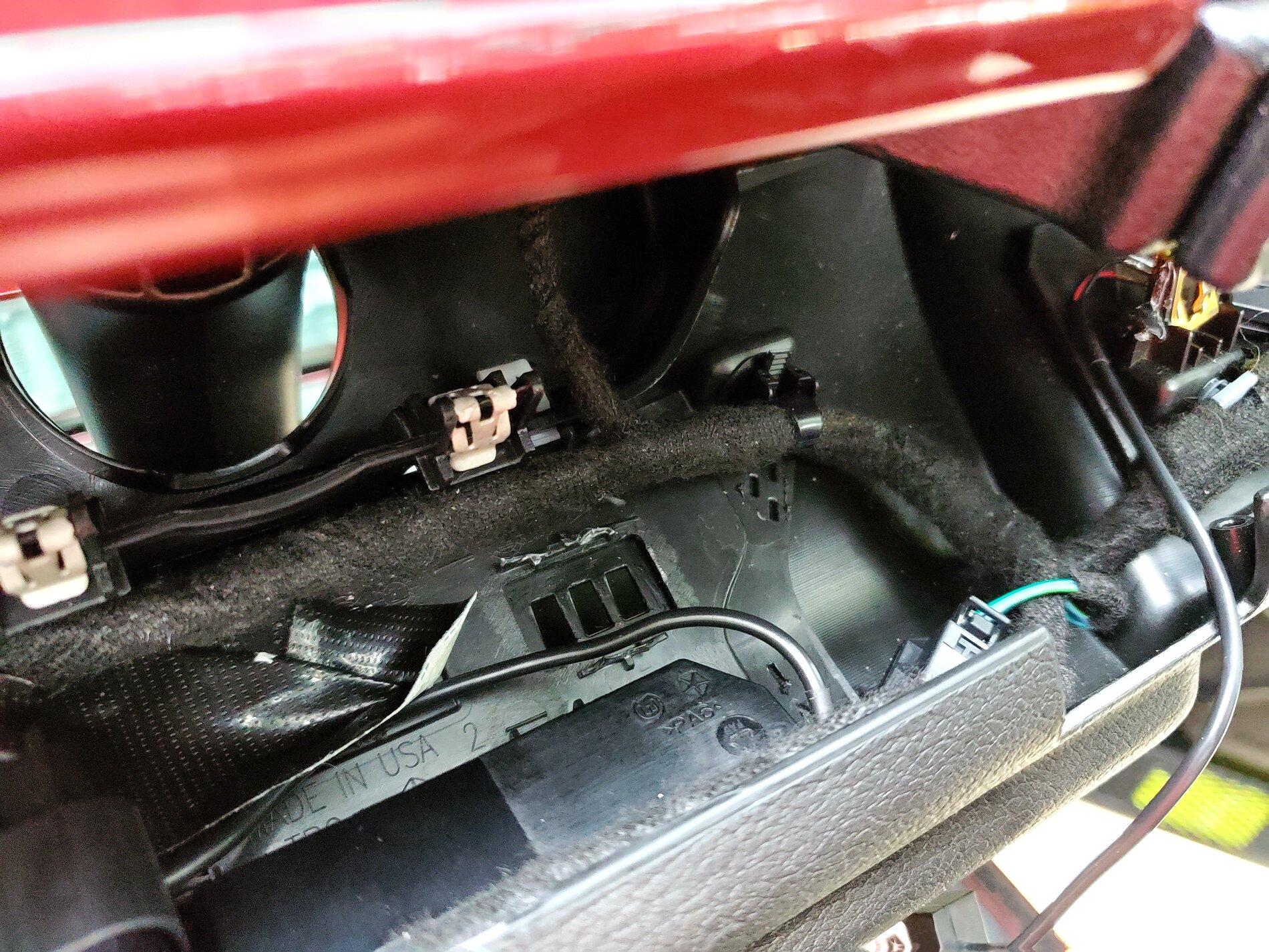

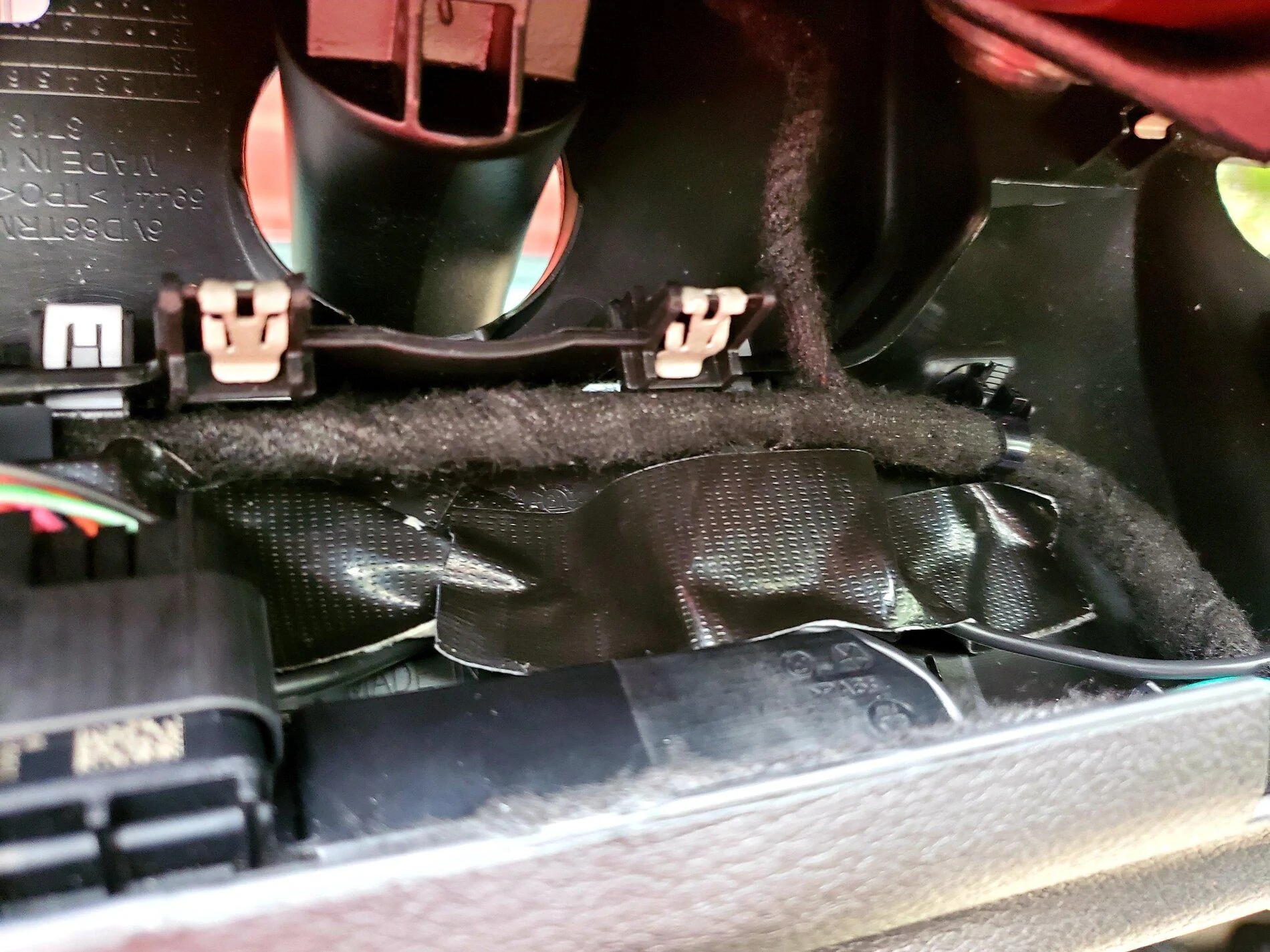

Here are a few pics of the other side of the plastic. Along with new mics installed. Last picture shows the mics. Driver side I left the little piece of foam on. The passenger side I pulled the foam off to get it to sit flush.
