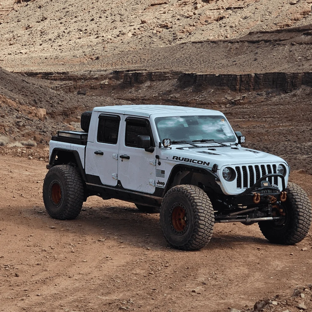

True, I'd agree with that. The front is just as important if not more so than the rear in tire size conversations. I was just pointing out that factory rear fenders wouldn't give you that clearance that the Motobilt does.
Yep and I bet you could make a case for a sectioned/chopped OEM bed, with that Artec high line bumper you mentioned to have a pretty darn good departure angle.
Yep, someone described Jeeps as 'Legos for adults' and I like that idea, build what looks good to you and what you like. It makes it fun to see them all.
That was my excuse for the last year, but then I realized I wasn't using it often any more, so I chopped it off.
Same, Same.
Besides the 18”s of extra clearance which is more than anything else available after market or the clearance for 43” tires, or the armor all the way around . Do not forget about the TAIL LIGHTS! Hahaha no more busted plastic! :) And super bright back up Cube light too!

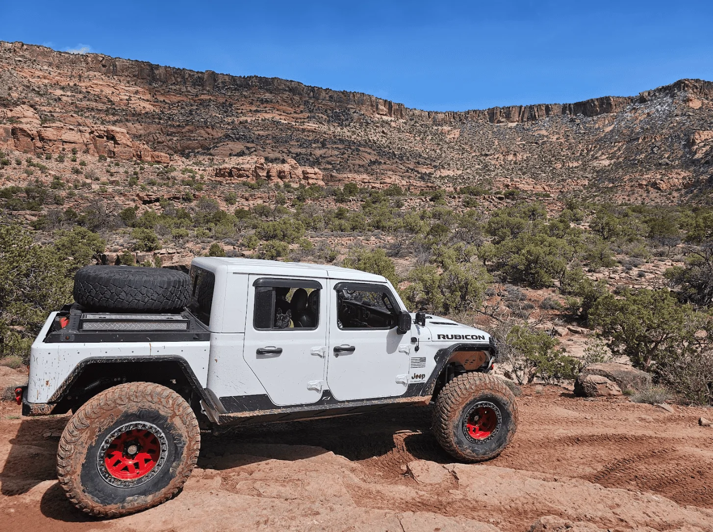

You missed one! HAHA! I saw some of you guys on the trails... I really wish I could have wheeled with you guys when we were out there! Maybe next year!
Nice! Maybe next time!

For off road wheelin that sire looks like those bobtailed Gladiators would be fun. Wished I had 2 of em I would Bob one..I just can't part with the bed in full version. Gotta have some place to rest when I'm out solo camping . Throw the old truck tent in and crawl in .

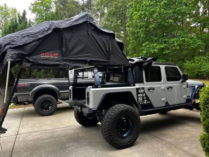

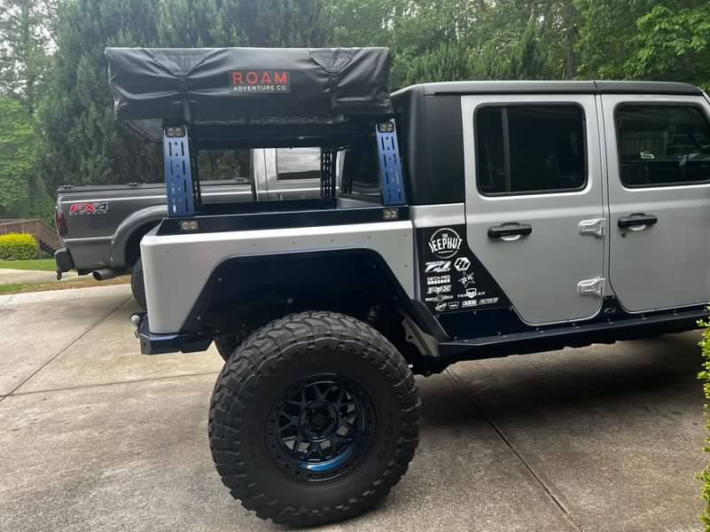

This is a buddy’s bobbed gladiator that I used to work with who has the best of both worlds!
That's a nice rig for sure. That or a standard ground tent or tent cot.

At what point is it better off to do this than build a JLU/JKU? Just want that longer wheelbase?
RockJeep98
RockJeep98
Bobby
Oct 4, 2022
85
207
Dothan
2022 Jeep Gladiator Rubicon
Technical Support Manager
Longer wheel base, larger towing capacity, (yes there is a hitch option for towing as well!) you still have a truck bed to throw your muddy tools, boots, recovery gear, and countless other items. You can mount a 43” tire on the tire carrier and still have room in the bed. The bed also gives a better departure angle then the JLU does with this setup. It also allows for 43” tires to clear in the back fender well as well. You also are converting not only the bed but the rear bumper and fenders which are all 3/16” thick Armor as well! Available in both steel or Aluminum.
Also the tail lights are recessed into the back corner and completey protected along with the optional rear back up light mount as well. You can also sell your factory bed to help recoup some of the cost too.
