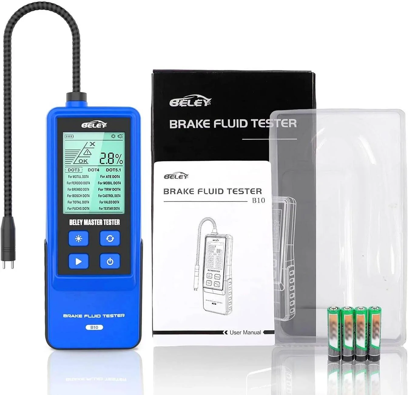

Try the tester in a fresh bottle of brake fluid.
Which tester you have?
I'm using this one.
Jeep Gladiator Brake fluid test bad after changing/bleeding system 1759100040546-6y
40,501
54,022
Brake fluid should always be fresh. Not sure how the dealers stock it, but if you buy a bottle and use only half of it, and then put it on the shelf for a year - toss it and buy new.
I'm using this one.
What he said.
Testers can go out of calibration and cheaper ones more than others.
When he says fresh, he means not one you've had on the shelf for months after opening it.

Do not know the name.Bought a cheap one from O Reilly Brothers. Like your idea will buy a new bottle of break fluid to test devise.

They may have used DOT 4 which will show high on the testers if calibrated for DOT 3.
I still would not rule out the other suggestions of it not either being done or used old fluid from open containers.
