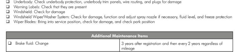

Better check with Toyota, Honda, VW and others - first flush at 3 years, subsequent at 2 year intervals. Honda even has a dash reminder that follows that exact schedule.
Drum brakes were more frequent - the 2 years is a newer thing.
You can find it in their manuals - yes, current, new vehicles since 2020.

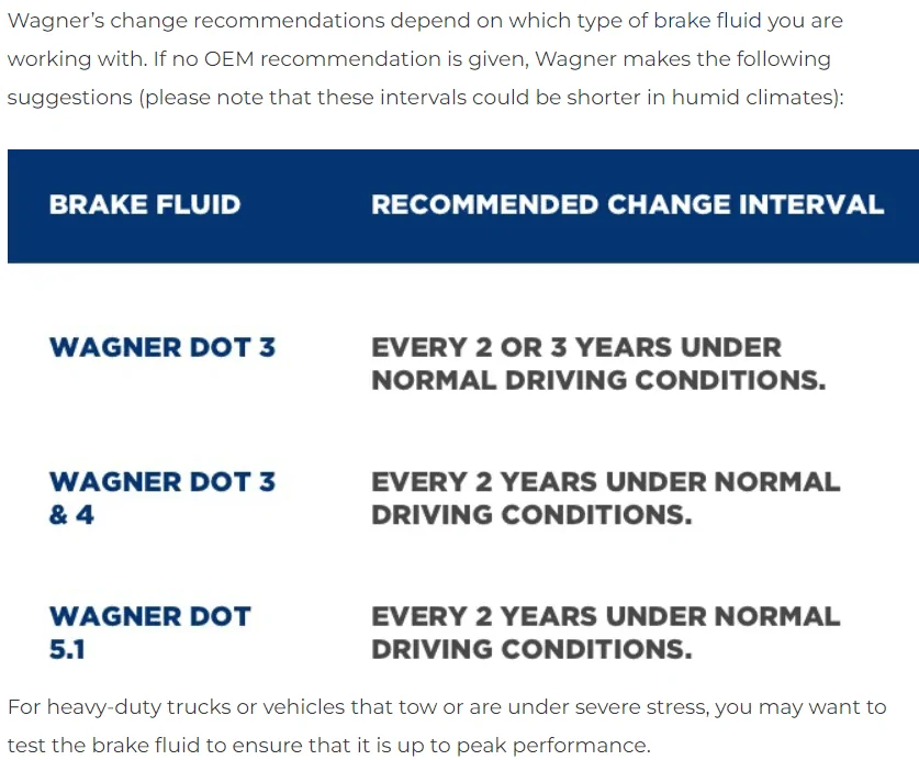

And this for Silverado models up to about 2019 straight from the Chevrolet owner manual -
Jeep Gladiator Flushing Brake Fluid 1711060911084-c7
Jeep Gladiator Flushing Brake Fluid 1711060739710-ta
The current for GM may be longer.
No, it's not an old drum brake thing. Brake fluid loses it's ability to resist corrosion, hold viscosity and other factors just like your ATF or engine oil or coolant. It loses attributes with age and heat. It's not just "it absorbs water".

If you tow or live in mountain areas - this will vary:
