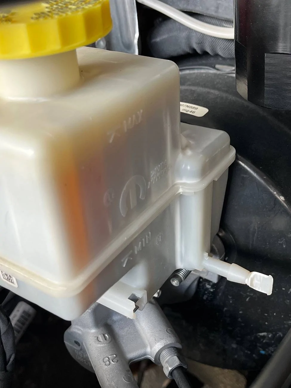

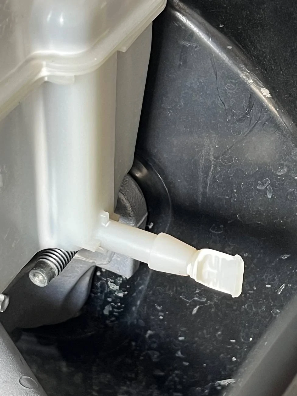

So, I’m going to be doing a flush in the spring or summer and I earlier asked how to get the screen out of the fill bottle to use a turkey baster to suck out debris in the bottle so it isn’t flushed through the lines and I realized that a turkey baster wouldn’t even reach all the nasty parts in that bottle ….then I saw this barbed end come out the bottom of the bottle. Is this where a hose line could be put on and the bottle flushed out?

Need to leave that barbed end alone. Will create more problems if you break off that pinch seal.

The barbed outlet needs to be left closed off. It is an outlet for fluid feed to a clutch master cylinder in manual transmission applications. There really isn't a good way to seal it once it is opened. I remove the screen by using a pocket screwdriver and working around the edge. It takes patience, but it will come out.

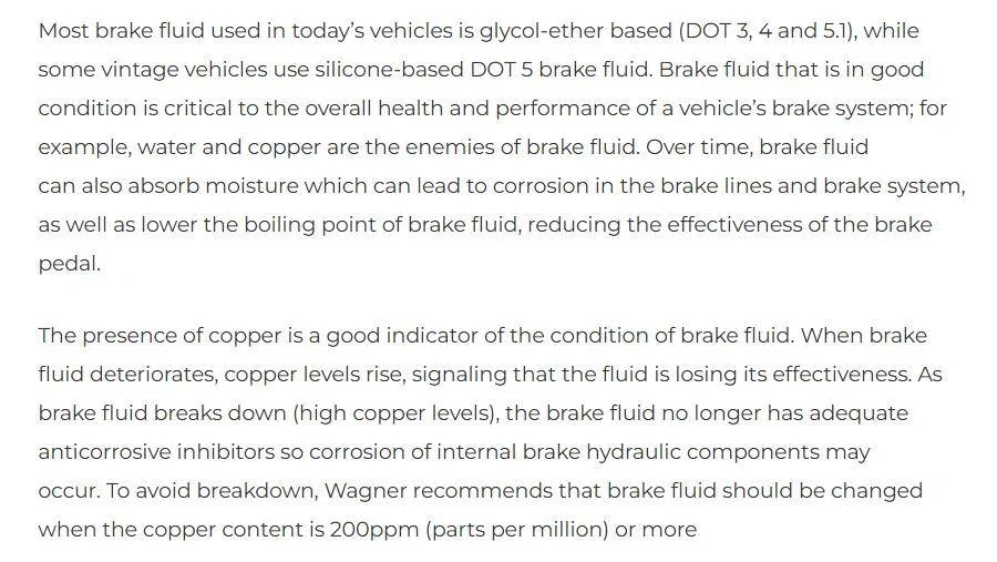

Heat and time are the problems. Time allows for absorbing moisture from the air, acids to form, and breakdown of the additives that prevent same, heat ruins fluid as well.
I go by what the people who engineer and manufacture the brake parts say - not the car's book.
