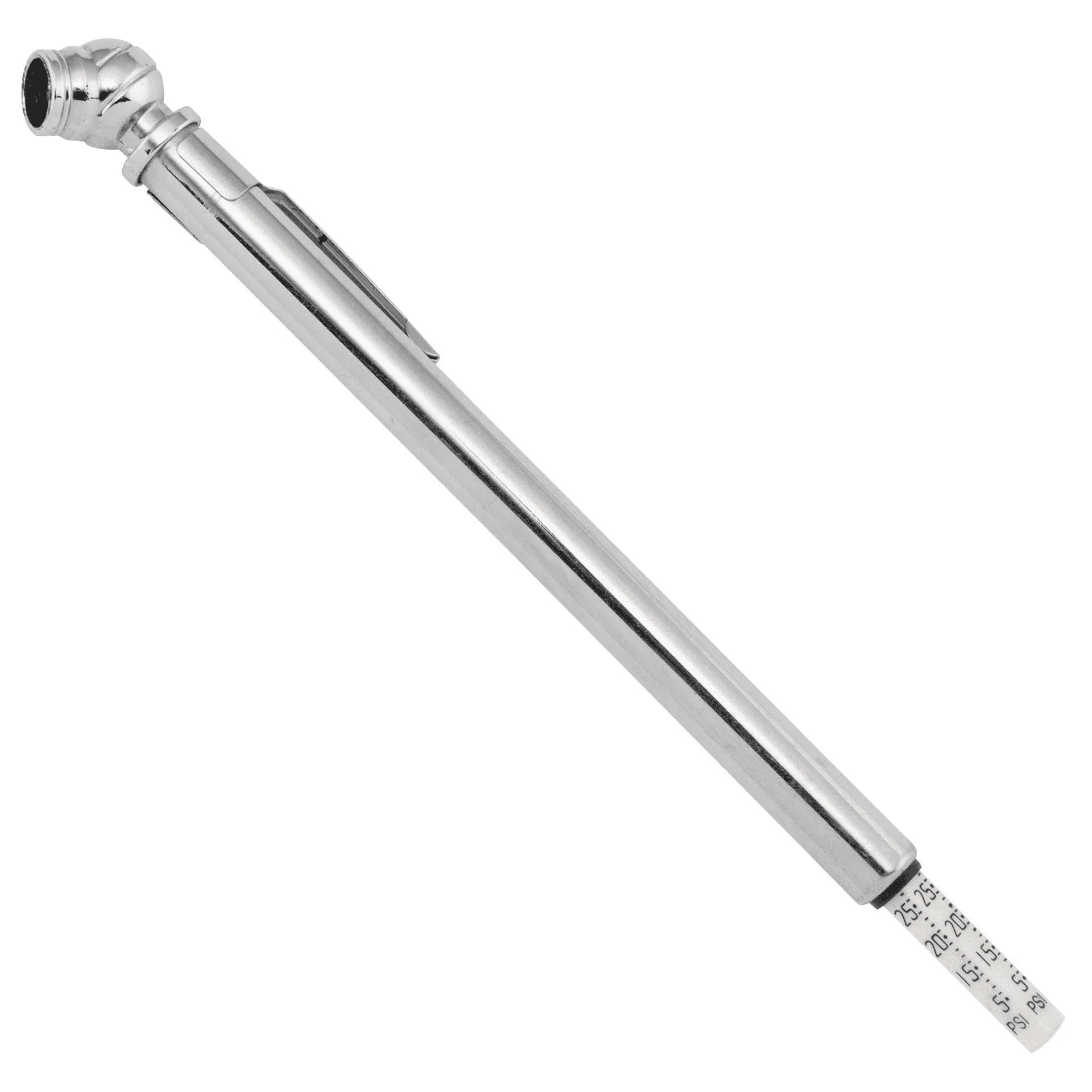

Now is not the time to jump to conclusions.
Could you check the tire pressures please and post the results here?
Thank you!

36 psi on three 37 on the fourth
