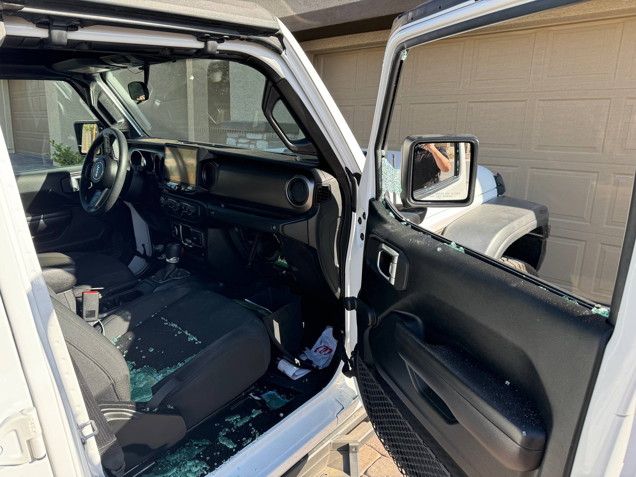

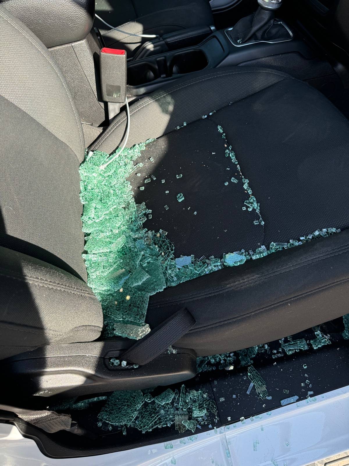

Hey everyone.
Yesterday at some time my gladiator sport was broken into and the glass was smashed and the glovebox dismantled. (See pictures below) the glovebox wasn’t ripped out but the side arm taken off and everything. They took absolutely nothing including the petty cash in the center console.
I don’t keep anything in there outside my Heigh10. Which shows no signs of tampering.
Now the main issue:
When I go to start the car, it keeps saying use the fob to start. Keep trying and tried the second key and still nothing. Replaced the fob batteries and not working.
Could they have reprogrammed my keys? My fob has no buttons on it like unlock as the truck is all manual.
Thanks for reading and hopefully I can figure this out.
Jeep Gladiator Break in and now Jeep doesn’t recognize fob IMG_3600
Jeep Gladiator Break in and now Jeep doesn’t recognize fob IMG_3601

Have insurance evaluate and fix… typically they program new fobs to the vehicle using the canbus access behind the glovebox.

If pushing the start button with the end of the FOB doesn't work, it will have to go to the dealer to be repaired as part of the insurance claim.
They probably broke in and started reprogramming it before realizing it was all manual and something that wouldn't be easy to move.

Sounds like they attempted to code new fobs and "nulled" your current fobs out
