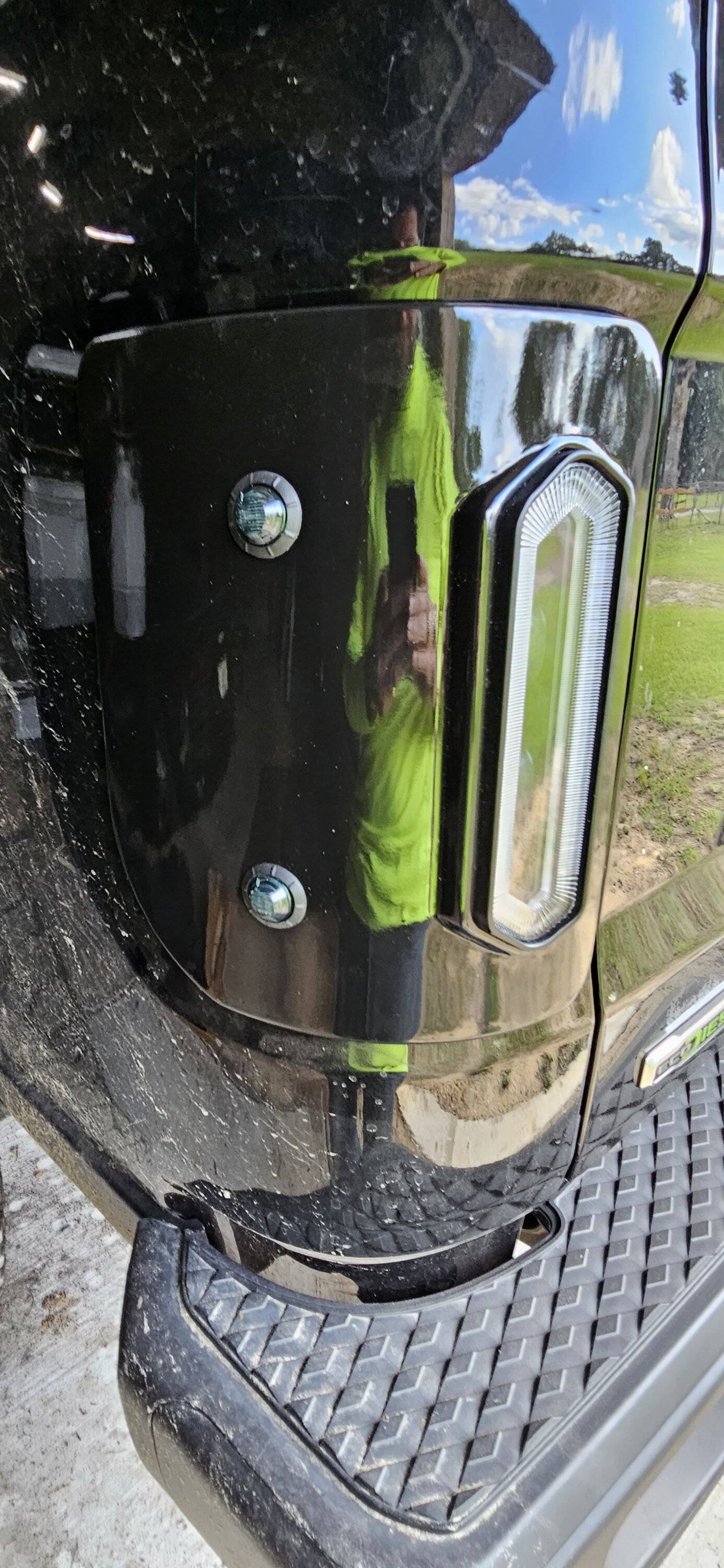

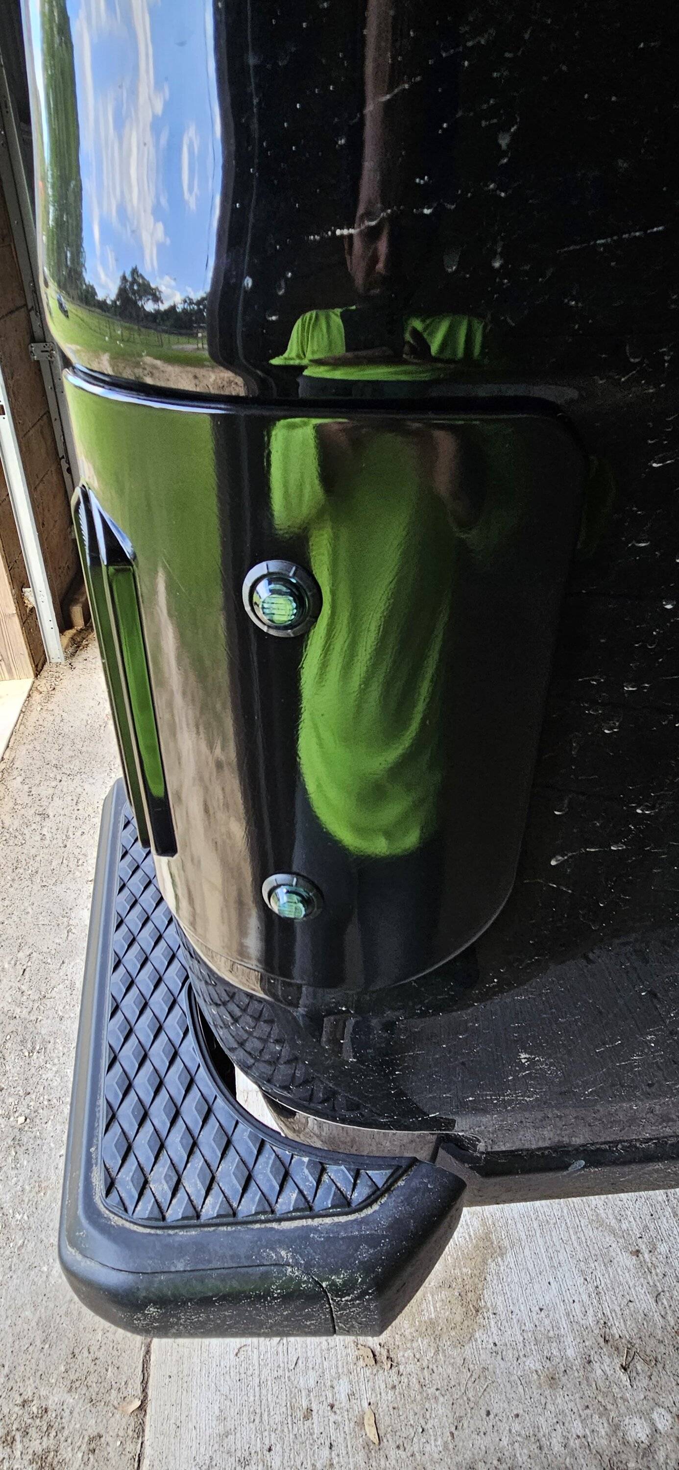

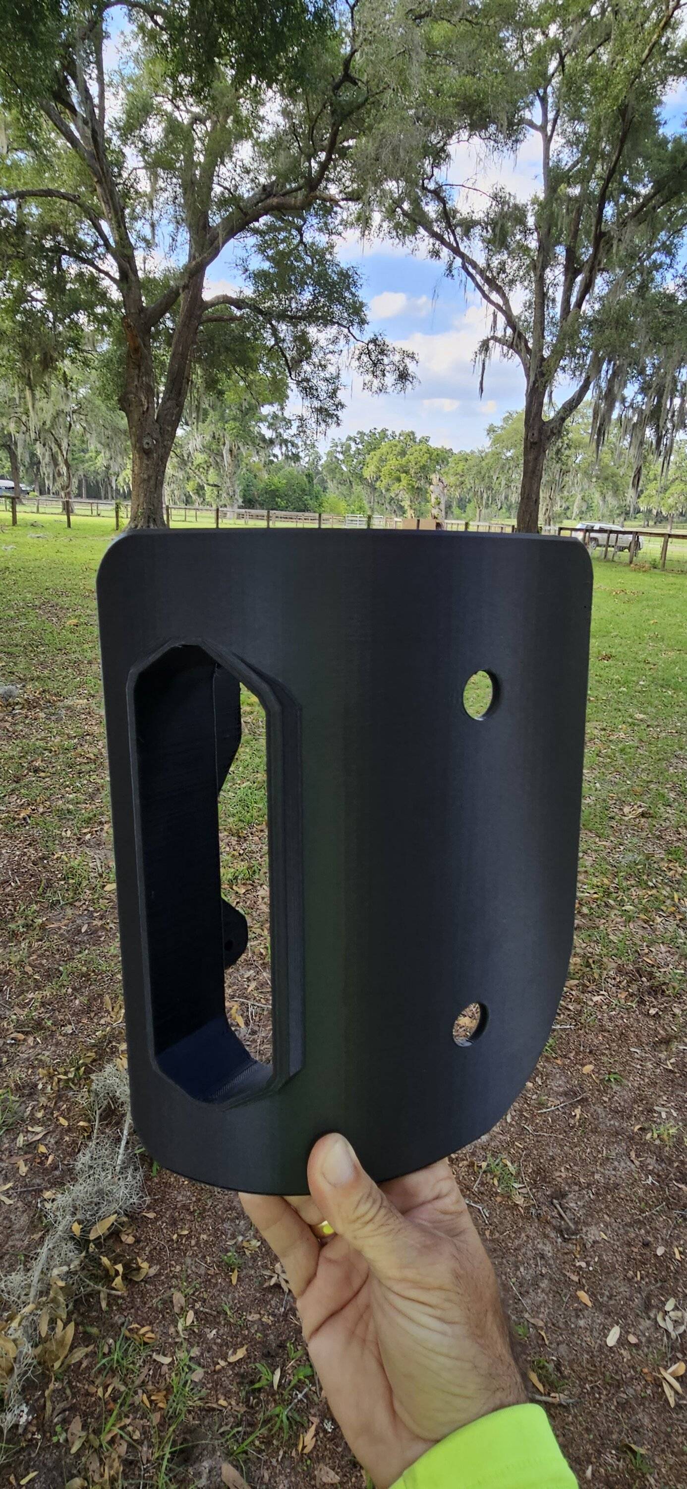

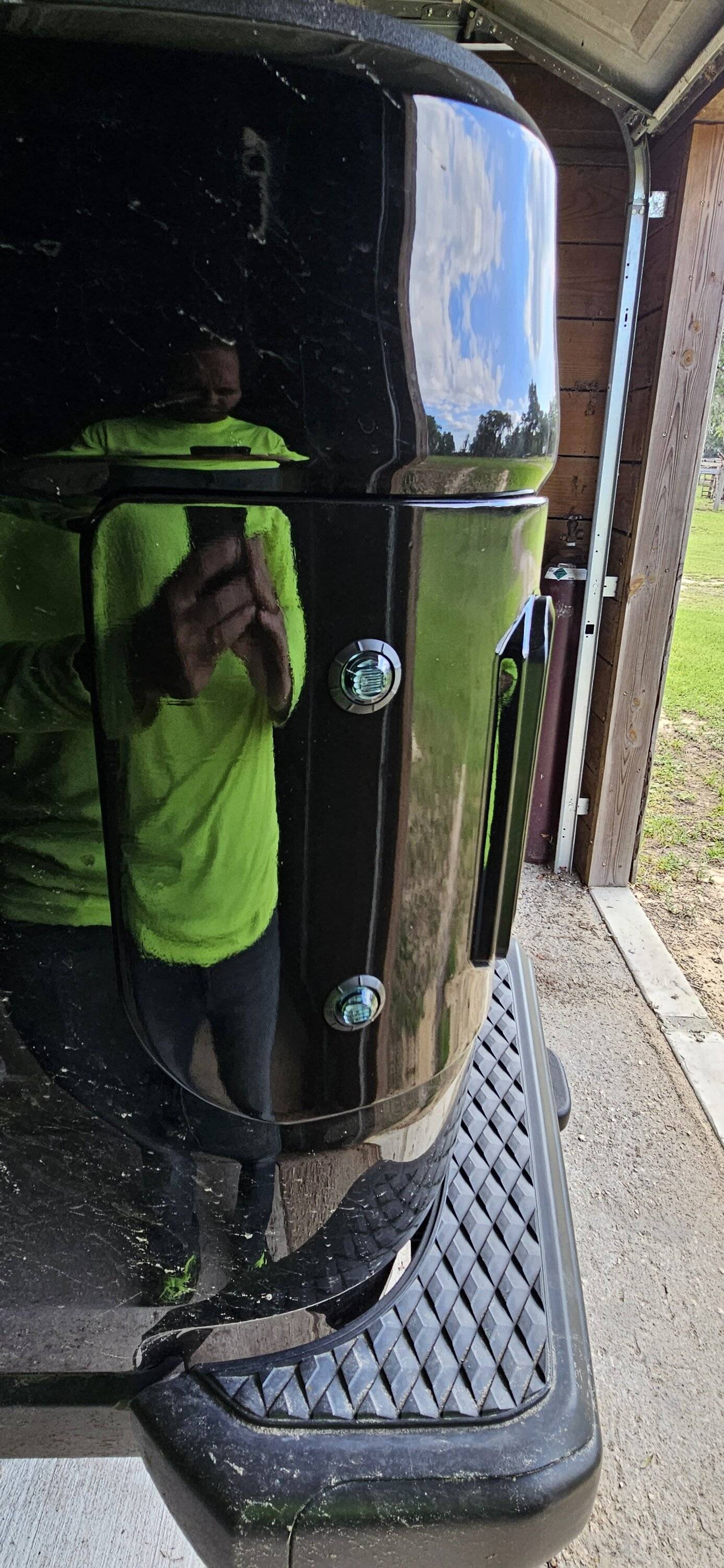

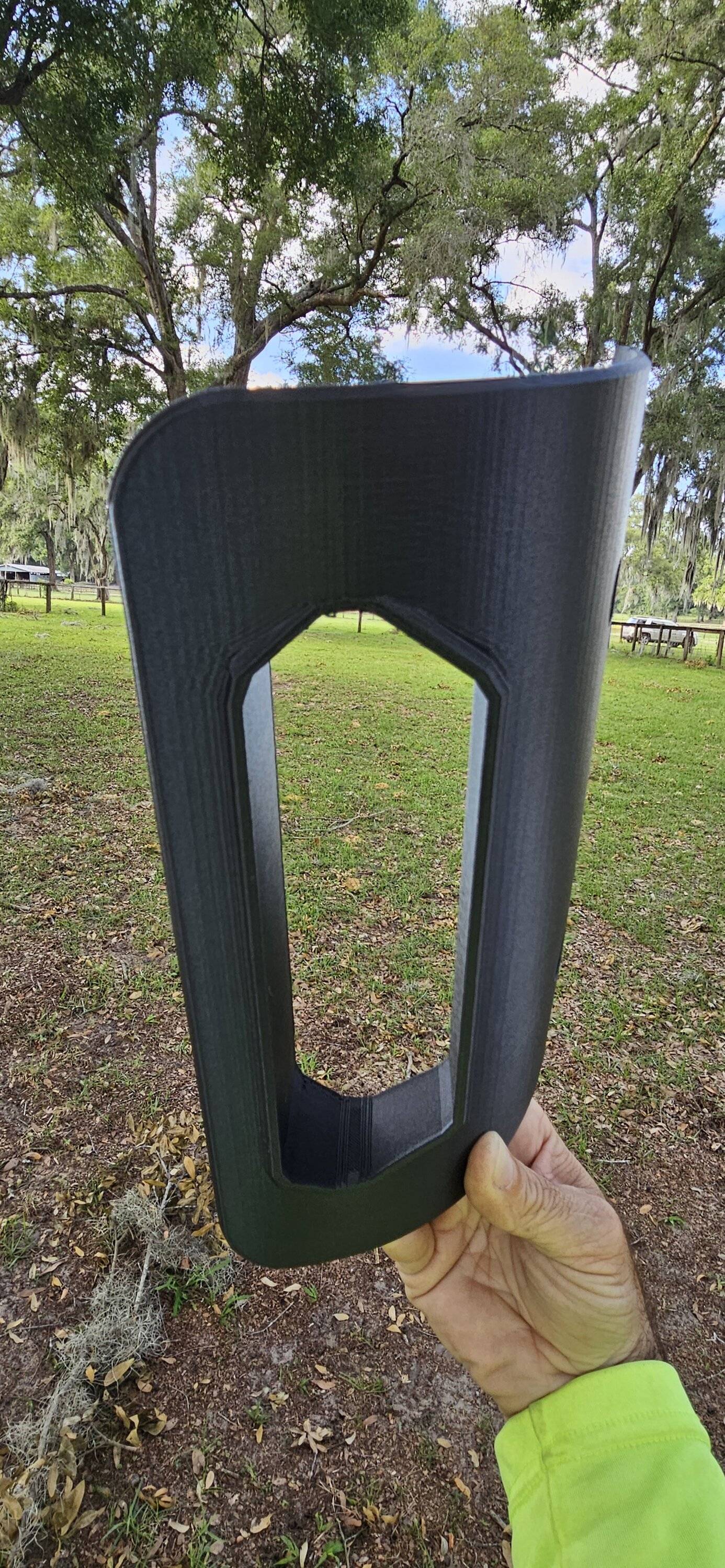

Here's some pictures of the carbon fiber filament printed
That looks amazing! Is that straight off the printer or do you need to sand them to get to that point? If that is no sanding that is just crazy how well they turn out. Have you found any tail lights that are rectangles and not angular?
Justinswidebody
Dec 21, 2022
463
1,142
Ocala
Jeep gladiator
That is straight off the printer with no sanding or any post processing.
The carbon fiber filaments all come out like this. This is petg carbon fiber. I'm going to let it sit outside in the Florida sun today to see if it gets hot and deforms. From my research outside in the Florida sun petg should be fine. But inside in a car can cause deformation. So we shall see. Petg is also very UV stable. Also easier to print with than abs and asa. ( No heated chamber needed )
