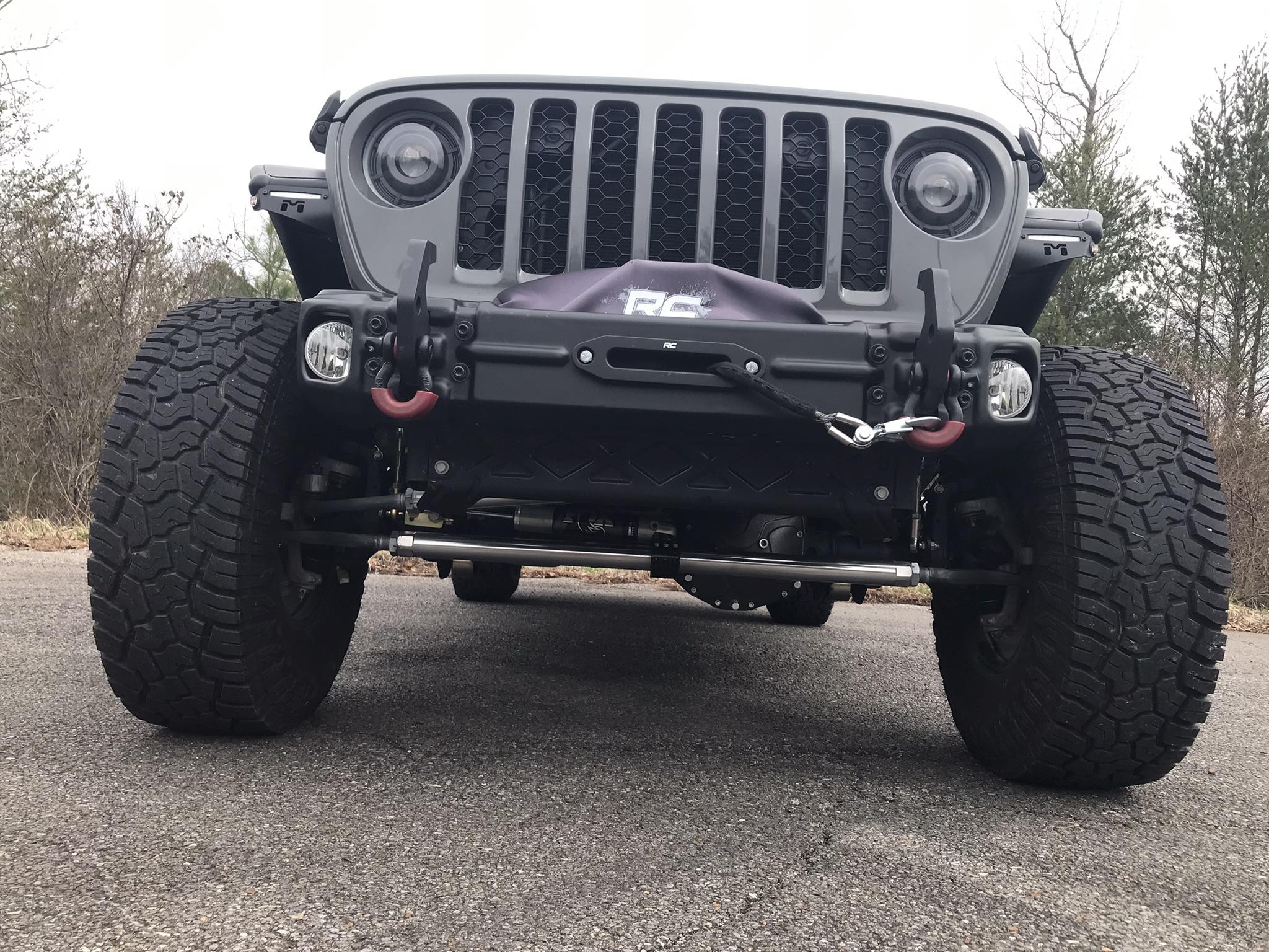

The RR HD Stubby is on my short list of bumpers.
yep, I was going to go with that too, until I found the JK Hardrock with the winch plate for $250…. I added the shackle mounts in place of the crush cans, and left the plastic off. Texture paintEd and it matches the hardtop very well. Now I need to refine the bumper a little more with some trim pieces/finishing panels… like the Maximus3 back panels, and their winch and grill surrounds… maybe a winch overrider bar.

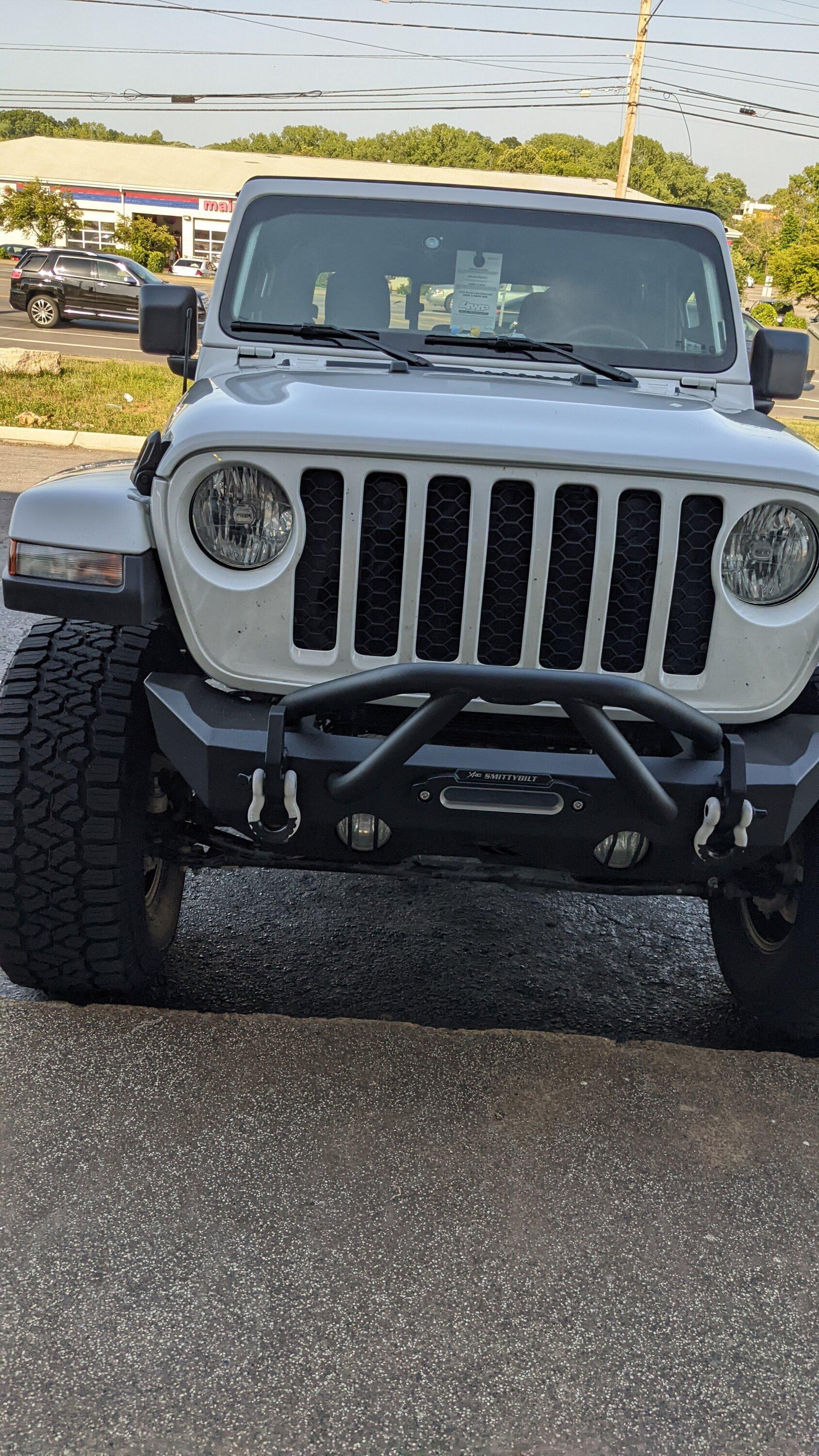

How thick is the metal in it?
I may not be the best judge and I didn't measure anything but it feels pretty sturdy. I had purchased a Oedro Bumper from Amazon and returned it previous to the RR. The RR feels twice as strong as that one.

The only thing I found on their website was 2.55mm and 12 gauge steel. How thick is the winch plate?
Looking through the Q&A on RR's website and they claim the winch plate is rated to 12.5K, so should be good there.
Also speaking of the metal found this as well -
Yes the bumper is 2.5mm thick, but all structural components (winch tray, connection points, etc...) are at least 6mm thick steel. We made the skin thinner for weight reasons and it allowed for a better design.
