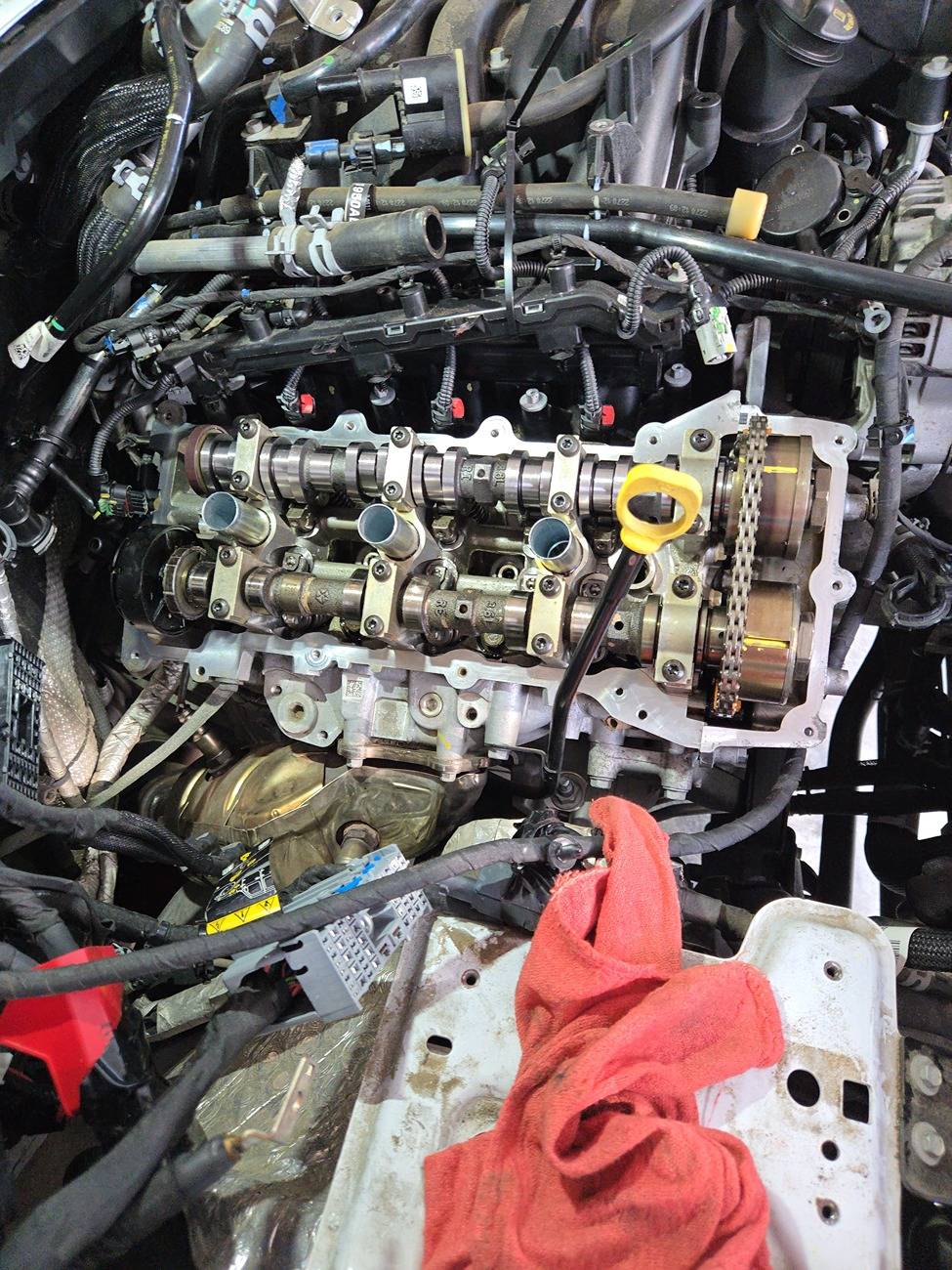

2020 sport needs a new camshaft but it’s on backorder. They said not to drive until it’s replaced. Been 2 weeks now with no updates. Can’t even give me a loaner they said. They’re all out and if they had one they charged me $75/day since I’m out of warranty. Anyone got any inside baseball info on how long I’ll be waiting or how bad the backorder is? Thanks.
Last time I talked to my friend in the parts dept, there were over 12k on backorder. I've been waiting for over 2 months, 2021 JTR with 73k on it. I had mine for 2 weeks and less than 400 miles when i heard the ticking noise. I finally bought a Chinese one off of ebay a month or so ago, replaced the cam and one rocker. So far I had a code for timing right after startup, cleared it and it's never come back. If I was guessing, I'd say the OEM parts come from zch8na, too. When my parts do come in, I'll tear it back down and install them. Chrysler is supposed to be paying for my parts. Also waiting on a new front axle assembly to show up. Selling dealer is replacing it as it was part of the deal.
Jeep Gladiator Cam shaft backordered 71f68751-1cdb-4864-9c80-0ec1ca4bc6b6
250
40,617
54,331
You never replace a cam without replacing followers. They wear-in together. I know over the decades people have "gotten by" and "been fine", but it's a horrible practice and would get you a "do it over" from your boss if you worked in a shop, or at least a D if in a college course.
But, that's the internet generation, D-I-Yers and YouTube university.......
Sorry, but it's asking for trouble. You may be fine, may get lucky, but I'd fire you LOL

Im not "internet generation" as you say. I'm a retired tech of nearly 40 years. I was an ASE certified master tech in cars and ight trucks, also a master tech in heavy duty trucks, ASE certified in alternative fuels, light duty diesel. I'm fully aware it wasn't a full repair but I'm not spending $125 each for followers only to be replaced again soon. Thanks very little for your condescending opinion.
I would have done the same also. Most would understand you scabbed the Chinese part and single follower as a temp measure.
Crane
Steve
Jul 31, 2024
55
82
New Jersey
2025 Jeep Gladiator Sport Max Tow, Honda CR-V, Honda TRX400EX
Teacher
I don't know squat about tearing down an engine, but I do know not to let the perfect be the enemy of the good. As you said, sounded to me like a good temporary fix.
250
40,617
54,331
A "get by" "fix", hoping for it not causing more severe damage down the road.
But as I have other vehicles I can use, mine would be parked. So there is that difference.
I "know" a cam rotting should not cause other issues, but there are enough "stories" out there, and knowing how picky the other components like phasers and so on are, paranoia does enter in.
I've yet to "see" or witness other damage that was directly caused by a cam or follower (or lifter in the past) going to crap, but....................
