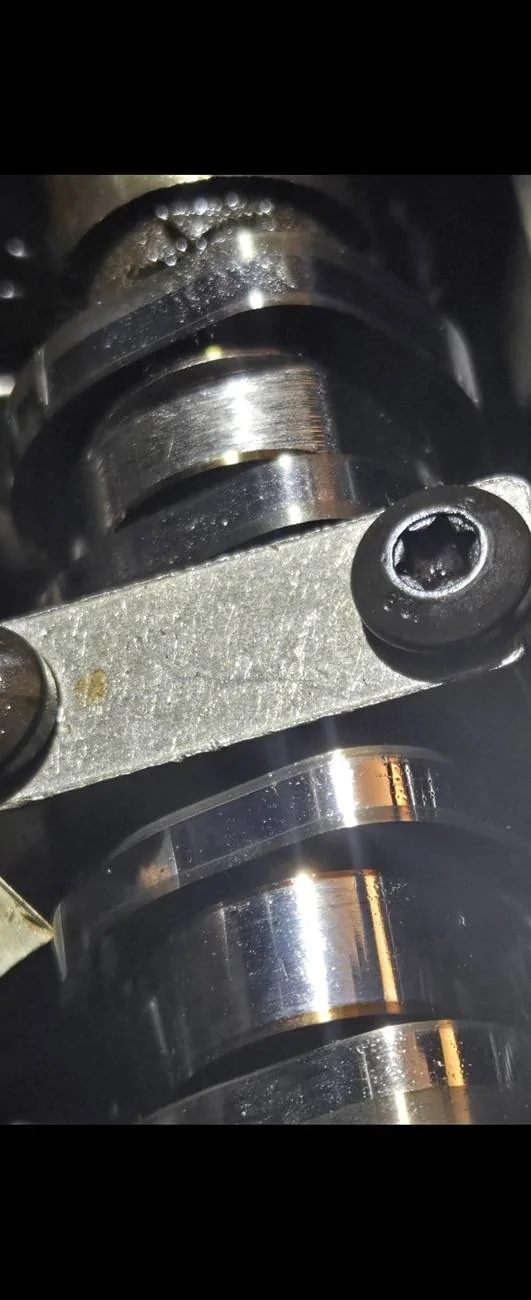

The axle assembly. was also backordered but is now expected in another week or so. The cams still have no ETA as of a week ago. I didn’t want to do the job twice but it really isn’t bad at all. I bought the timing tools and changed the other one in about 7-8 hours, I’m old and slow now. The worst part of the job is removing the battery tray but getting it out of the way was worth the extra time. The Jeep runs absolutely great now, smooth as silk. How long remains to be seen. šŸ¤·ā€ā™‚ļø
Here’s a better shot of the cam, 3rd lobe from the rear on right side.
LOL - maybe let it run and save the parts when they come in?!?!?
That's one of the worst lobes I've seen - save for totally round ones years ago in legacy V8s. The other one is scored a bit.
It's worth the time to remove "stuff" that prevents easily getting to that bank, IMO. I've done too many things thinking I was saving time by not removing something partially in the way. I later regretted that decision.

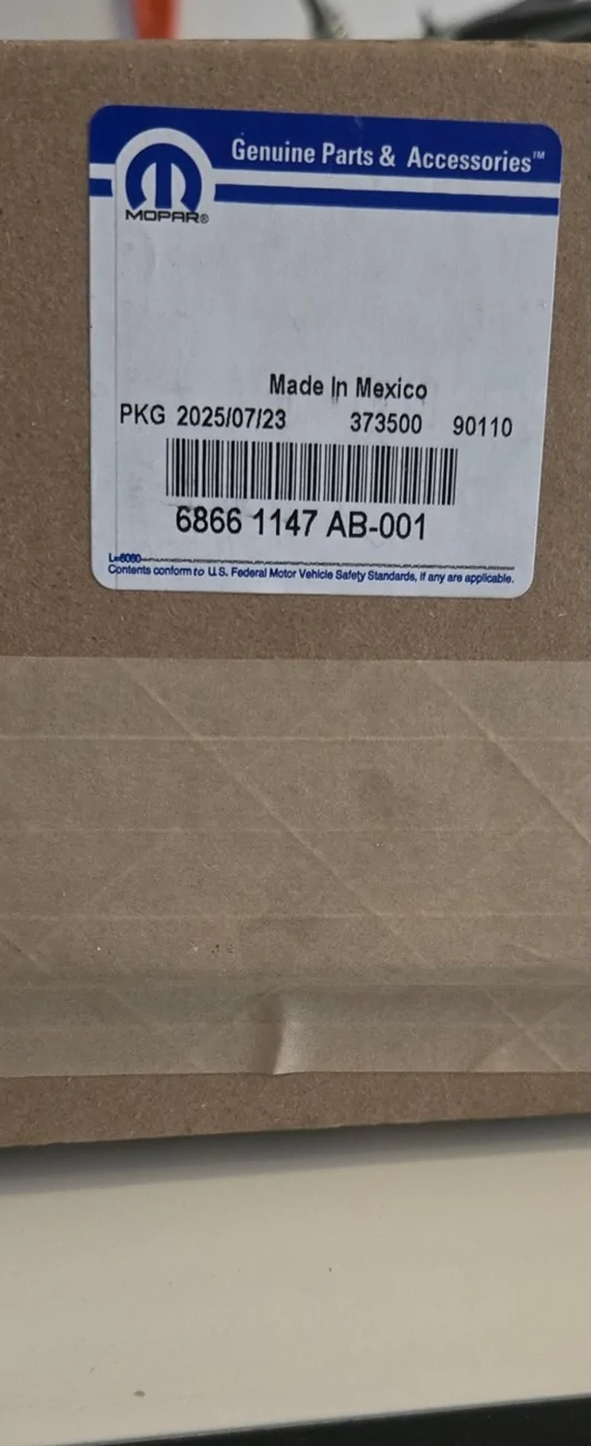

Look what I got today! A shiny new camshaft kit! 1 right bank intake camshaft, 1 valve cover gasket, 3 spark plug well seals, gasket maker and 6 cam followers! My weekend project!
Made in Mexico šŸ¤¦šŸ˜Ž wishing you easy repairs and a great running engine.
