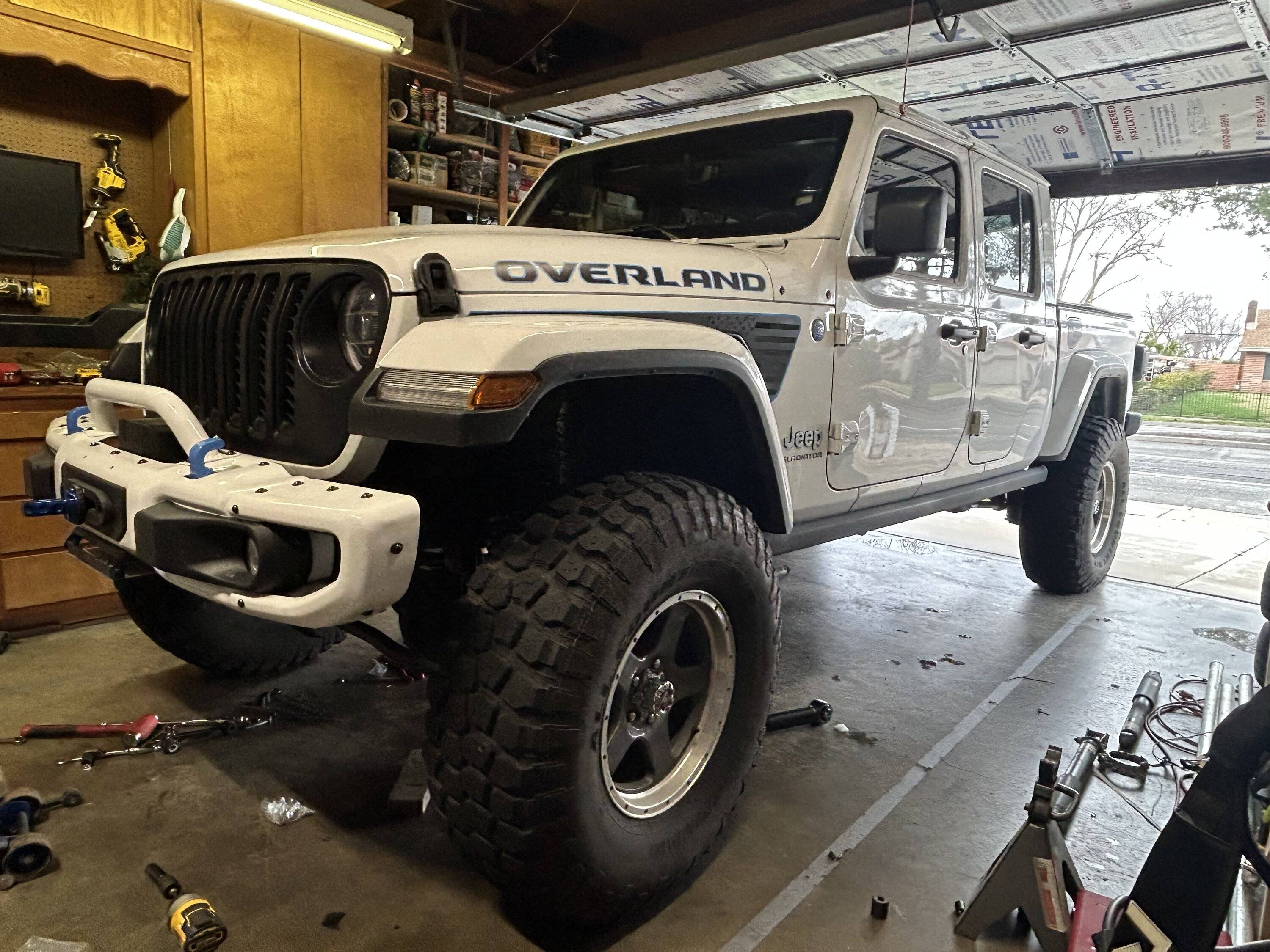

More height and tire than I want, sure looks nice on your ride! Nice pal!
1.5in up front with either nothing or the 3/4in daystar rear.
that was my original lift when I got the gladiator and honestly was fantastic looking. I had just a little bit of break with it and it didn’t require any additional steering components to correct geometry.
if you’re only looking to be a little more level, then just shoot for the 1 inch front spacer. Thankfully they’re in expensive enough that you can give that a try and if after a while you really still don’t like it you could pick up a 1.5 inch also cheap.
