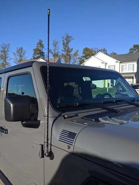

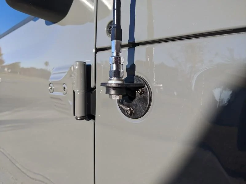

Same here. I went the opposite of many and replaced the stock antenna with a CB antenna and signal combiner. This way I didn't have to add a separate antenna to use both the CB and radio. That said, I've been in the habit of removing my antenna for a long time, before any auto car wash. So having a wrench handy to remove, toss in the back seat, then install is a fairly painless solution IMHO.

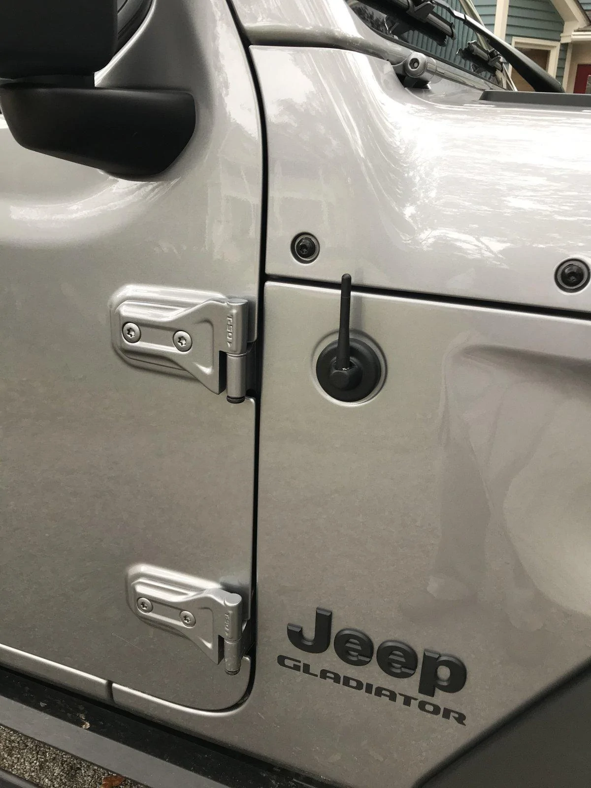

Mine is about 3 inches short and gets fantastic reception. And when I take it to the car wash(truck beauty parlor) I don’t even think of taking it off.

Cool to see! I just got the same setup with a 2' Firestik delivered yesterday. Still no CB (F&*K Fry's Electronics by the way - don't ever do business with them), but I figured I could at least hook the rest up. Mine is a Sting Grey to boot.
Anything goofy with the installation? I imagine it would be straight forward.

So, I'm not sure what parts you plan on using, but I went with the Rugged Ridge antenna kit, to get the combiner, mount and wiring. I read, though, that their piece that went from the antenna to the truck (makes a 90 degree turn from the antenna base) is delicate and can break easily. With that in mind, I used a Firestik Firering instead at the base of the antenna.
Also most likely overkill, but I ran a ground wire to the base, to ensure I didn't have SWR issues when tuning the CB. It was also a bit of a pain disconnecting the FM antenna at the firewall.
As others have said, I don't use FM much, but I do like to have that option. I'm also planning to install a Ham radio, so it was important to me to minimize the number of antennas. In the end, I'm sure I spent a little more money than if I'd sourced the parts separately, but I'm very happy with the clean install and the functionality.

Yep, I also got the Rugged Ridge kit. I would have liked to have sourced some of the items separately, but I wasn't able to find a mount for the antenna on its own; only within the kit that has everything. A bit more expensive than I would have liked considering what you get, but I'm also on the minimal antenna train and forced to get this kit short of fabbing up something myself. I also see you got new hardware which I will probably do myself. Do you recall the thread and length? I may opt for button heads.
I was going to start digging into it today, but the weather isn't compliant. Hope to tear it apart tomorrow!

Brand? I bought an AntennaX, and it destroyed radio reception (in the middle of Los Angeles). Any recommendations would be appreciated.
