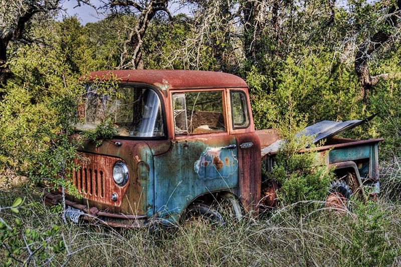

The patina on this truck though... #drool
Is it a Dodge Power Wagon from the mid to late 50s?
