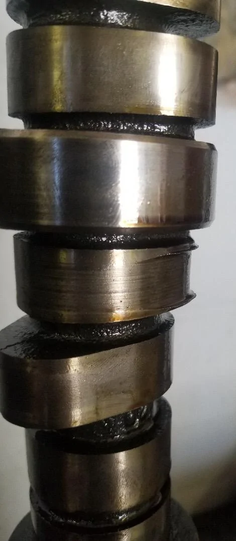

I had a Cylinder 3 Misfire non-blinking message on my SRT. I kinda think it was worse than it let on....not blinking and all.

Roller tip froze up..... owey
Yep...needles were gone and the roller was more Stop Sign shaped. Not sure I could have really saved the cam regardless of how quick I caught it. I didn't hear anything other than Hemi tick...nothing. That thing should have squeaked something awful !!
New cam going in.
Just sayin'....Service engine light, could just be a gas cap, or could be the last breath of an exhaust lobe being wiped off the face of the world.
