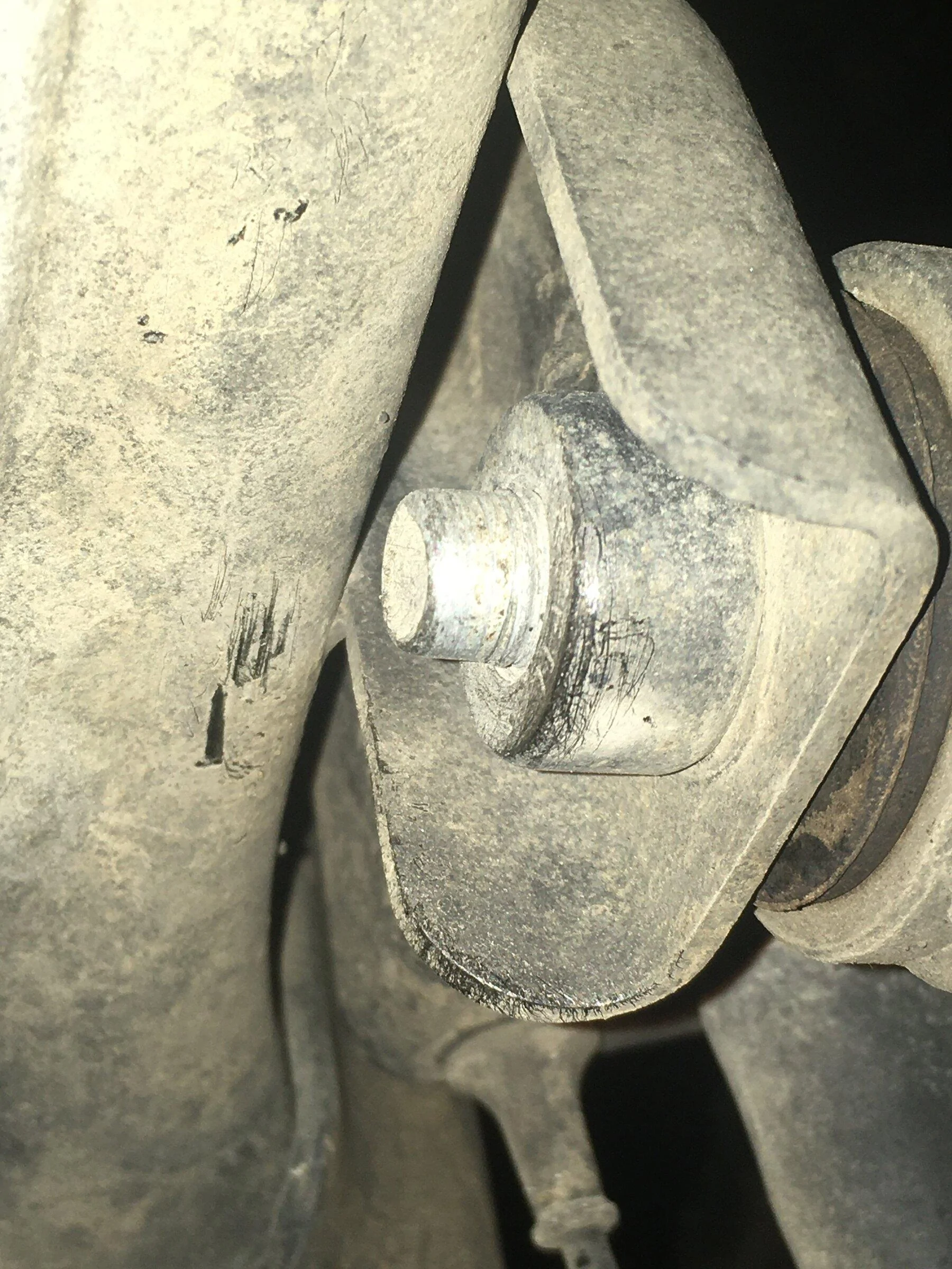

So this will correct the short 56mm m12 bolts that my JT has also. Barely comes thru the threaded barrel nut. Just the unthreaded end shows.

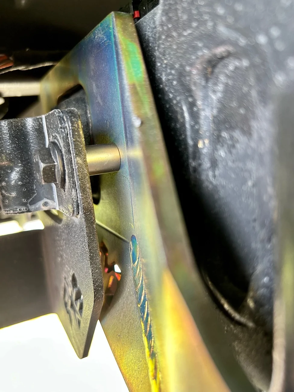

I recently installed the Metalcloak brackets. Their bolts were a little shorter than the longer ones I bought at the start of this thread, so I stuck with the longer ones and the extra nylock nut on the back side.

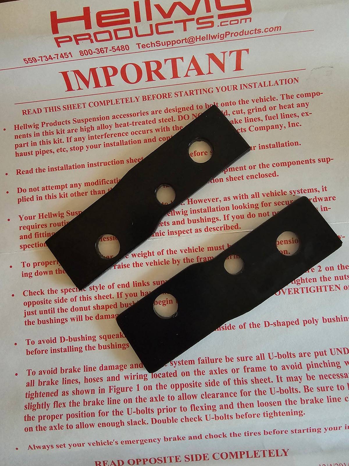

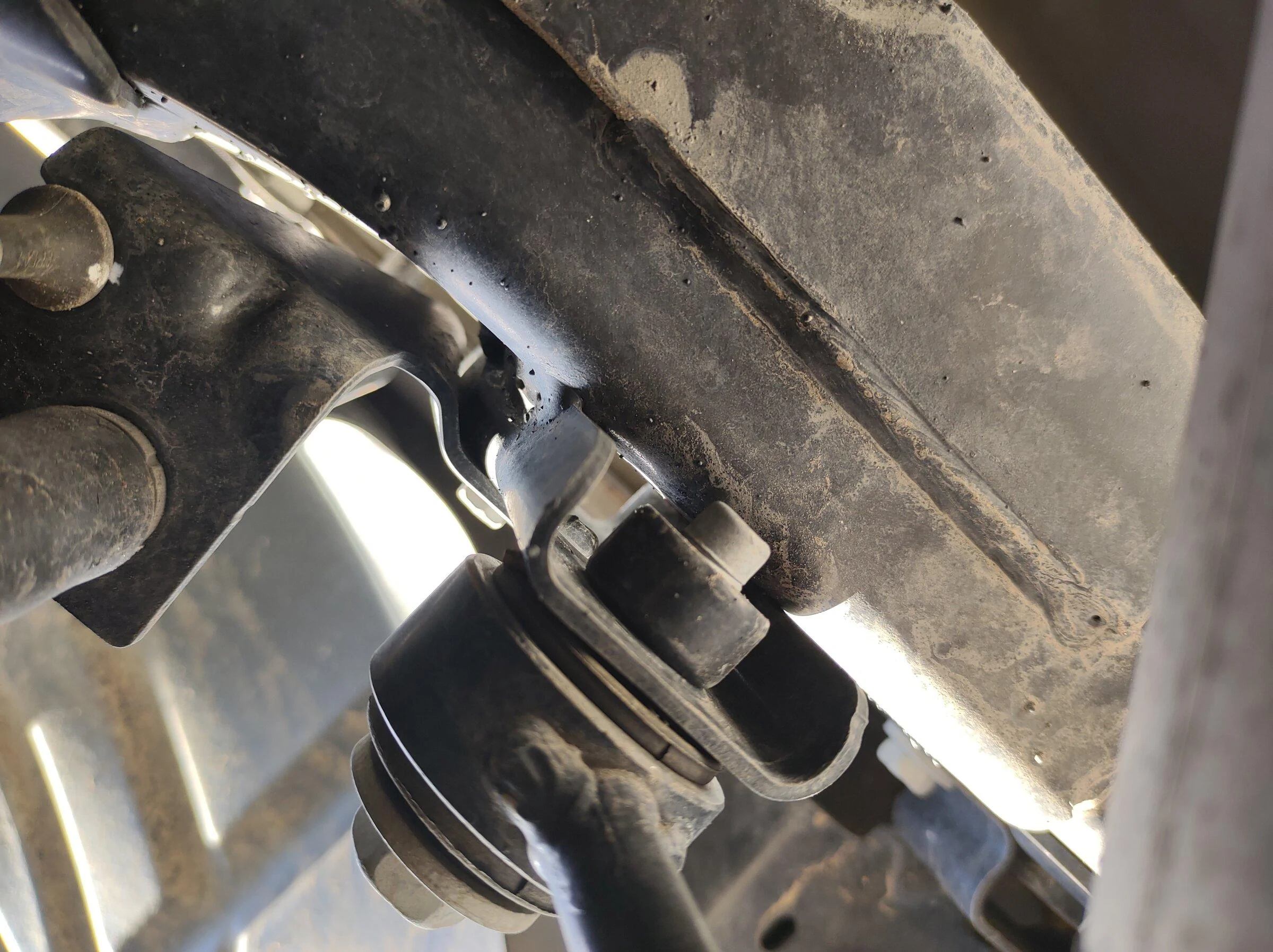

The m12 x1.5 bolts are 80 mm long , they came with my hellwig sway bar. Surprised they had a little reinforcement bracket in their kit now. Was not advertised that way on extreme terrain, will not be using it. Only fastens to frame with the one 1/4Ă—20 bolt for the brack that bolts to the mount. No thanks ...
The metal cloak brkt looks and has to be much stronger. Will be painting the MC brackets on Sunday to get ready for install.
I got a couple m12x 1.5 nuts from work .
These are the brackets that came with my sway bar from hellwig .

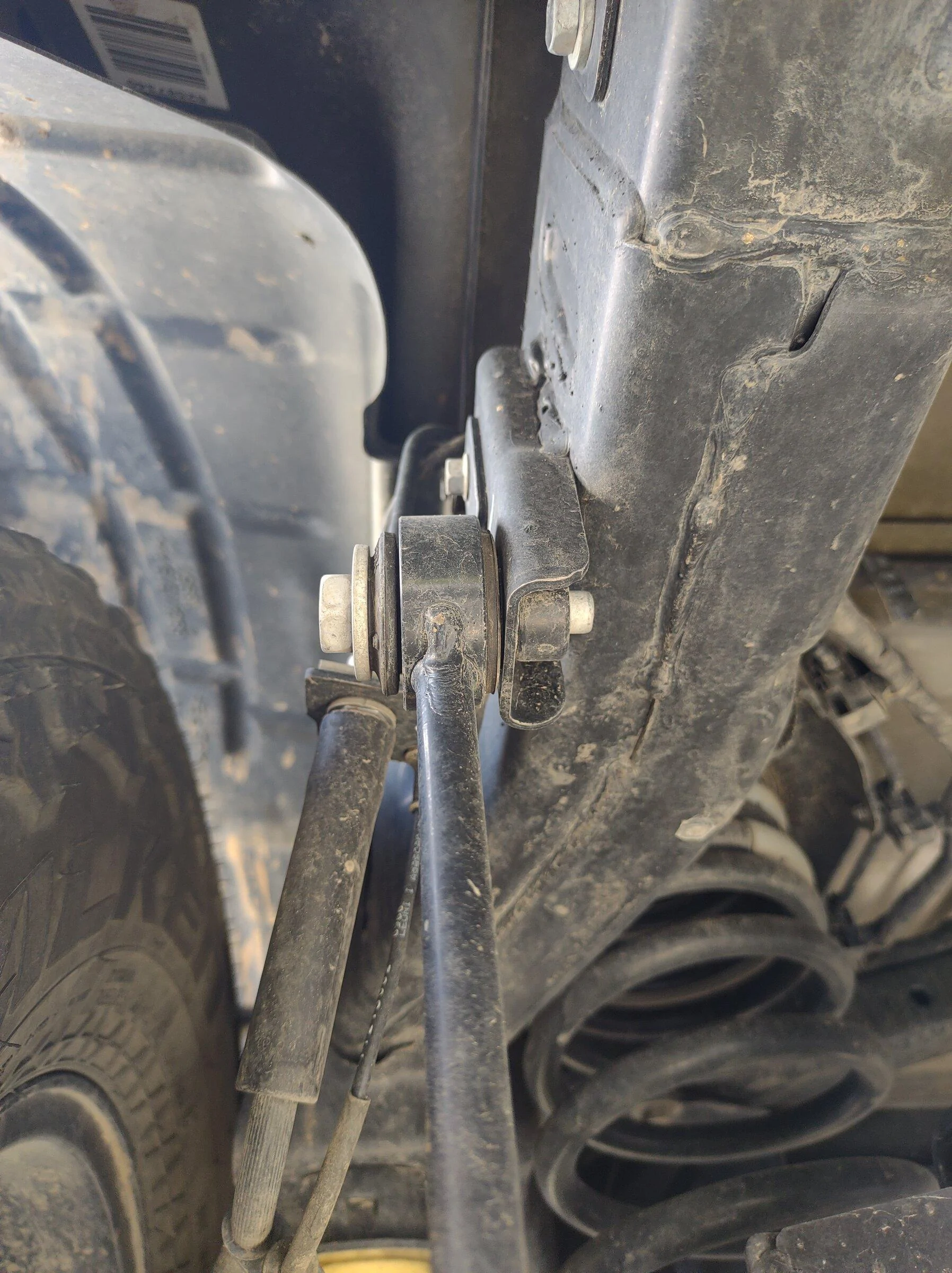

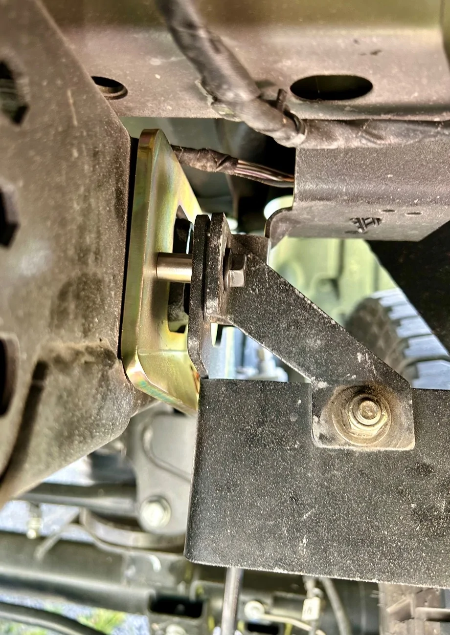

I installed some spacers (M8, 1/2”) and used M8 1.25x50 flanged head bolts to install my rear Metal Cloak sway bar reinforcement brackets. I have the RocBlokz mudflaps.
