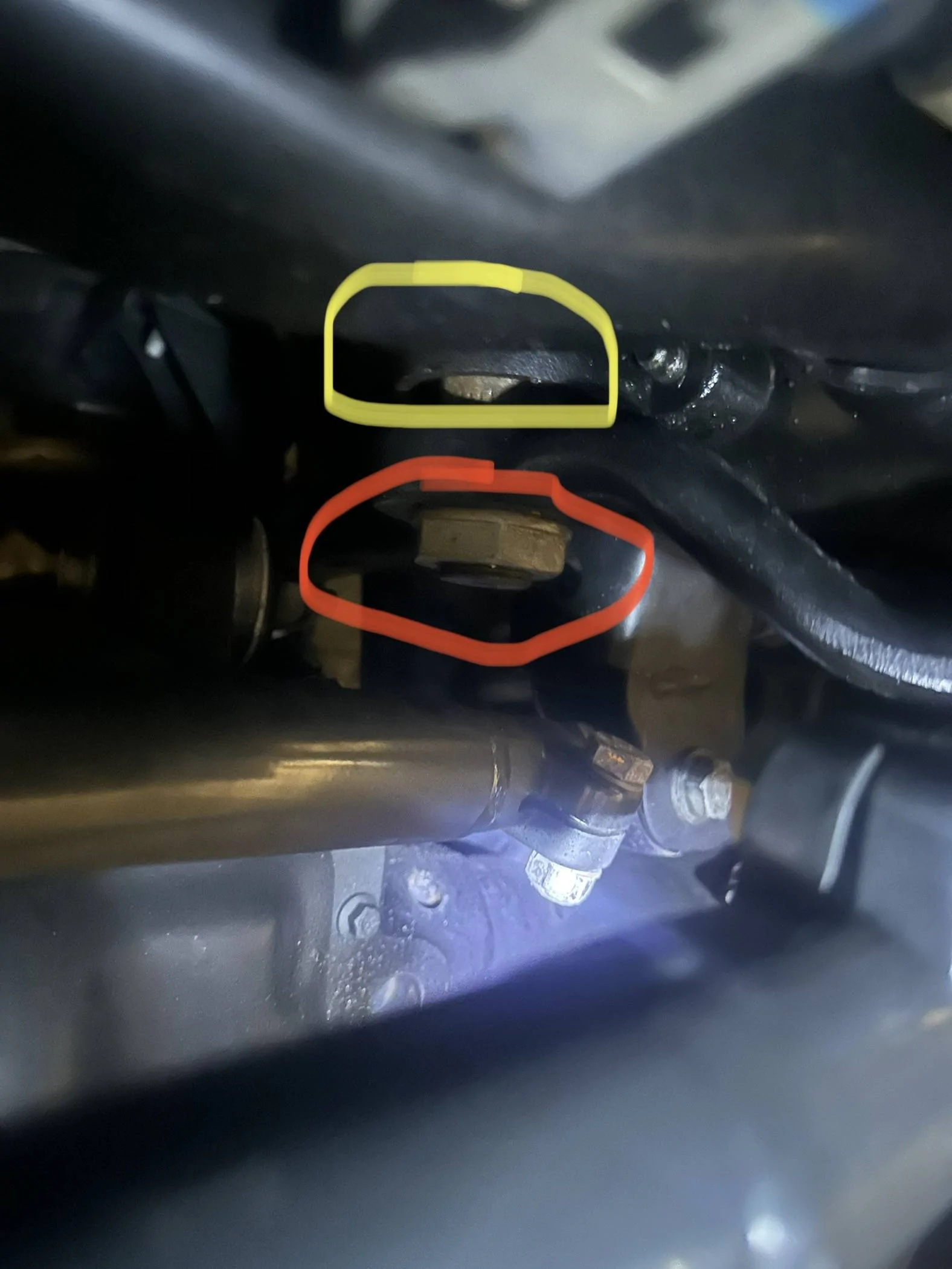

It looks loose to me. My stock one doesn't move.
I am going to try and fastened the pitman arm 41mm to steering box today before installing the metal cloak brace first.
Looks loose to me and too much space (yellow) and not enough thread exposed (red)
If you haven't found a 42 mm socket, a 1-11/16 works fine and is much easier to find.
Sunex 254D, 1/2 Inch Drive, 1-11/16" Deep Impact Socket, Cr-Mo Alloy Steel, Radius Corner Design, Chamfered Openings, Dual Size Markings, Meets ANSI Standards https://a.co/d/6fqx97W
you can not get a torque wrench in here I assume to spec it, so just crank tight I assume? 185 ft pounds?
I got a torque wrench on it with an extension. You should take the trackbar out to allow you to get to the Pitman arm nut better.
Metalcloak tells you to do that in the instructions.

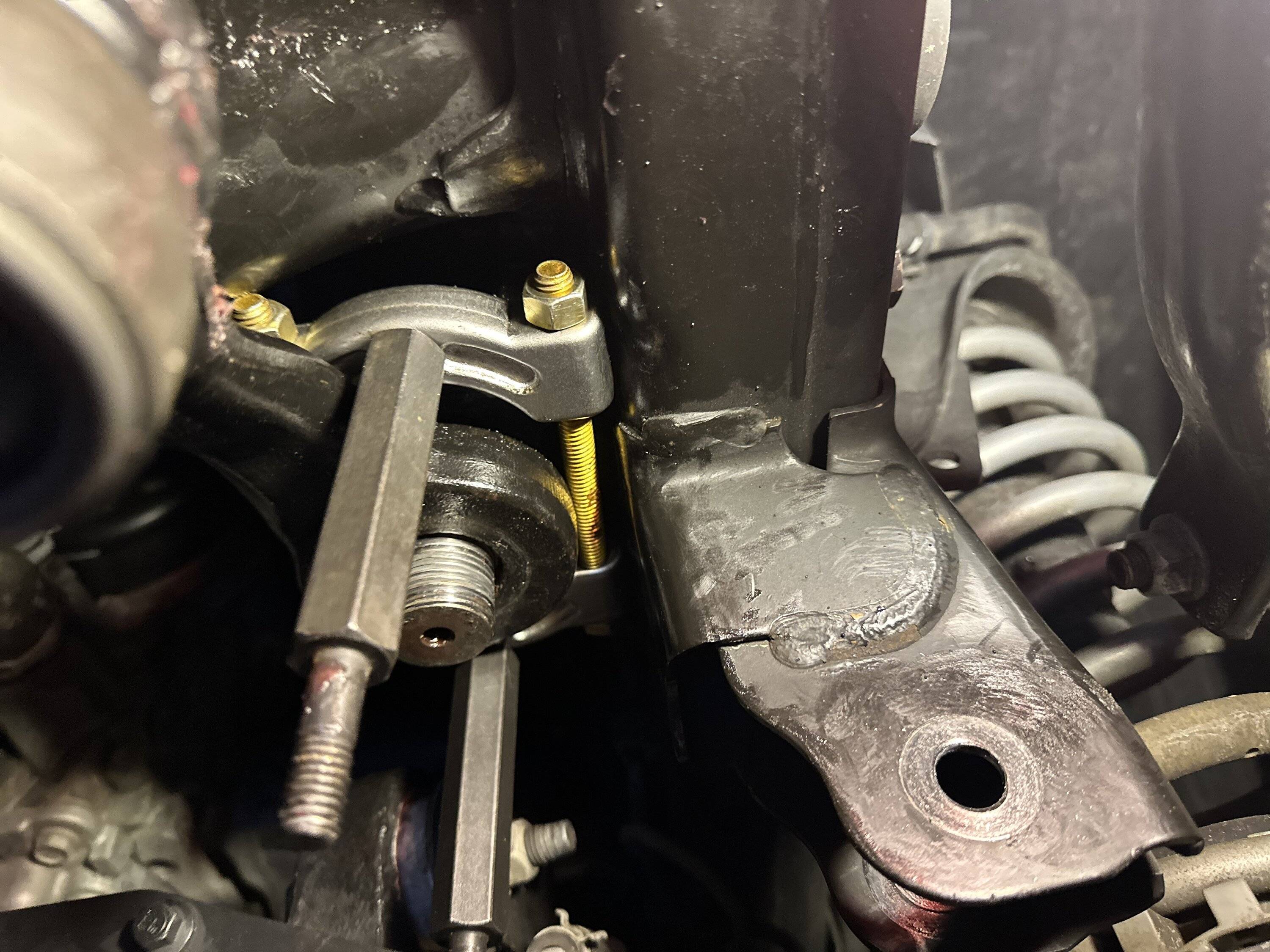

I dropped pitman arm, a bunch of corrosion and flat teeth ridges.Replacement pitman bolt came with lactate, which original did not- added additional red loctite and did 185ft pounds, boom back to solid firm and sharp.
Replaced pitman arm + pitman arm nut
I am now on the fence of re ordering metal cloak sector for assurance- what’s your opinion?

The brace won't hurt and will add support, but it's not absolutely necessary.
Glad you finally got it firmed up!
