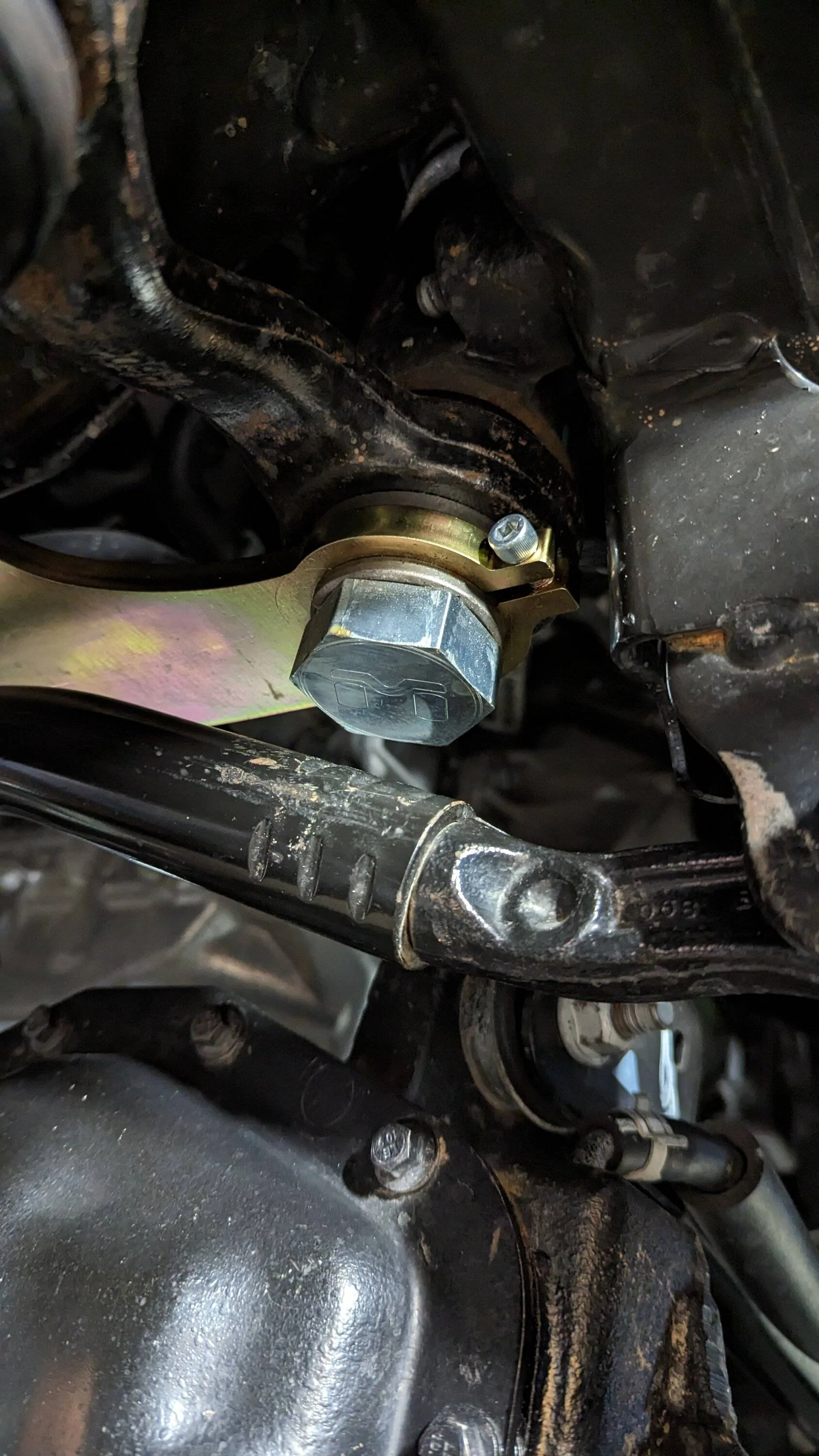

I installed a SteerSmarts brace shortly after I got my JTRD. It's been almost a year now and no issues with it.

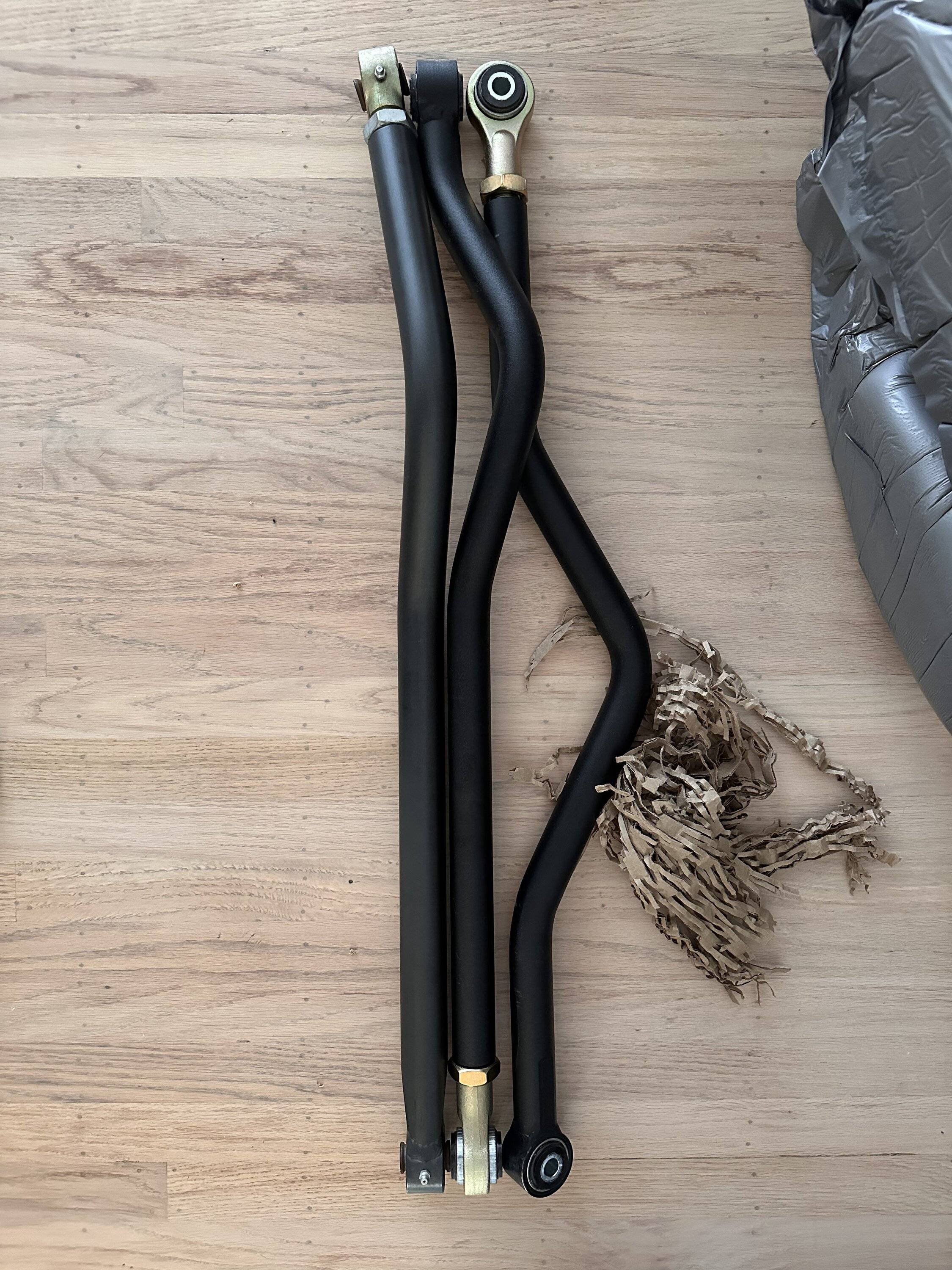

I have a Core 4x4 track bar on order. I like the Johnny Joints on both ends.
Did the Core 4x4 work with the steering brace?

The Core track bar works with the brace. But I had to enlarge the hole on the axle for clearance of the Johnny joint. I used a burr bit on a die grinder.

I used a Steersmart brace.
