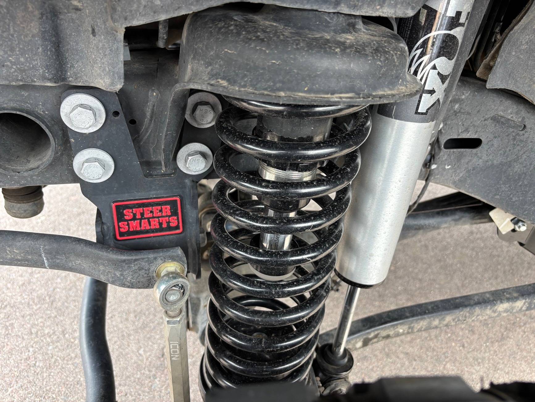

Steer smarts must have redesigned the bracket. No grinding and lined up perfectly. Installed about 4 months ago

I added the Clayton track bar brace today. It's advertised for the diesel but i still had to do some grinding. They redesigned for the extra factory spring perch brace (diesel and Mojave), but didn't for that brace's weld. Other than that, everything else lined up with quality weld, coating and hardwares. I also added a relief cut to the brace to ensure that it clamp the bushing properly, similar to factory relief notch.
