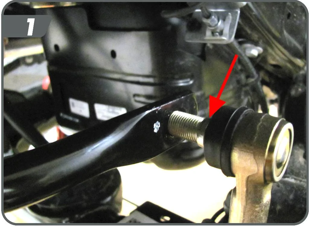

The bushing has an inner steel sleeve. There is no 'squashing' the bushing.
Yeah, I've noted that here and there - seeing "don't squish the rubber bushing". These are like bushings have been for decades - you must clamp that middle sleeve hard, it must never move. Ignore the rubber.
WILDHOBO
Sep 24, 2021
73
11,701
17,808
2021 Gladiator Rubicon
Network Engineer
I haven’t seen an oem link for quite some time, but some of the aftermarket links have pretty thin gauge sleeves. They would easily crush.
40,491
53,988
But not all of them have the same inner sleeve style. My links are JKS as mine is lifted around 4.5” years n the rear. They’re totally different than the OEM link bushings.
That's not the point - they DO have an inner sleeve. That's how the bushing is clamped in place. If you don't clamp that sleeve hard, you will have trouble like busted parts and wear and movement.
There's always a center sleeve. Always. CLAMP it tight, ignore the rubber.
It's been that way since the advent of bushings in cars. Clamp that sleeve tight.
These are like automotive control arm bushings, idler arm bushings and more - clamp 'em. Ignore the rubber. The sleeve will stop things.
And if the sleeve is too short, you have a crap part, a crap bushing.
These aren't new technology.

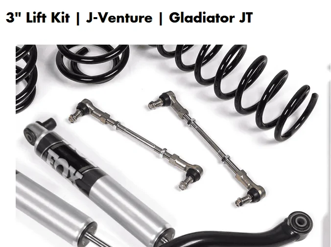

Well, unless they actually DON'T have an inner sleeve. Checking out the JKS web site, they show this style of rear end links for some of their lift kits:
Jeep Gladiator Check Your Rear Stabilizer Frame Bracket Bolts - Mopar New Bolt Length 1676233980551
WILDHOBO
Sep 24, 2021
73
11,701
17,808
Network Engineer
You mean all parts aren’t manufactured the same way?!
40,491
53,988
Ball and socket type - there's no sleeve and no bushing.
There's a seal, not a bushing. That's based on clamping the stud in place.
It's more like a tie rod end....... not a bushing with a sleeve in it that you clamp.
Still, in that case, torque the thing to specs.
Looks like they have at least 3 types - which is best?
The traditional bushing with a sleeve that's actually molded right into the bushing, and the busing a press fit, or molded into the end, requires the sleeve be clamped tighter than shit.
The cons - the bushings can wear and weather and age.
the other type like he shows - no bushing, no give at all. It's a solid ball and socket like a tie rod.
The pros - no bushing to age, wear, weather, crack.
Tough - long lasting save for physical wear inside but likely spring loaded nylon socket to take up wear over time.
The cons - A bit more vibration transferred to the chassis since there's no rubber to isolate it. More expensive (may be made up for in life-span)
Will the solidness really be noted? Meh, unless you detect the pea under several mattresses while sleeping, probably not a big deal.
My take - unless the type with a molded-in place bushing has a sleeve at least as tough and thick as stock, I'd avoid it because it's not made up to the specs of the stock part as far as the ends. If you can't clamp it as tight, it's not made as well in that single respect.
The type in the picture - I'd give it a shot. Tie rods and drag link joints go through heck - why not in this application.
