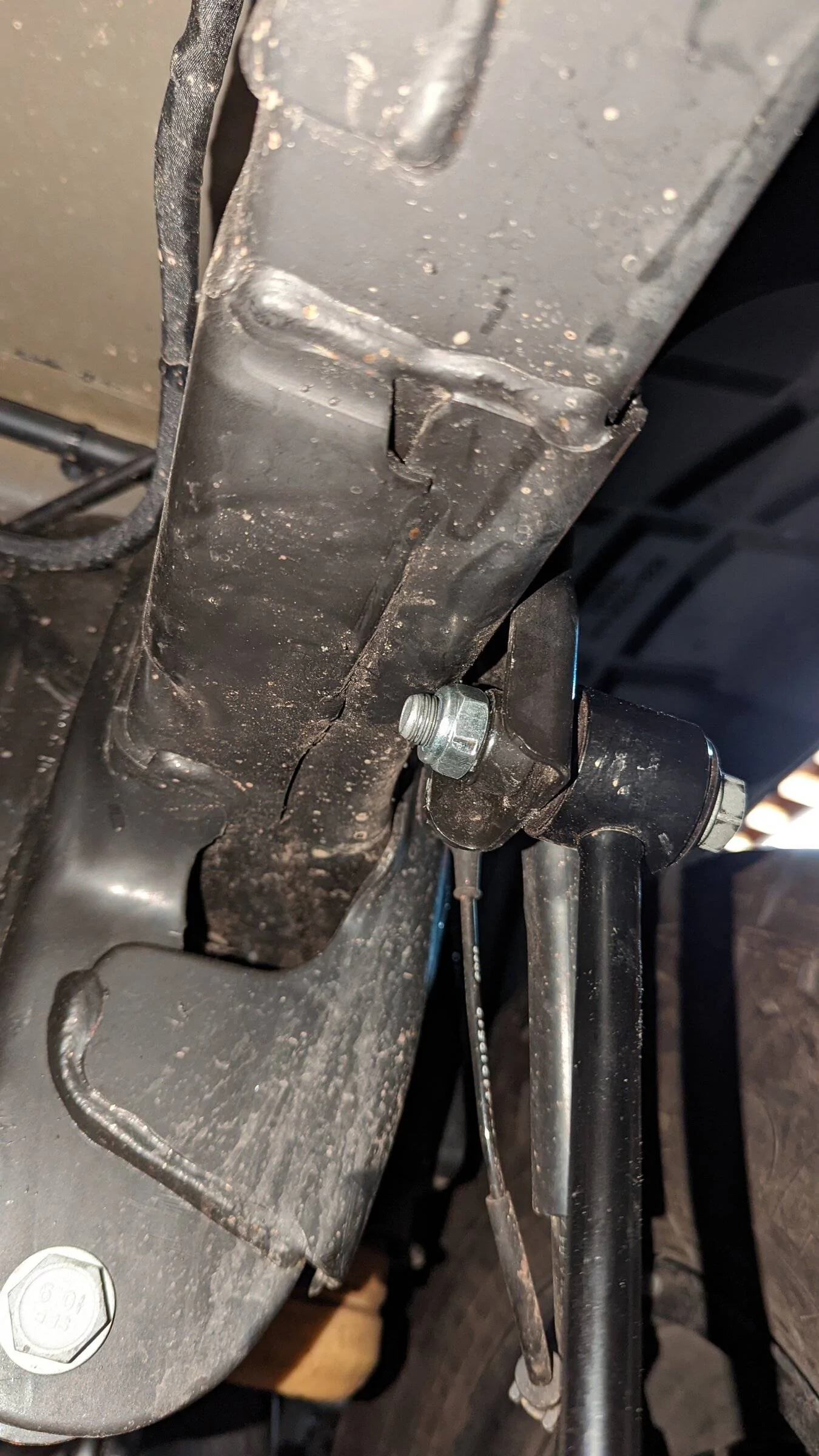

Lunentucker
Lunentucker
Apr 24, 2022
248
5,886
15,414
2021 Jeep Gladiator Mojave
People Work?
The longer threads allow for the installation of a nylock nut as a bit of added insurance against another one backing out.
Not only is it bad for your Jeep, but it's really bad for someone behind you on the highway.

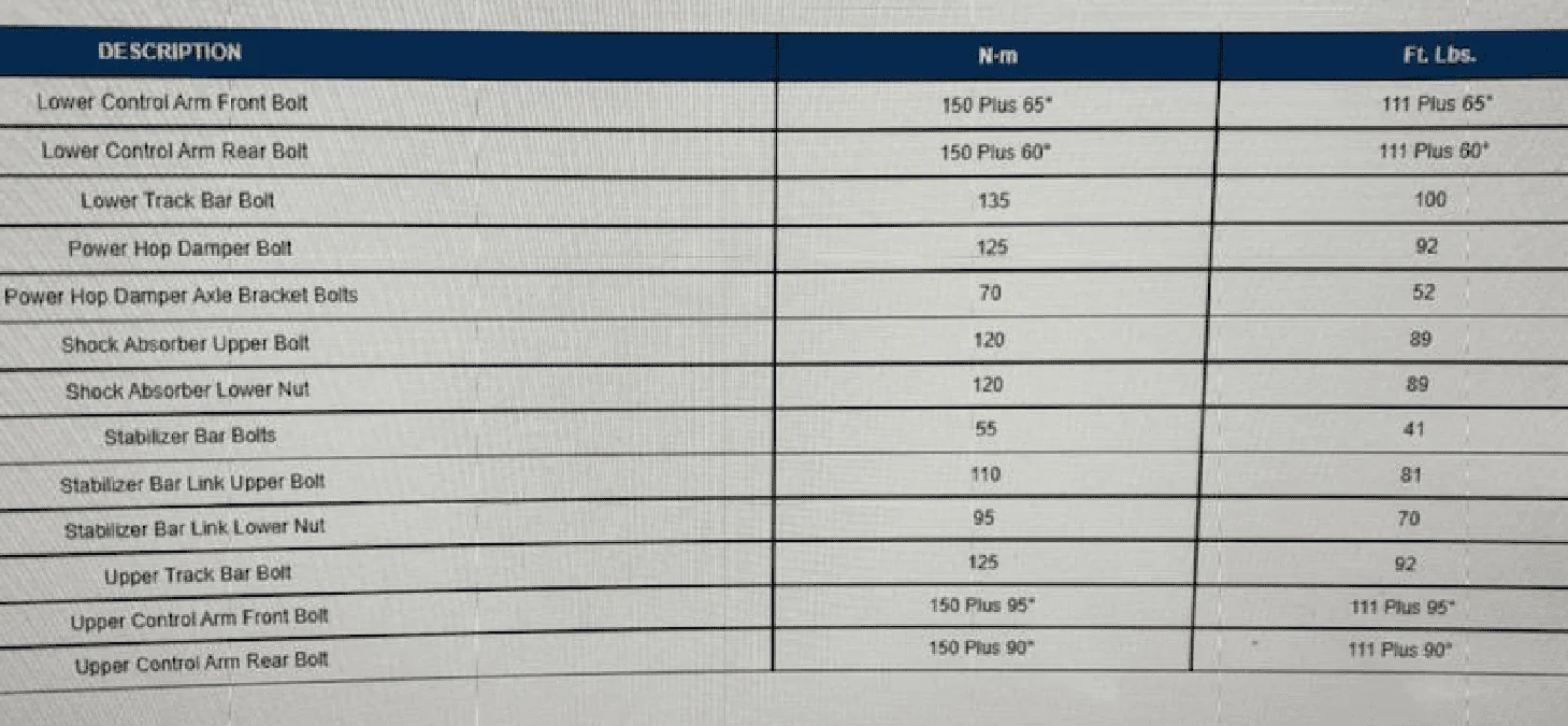

Front axle lower control arm specs are actually 103 pound/ft plus 145 degrees.
That's FACTORY specs. They are tighter than most of what's floating around the internet.
That works out a bit over 200 by my testing.
Front upper control arms have two different specs - one for arm to frame, the other for arm to axle.
I'll confirm the front upper control arm specs on Monday - unless I find a better pic of them that I can read.
Looks like the upper control arm rear is 111 lb/ft plus 95 degrees
Front axle UCA front bolt - too hard to read my scan.
Here are the rear axle torque specs - FACTORY -

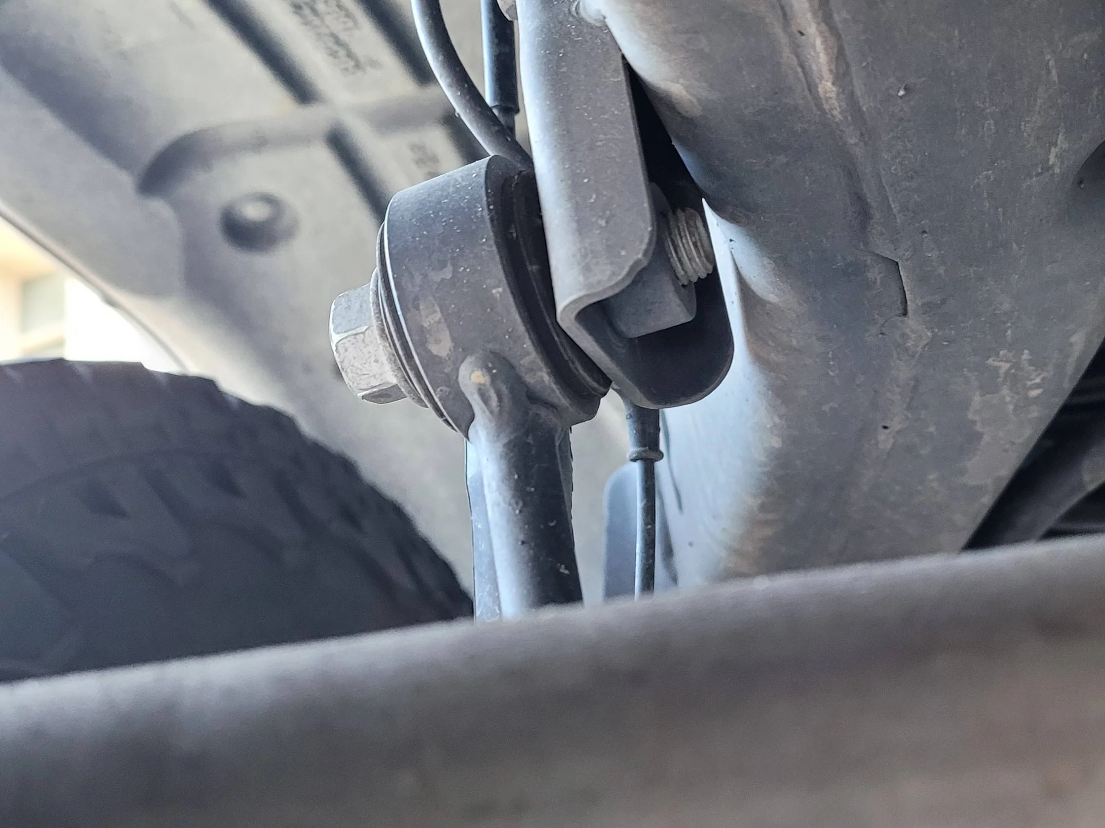

This is interesting. I see that everyone's bolt has a non-threaded pilot point, but mine is fully threaded straight cut. 2020 JTR 3.6.
The 2020’s had longer bolts. The theory is that the supply chain shortages starting with the ‘21 models caused them to use shorter bolts. Mine had shorter ones.
