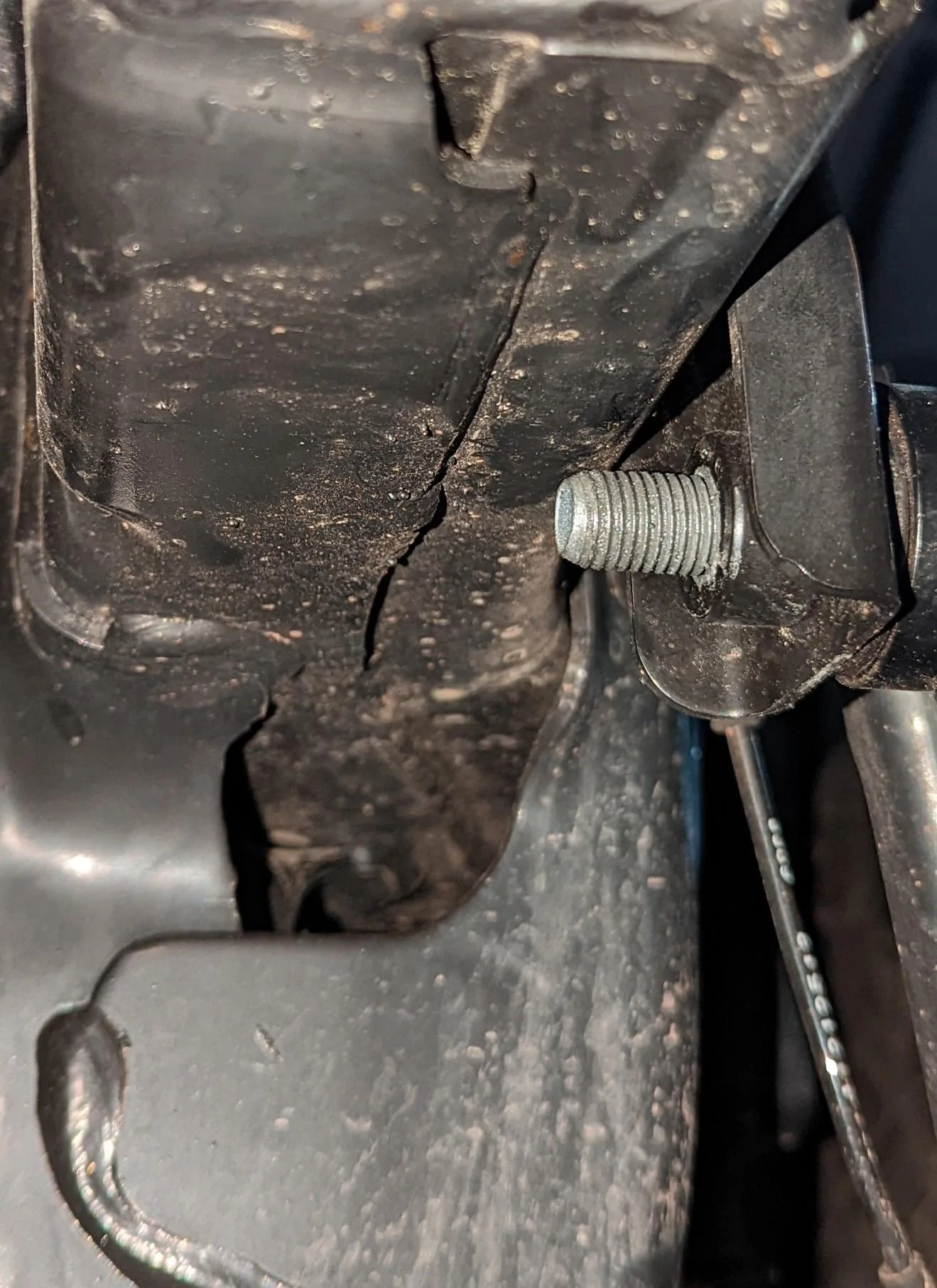

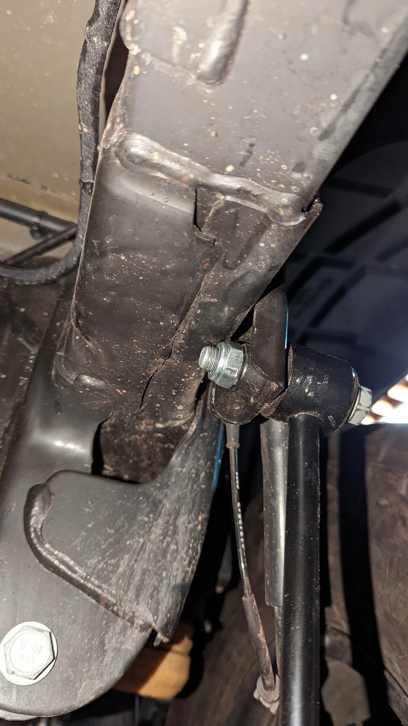

First picture is driver's side, second is passenger side. No time to measure but they are sticking out past the nut. Ecodiesel by the way. Not sure if it makes a difference. Also ordered last year March, picked up April 30th.
That's old bolt. If you back one out you'll see that the last half inch or so isn't threaded and you're only getting about half of the threads in the nut.
Yikes. Is this a warranty thing? I know bolts are cheap. But they should be fixing it. Not that it really matters. I should have my new Helwig sway bar tomorrow along with my brackets from MetalCloak as well.

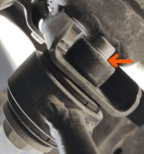

You can see the last threads on those bolts right at the end of the threaded collar. Mine are the same on a '22 Willys diesel, so no longer bolts needed. Fully threaded past the attachment collar
