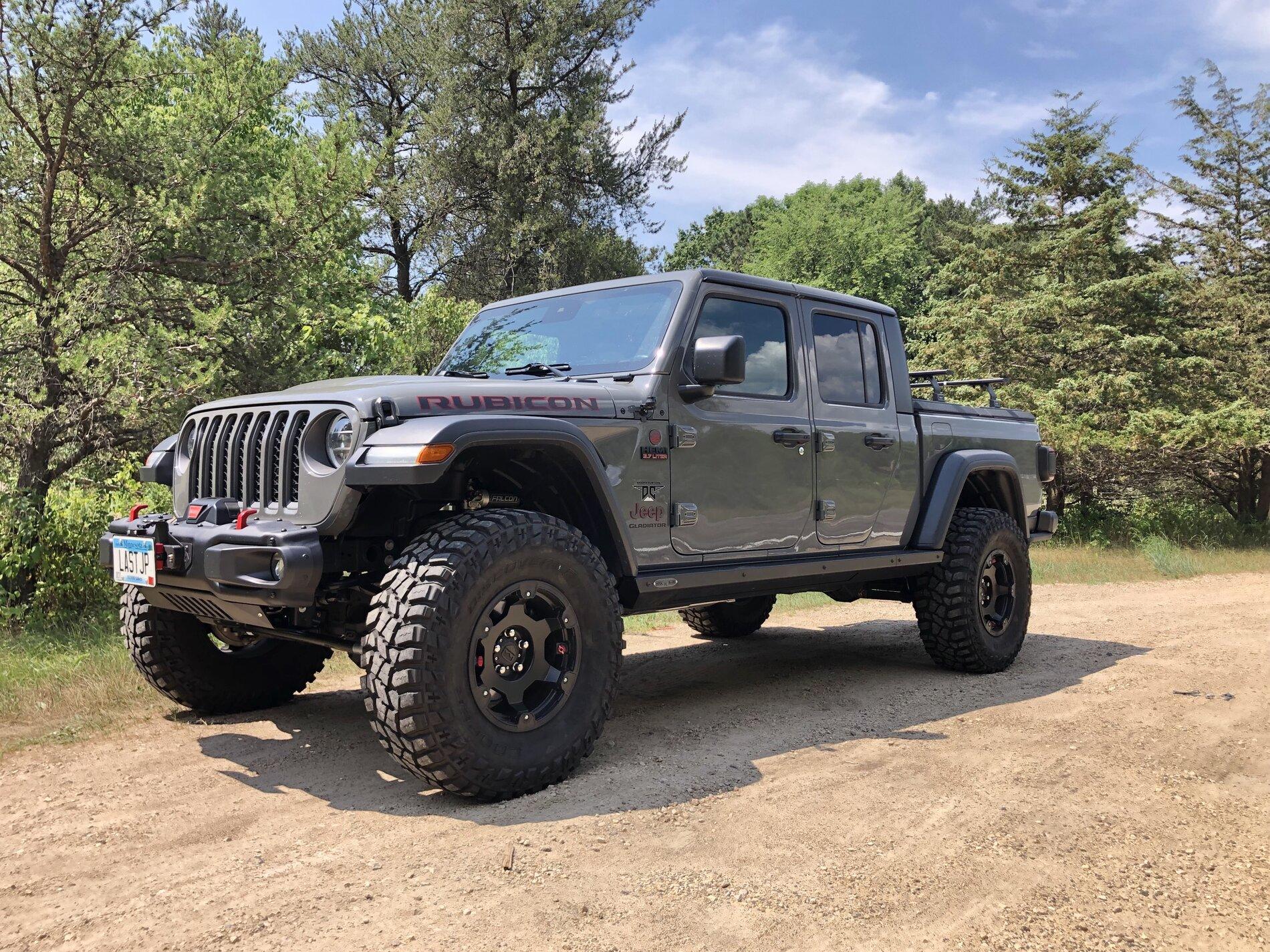

I installed the 3.5” Overland Plus kit along with Teraflex control arm drop brackets and Falcon SP2 3.3 shocks for 3.5”-4.5” of lift. Every piece of the kit is well made. Beefy control arms, nice powder coating, etc.
The ride is awesome! I’m really looking forward to my next trip into the mountains!
Question for others running this lift and shock combo……
Is it just me, or are the rear shocks WAY too long?
The front shocks are perfect. Small amount of shaft showing at full bump and brake lines and wiring still have slack at full extension.
I installed the longer rear brake lines and un clipped the ABS wiring off the frame to get as much extra length I could. I drooped the rear suspension until the brake lines and wiring we’re getting close to their limit. The coil springs fell out and the shocks were too long fully extended to bolt in. I had to compress the shocks by hand in order to get them bolted in.
If I let the shocks fully exten the brake hoses will act as limit straps.
I wish Falcon sold their shocks as pairs, that way I could get shorter rear shocks.

Falcon did make us aware that the 3.5 - 4" shocks will allow for a bit too much travel in some scenarios, possibly allowing coils to unseat. This is something we are still looking into addressing, though it does not seem to cause any sort of issues during normal driving or off-road circumstances, just when the axles are fully drooped. We highly recommend a set of limiting straps as a super easy solution to this issue, and will make sure your coils stay where they need to be! Awesome build by the way! :like:
Thanks for the heads up.
Ive been emailing Teraflex about it. I ordered their rear spring retainer kit, I’ll be installing it this weekend.
I asked if I could purchase just the rear 2”-3” shocks and they refused to. Said they only sell them all 4 at once. ?
that’s a bummer because the front 3.5”-4.5” shocks fit perfect.
I think Teraflex missed the mark on the rear JT shock lengths.
