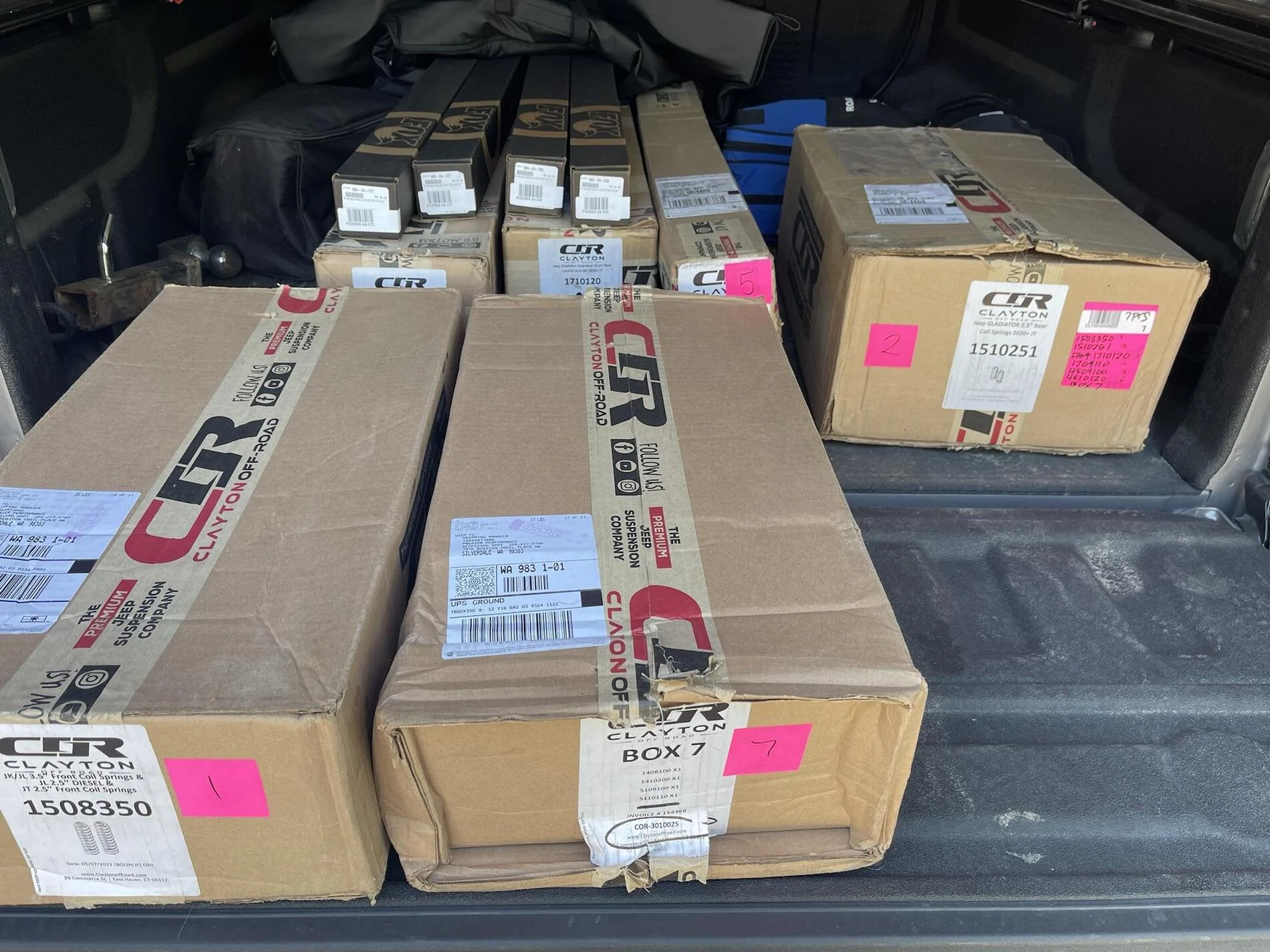

Got my stuff a couple weeks ago... Haven't had the free time to install it yet. I was going to go for the Ride Right, but ended up getting the full 2.5 Overland Plus kit. Everything seems really beefy!!

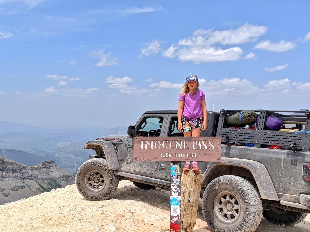

This might help you. 2.5 Overland Plus on Method 703 0 offset with KO2 315/70/17. Top pic loaded down with gear and bottom pics empty.

This might help you. 2.5 Overland Plus on Method 703 0 offset with 35s. Top pic loaded down with gear and bottom pic empty.
FINALLY!!! I have looked all over the FB gladiator pages and even posted as such asking. All you get is a bunch of folks posting 4" lifts with 38s when I ask lol. There is def some wheel gap in the front but I do not think that looks bad at all. I also have the diesel and a steel mid-width bumper so I suspect the front will be a bit lower anyways.
I could totally rock that look, and once I jump to 37s I'll still be good to go. Man thank you so much, this is exactly what I needed to see, same 2.5 overland plus lift... and it's even the same color lol.
I plan to run the Falcon SP2 3.3s, which shocks are you using and how would you say the ride is on the road and highway compared to the stock ride?
