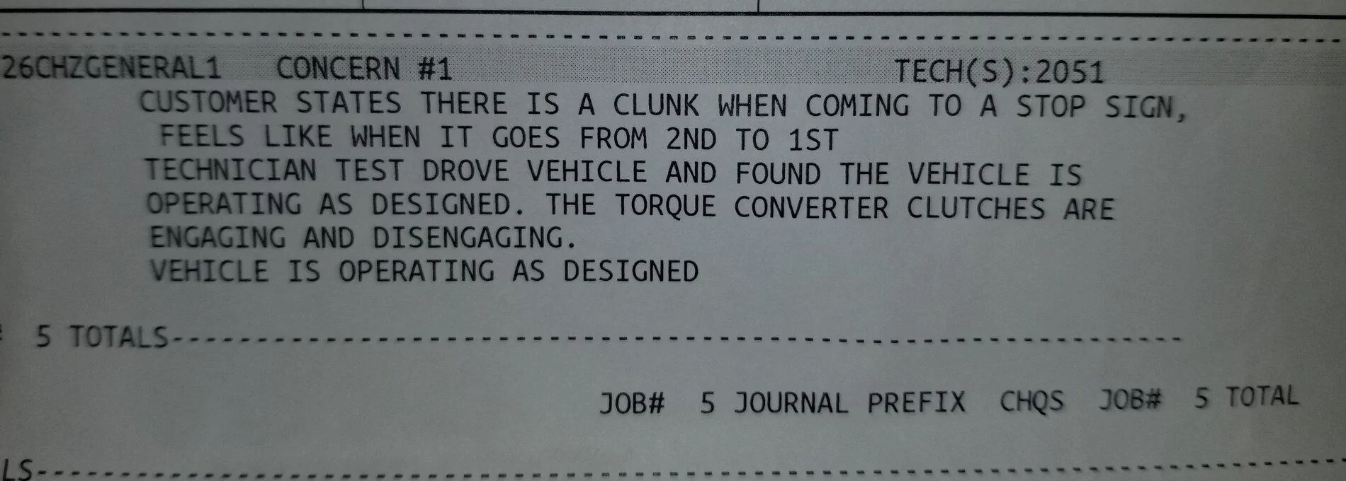

How did the dealer visit go?
Green_Gladiator
Jay
Jan 23, 2021
446
769
Daytona FL
21 Mojave, 22 NX350 F-Sport
Commercial HVAC
Disappointed to say the least ... however the mgr did say if the issue continues to schedule a return trip with one of the master mechanics ... I know it's there I felt it on my way home. Will prob give them another shot at it ....

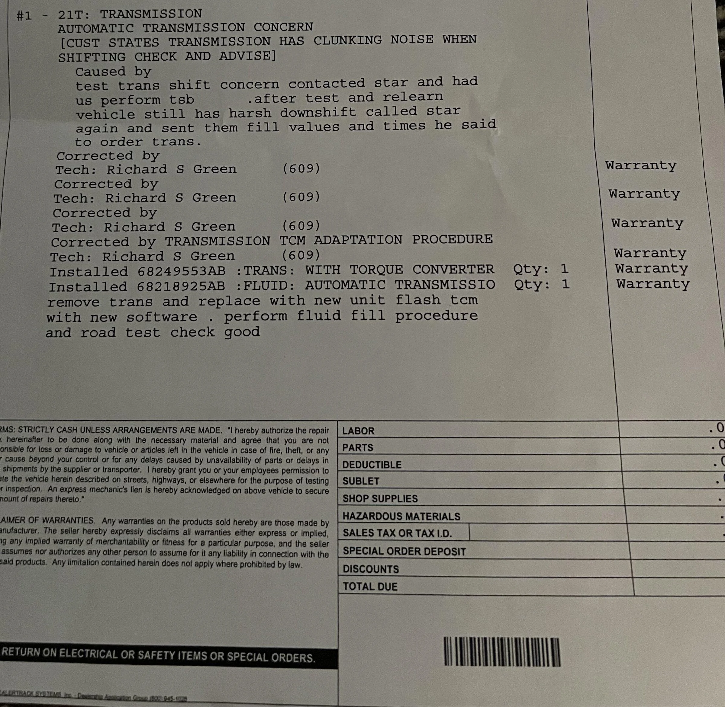

My transmission clunk saga finally ended this past week. After taking my Mojave to another dealer in late December a STAR case was created. They did the relearn procedure and asked me to drive another 500 miles so they could collect the data and see if it would change anything. So after 500 or so miles I brought it back in last week. The clunk was still there in the low gears on downshifting. Dealer confirmed with Stellantis and ultimately they put in a new trans and torque converter. I have driven it a 100 miles or so and the shifting is noticeably better. I still have a slight clunk between 4th and 3rd gears but no where near what it was before.
I’ll drive it for a while and see if things settle a little more. Just happy to have this behind me and that I get to enjoy the Jeep I purchased back in Oct 20 more.
