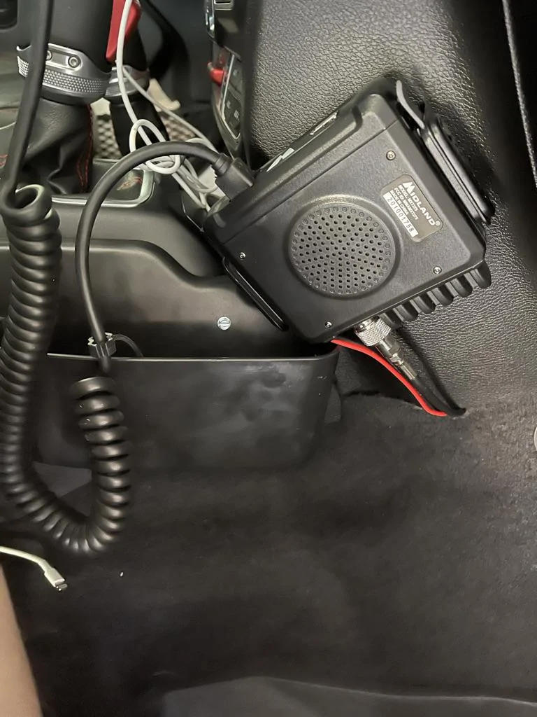

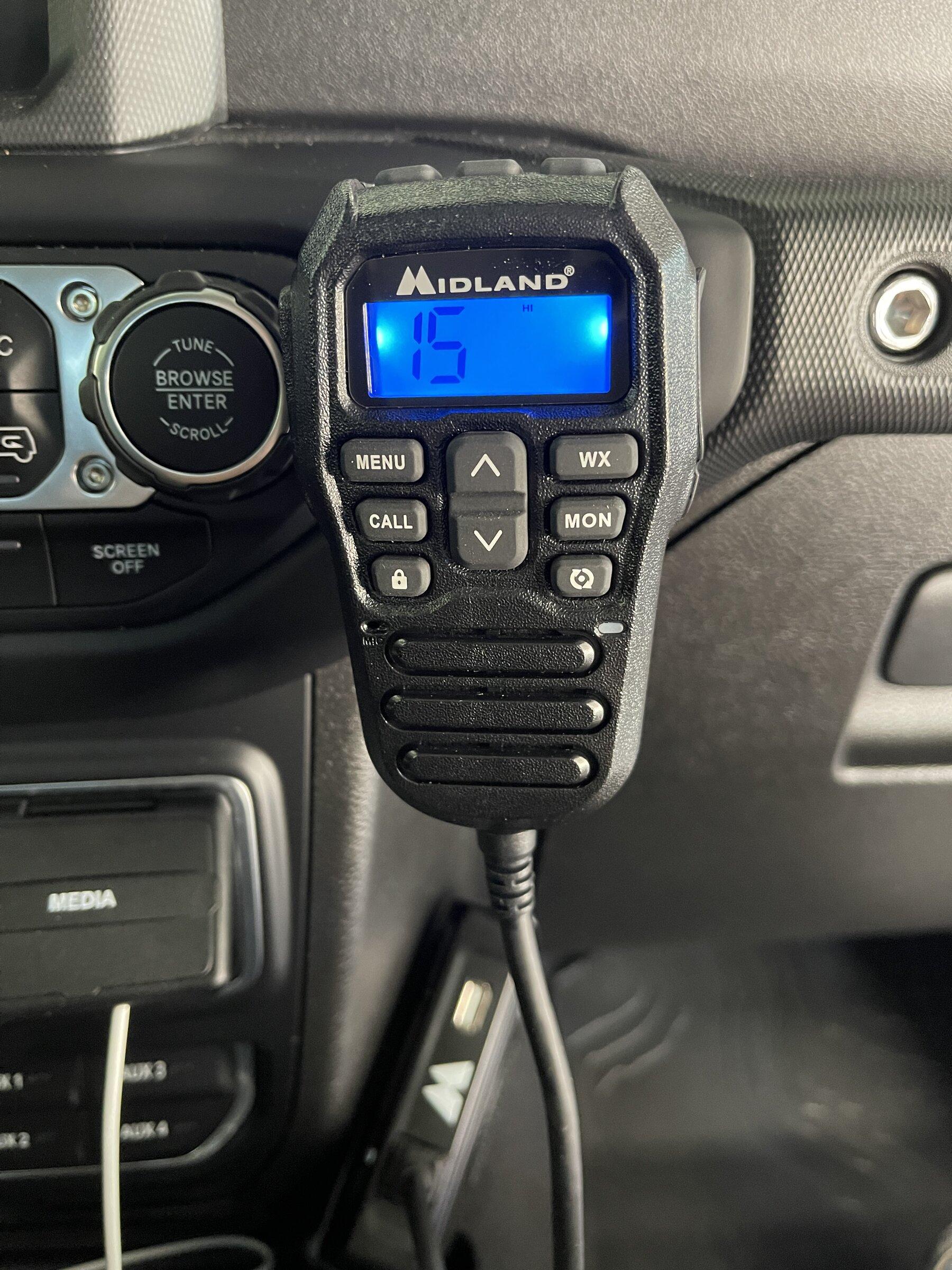

This is my setup in my Jeep. 50W BTech. Very clean setup you will not see an exposed wire anywhere except where it enters and exits the radio everywhere else it is all run behind the trim. It works super well I was using simplex Saturday to talk to my brother in law and was picking him up fine up to around 14 miles away when I'd get to a good vantage point I've heard of people getting almost twice that in open line of sight.There are a few repeaters in my area but they're down until the solar panels can charge the batteries up again. I say get your license, get your radio, get CHIRP, and get to broadcasting.
