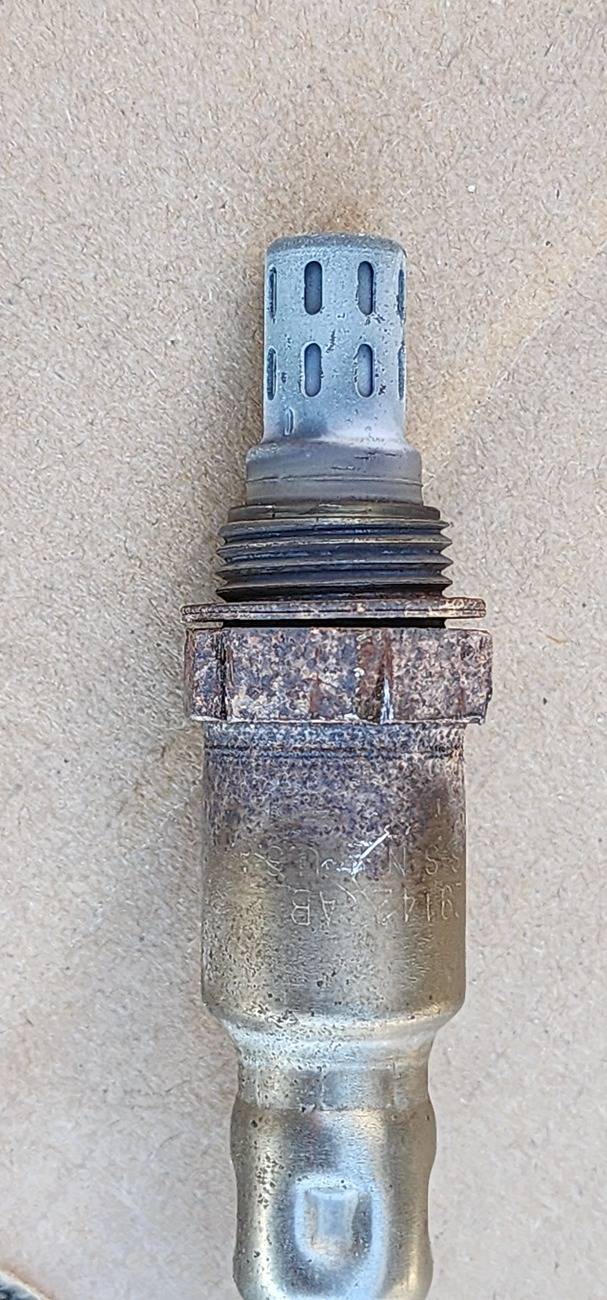

I just changed my O2 sensor today .. I will let you know going to drive 64.5 miles to work .
This is what the thing looked like .
I found this:
https://www.google.com/search?q=whi...sors&ie=UTF-8&oe=UTF-8&hl=en-ca&client=safari
Does any of this apply? Have you noticed coolant consumption?
[edit] I’m betting this is an upstream sensor in the photo? Do both upstream sensors look like this or just one side? The downstream shouldn’t look this way, right?
You could get an oil analysis done too to identify coolant internal leak or not.

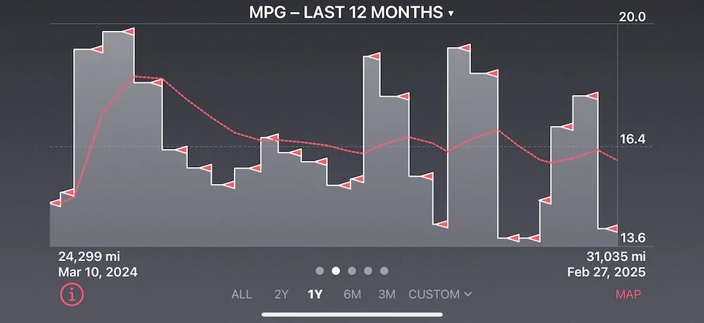

I use a app called Road Trip to track all my gas and vehicle expense. While I really don't care, it does show me if I am having an issue, I know the range I expect during the time of the year. My last fill up was just after a couple of weeks of bitter cold temps and snow. I ran my remote start a lot during that time, and MPG reflected it.

I found this:
No consumption .. I haven't done the other side upstream yet just the master upstream on bank 1. I will order the other 3 soon.
Yes that is my upstream bank 1 sensor

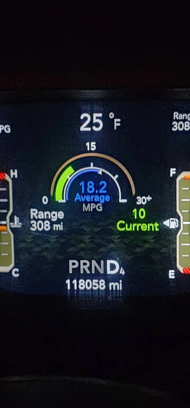

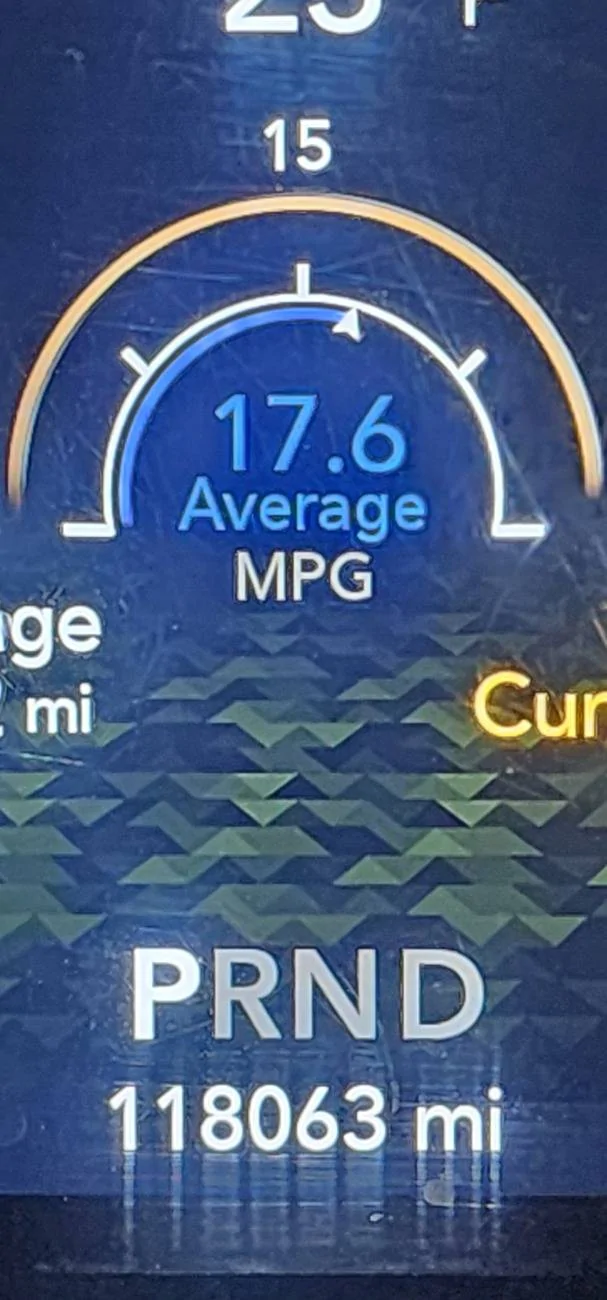

Here is what it was getting traveling and then 17.6 after whole trip.
