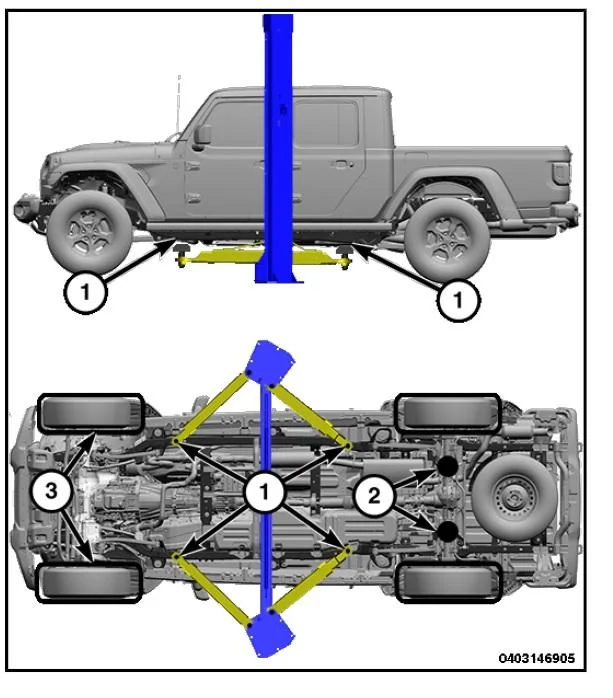

Theres no diagram on the exact point to lift from other than lifting from the most solid part of the vehicle. So dont base it on what someone lifts there truck at. You need to establish what point to place the arms on the vehicle you lifting depending on where the center of gravity. That can vary even on the same vehicle depending if you add a winch, bumpers, bed acc., hitch, even how full the gas tank is.

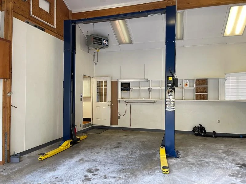

I was looking at this the other day because I wanted to look underneath my JT. I thought about just bringing it to a scale with a full tank. I have a few add-ons so knowing is a good idea. My friend with experience lifting many vehicles says to get close and that a properly installed lift can handle a little offset. Out JT's are not anywhere close to being heavy for a 9k lift, even if not center perfectly. I trust his 40 year old concrete but my 4 year old concrete has me worried. I will weigh it next week, I curious to know the center.

To find the center of gravity, first weigh your vehicle.
Jeep Gladiator Correct lift points for a 2 post car lift i-8kXXR5F-X3
MY truck (gas, Rubicon, Decked System in the back, winch and full width bumper in the front) has a small weight bias towards the front (2780/5360 = 51.9%). The wheelbase on a Gladiator is 137". Measured center would be 68.5" from the center of the front or rear or rear hub. The COG should be 137x.481=65.9" (from the front wheel). In the real world, 3" is not a big deal. Center the vehicle and push the pads out a far as you can as long as they are equal distance from the post.

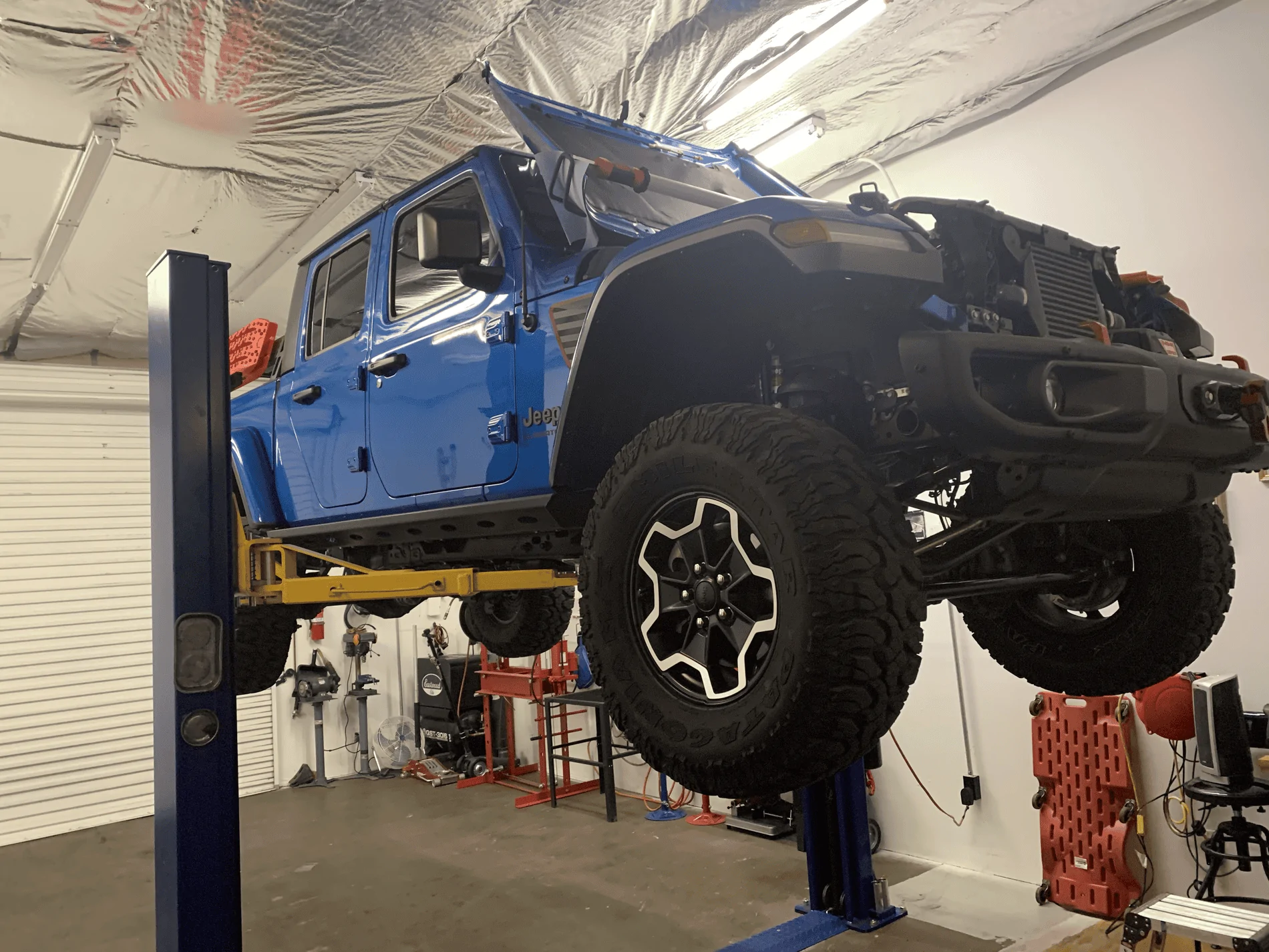

I have a similar lift . I spread the pads apart as far as possible, then lift the wheels off the ground a few inches and check for stability.

Agreed, but with the smart cap and a freezer mounted in the bed, I thought finding my center weight would be playing it safe. I was not at home when my concrete was poured for my shop. But I have seen another slab fail just by parking a car on it. Owner said that he thought the concrete company added too much water to make it easier to work with. I suspect my concrete company took such a short cut.
Starting out balanced is one less thing to worry about.
