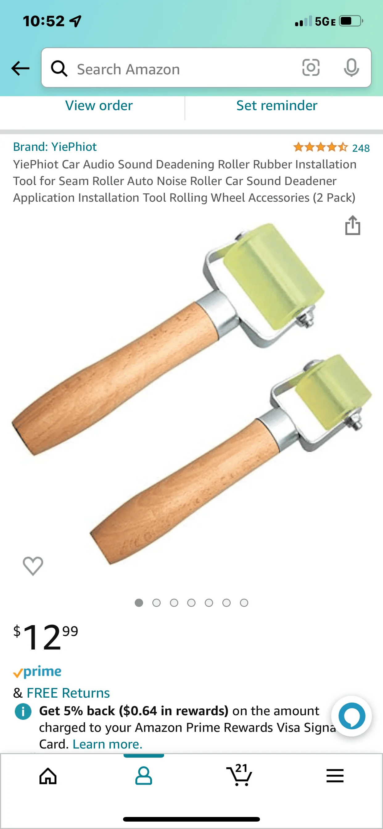

I got mine and will get it installed tomorrow. I ordered the same Kilmat , 3M tape and rollers so I hope it goes without any issues. I’ll post back when it’s done.

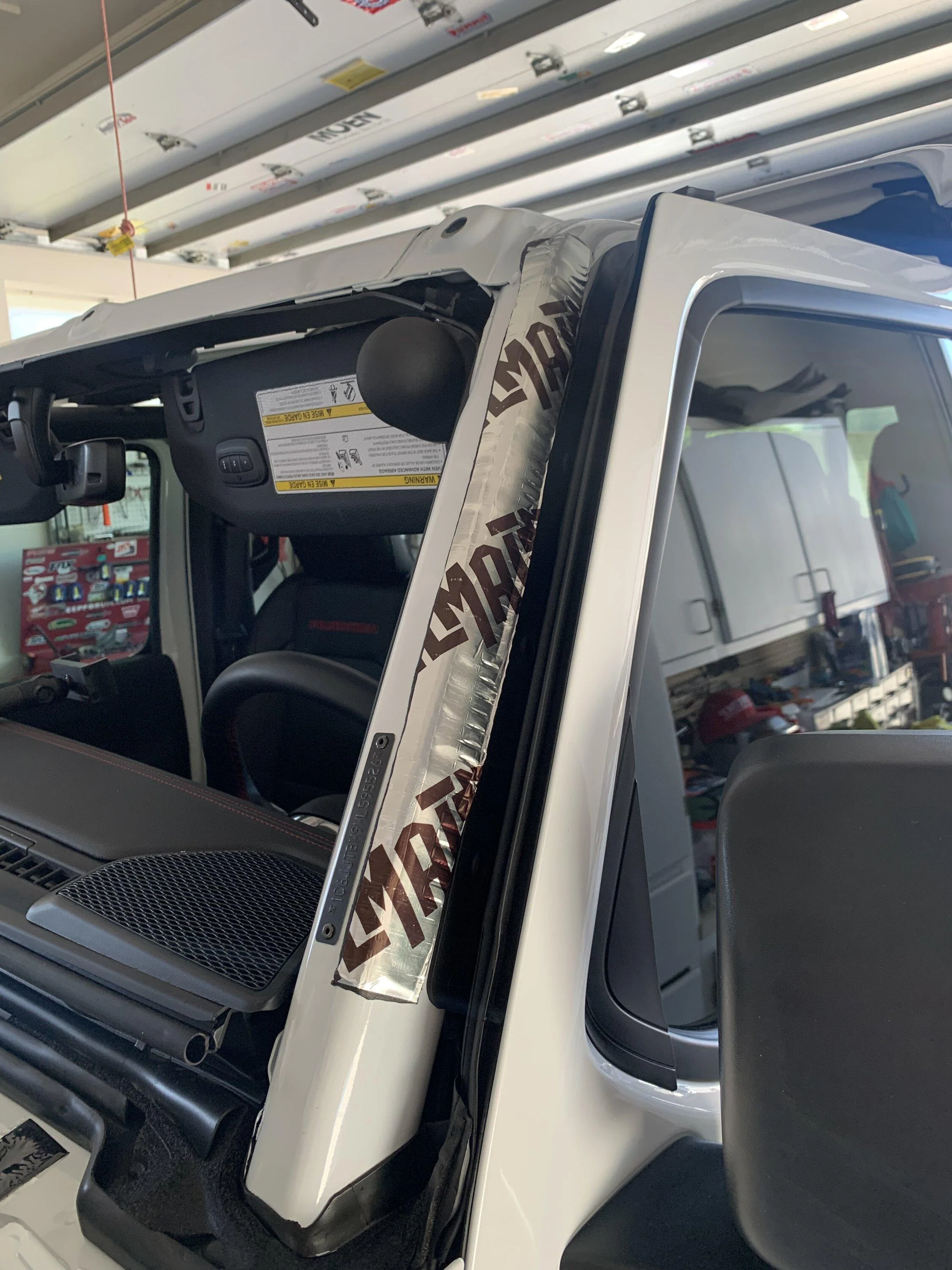

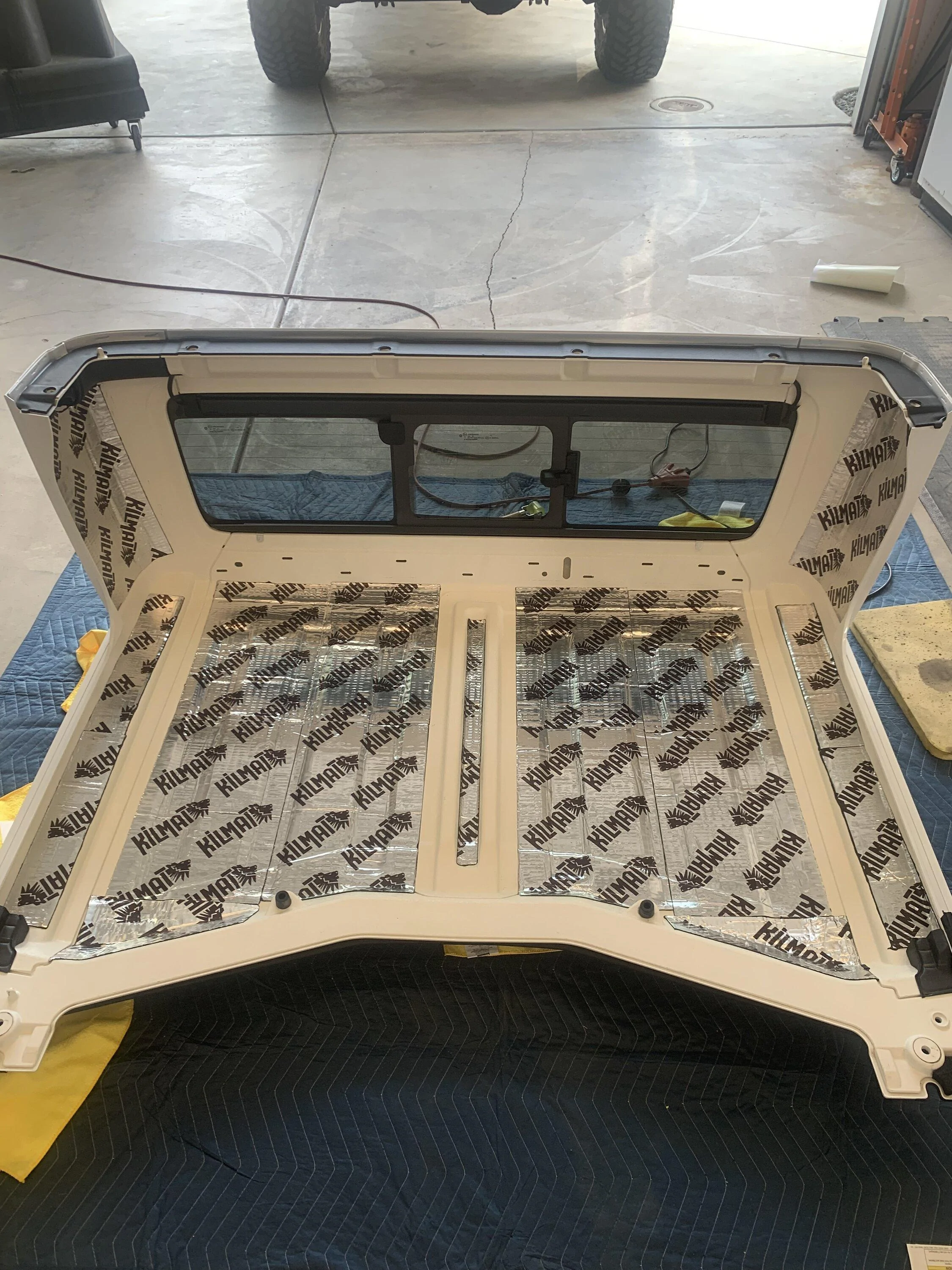

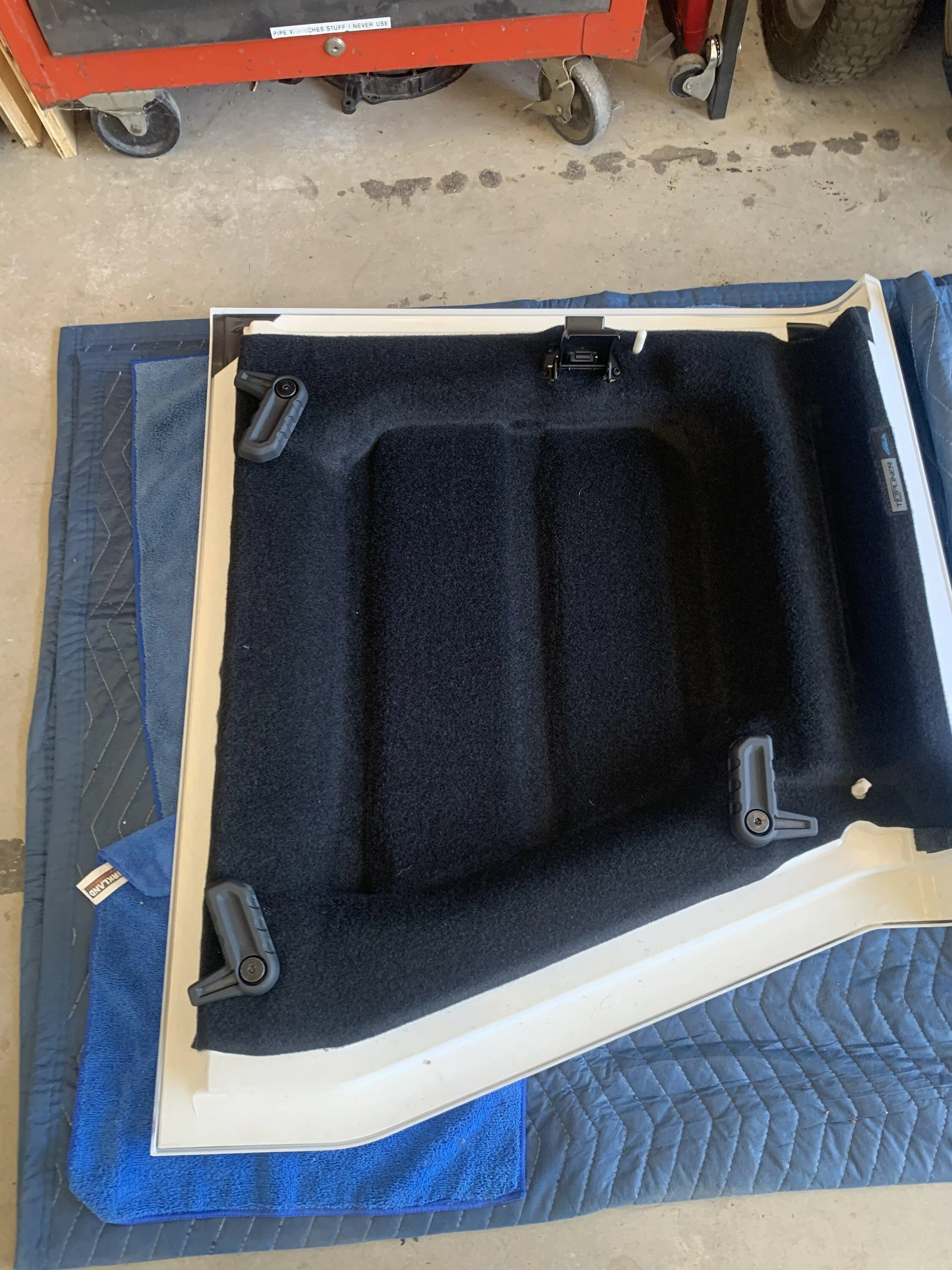

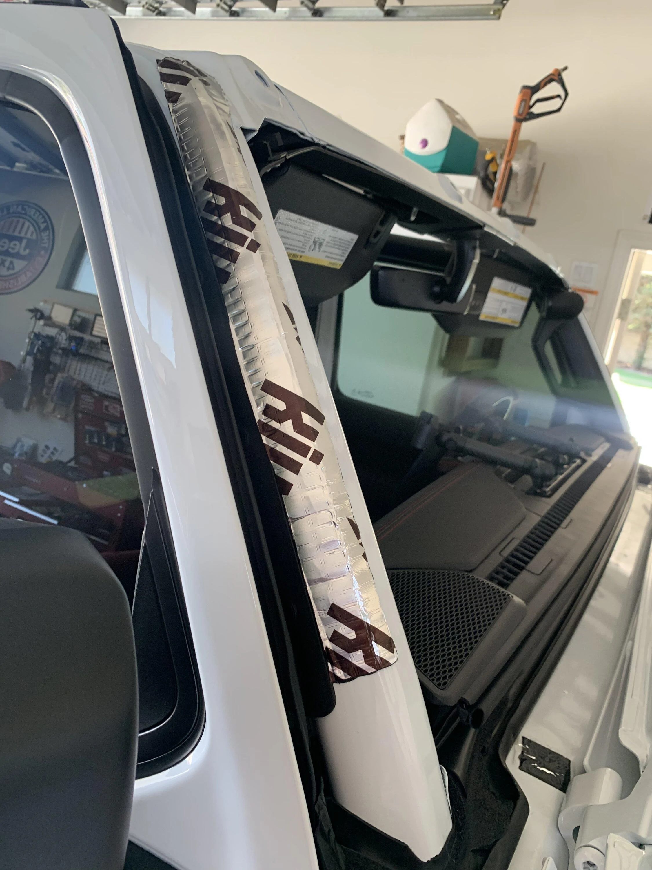

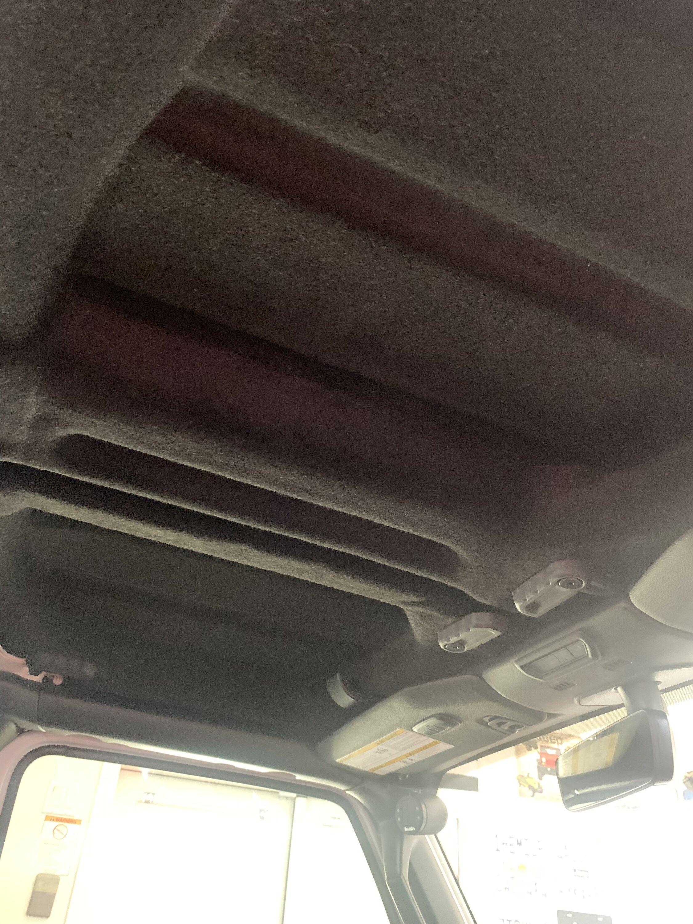

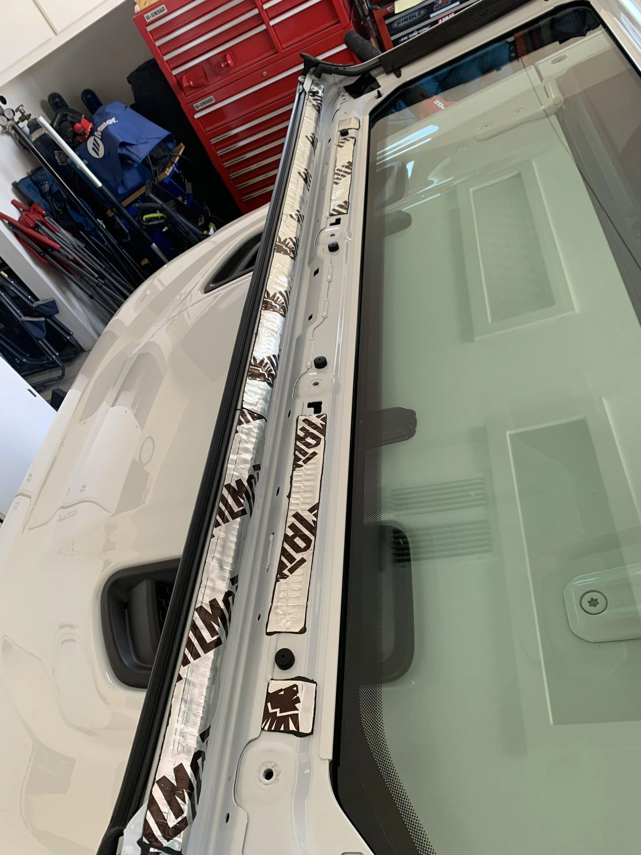

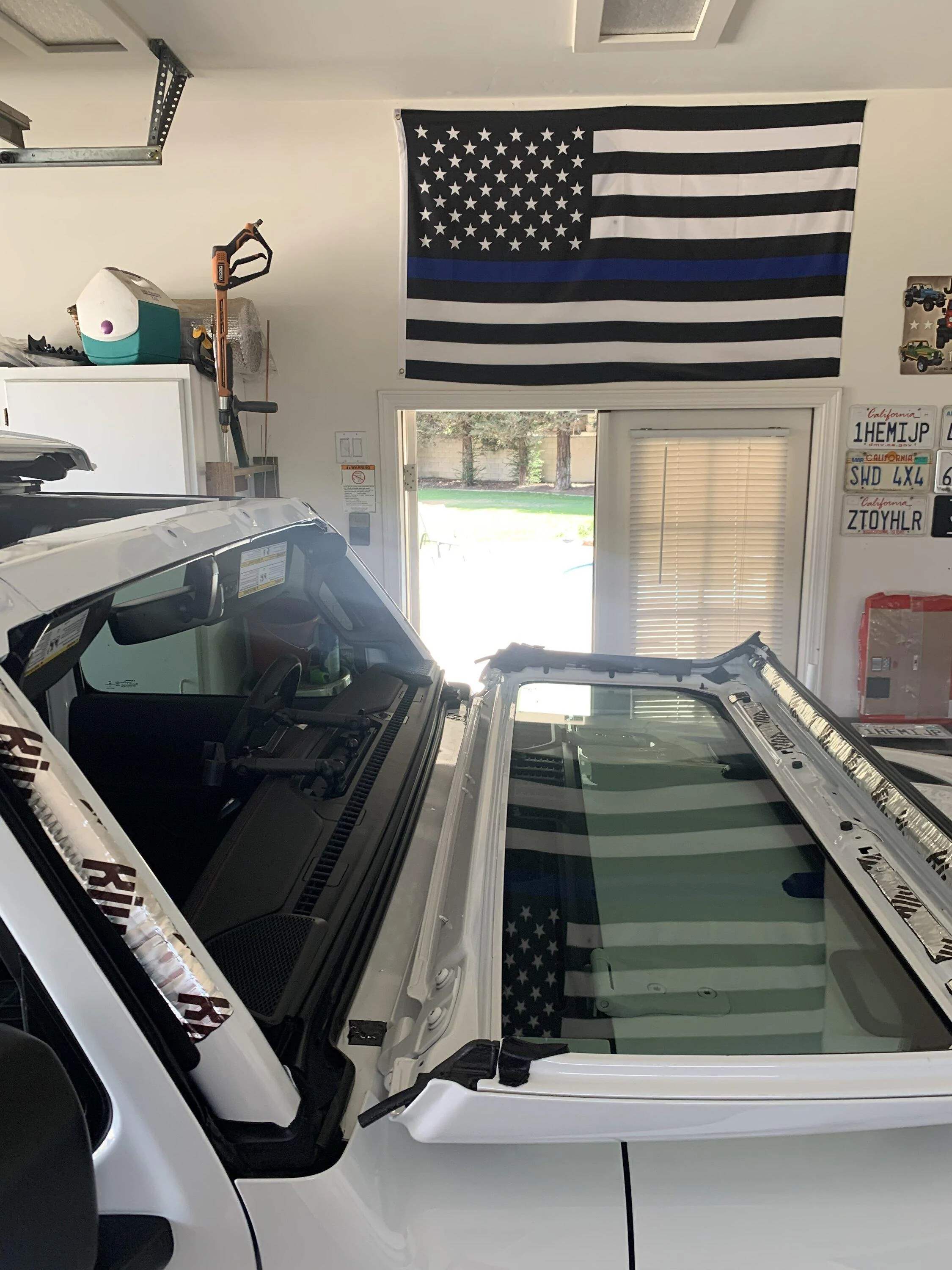

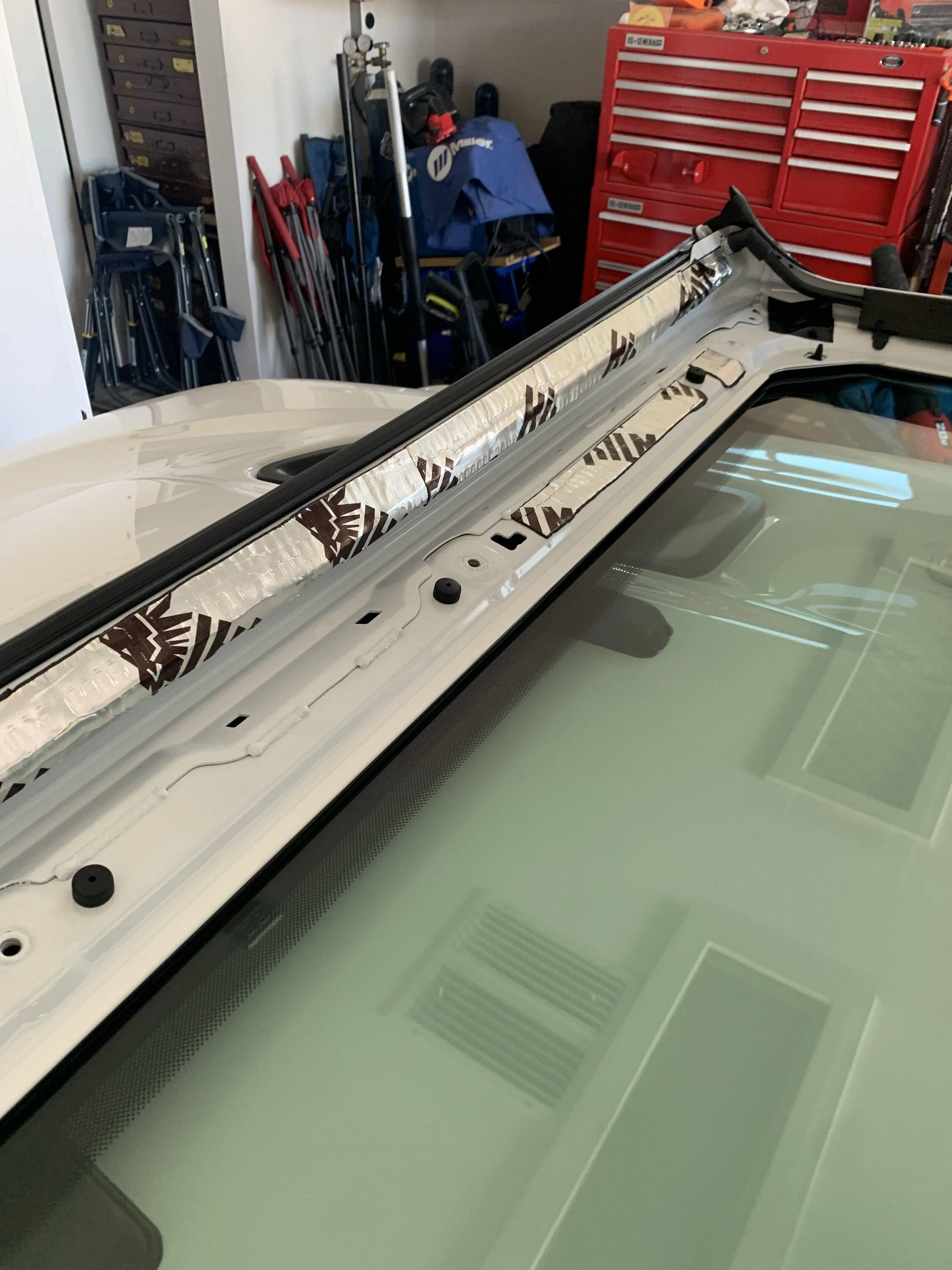

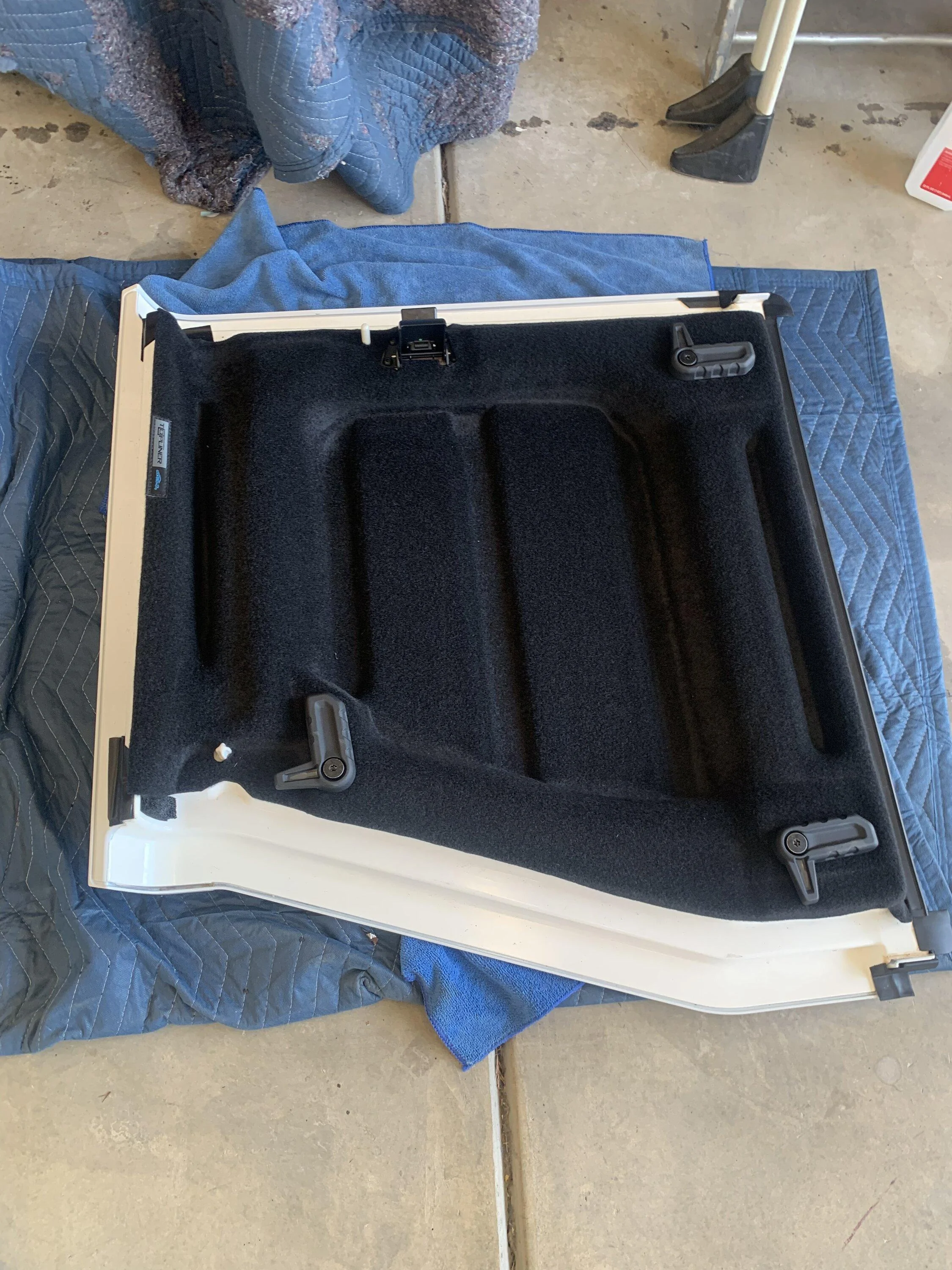

So I got part of it installed. I was sent an adhesive kit for a JL by mistake and they are already taking care of that and sending out the correct one. I did finish the front panels and the install was easy. The fit and finished look is outstanding. I added the 81 mil thick Kilmat sound deadener which had no effect on how the headliner fit. The Kilmat was pressed on, warmed up with a heat gun and then rollers were used to flatten it out. The headliner glued on right over it. As soon as I get the adhesive kit I’ll finish the rear. I also layed the windshield down and added some of the Kilmat around the frame to attempt to further quiet down some of the wind noise. Being bored and watching YouTube is sometimes not a good idea. I’ve attached some pics.

Great job, very clean install. Literally looks like a factory option from the pics. I ordered the CK in black purely for aesthetics. Any other benefits are a bonus.

what's the review of the Kilmat around the windshield? intrigued by this idea
Well, I’d say it helped just a touch actually. I did it to see it it really would make any difference. I figured it was simple to do and couldn’t hurt. The biggest improvement by far was the Kilmat and the headliner. I’m very happy with the results there.
