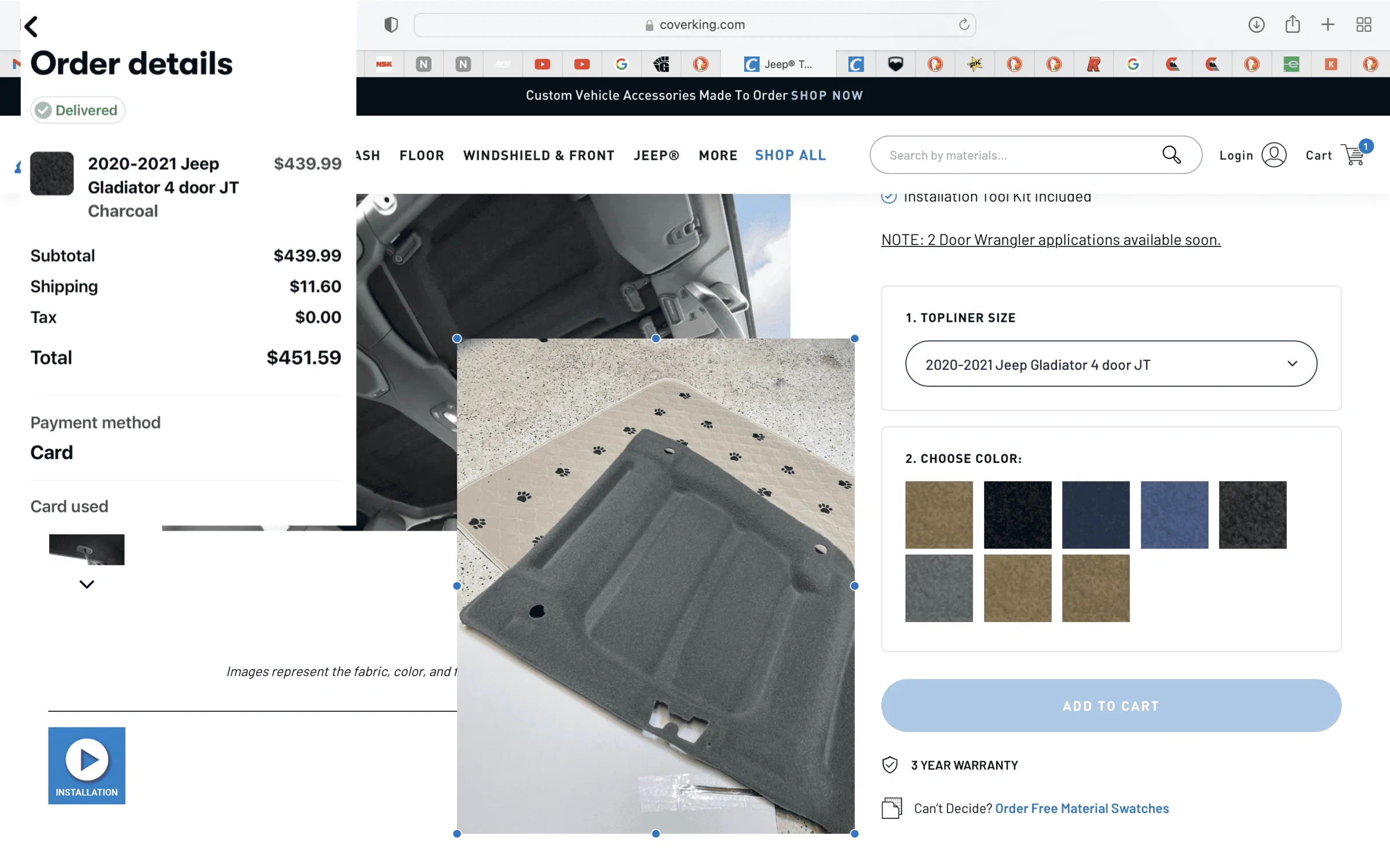

Just receive the top liner for my JT. I think the product is great but dealing with the company after words, I regret getting this. They sent me Grey but I ordered Charcoal. They are unwilling to assist with any changes in the order and said no exchanges. So I guess Im stuck with a $450 top liner I don't like the color of. See for your self in the attachment. Looks pretty cut and dry to me. After asking about getting swatches they said sure you can. So went back to the web site and its not available.
Sorry to hear that. I really like this product but the execution is crappy. They gave me the same runaround on swatches and I feel like I even got a little snark from them until I sent screenshots and was like - so where is the option to get topliner swatches?? lol. They then volunteered them, but it's still not an option on the website.
That sucks. I was told specifically when I called in that most jeep owners who order charcoal call back saying they received gray and was highly encouraged to order black, so I did. The UI and photos on the website seem pretty off.
No way you should have to deal with such nonsense.
