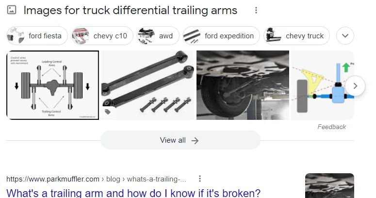

Yes - they don't know the terminology. Trailing arm is often used to talk about the arms locating a differential. While we call them control arms, with others, that is not what they are called. Trailing arms, leading arms, often used to describe the arms holding differentials in place.
The guy is a TRUCK guy, or has worked with racing suspension, etc.
Frankly, I was surprised Jeep people call them control arms. Control arms are on IFS LOL. We've always called them trailing arms on trucks
