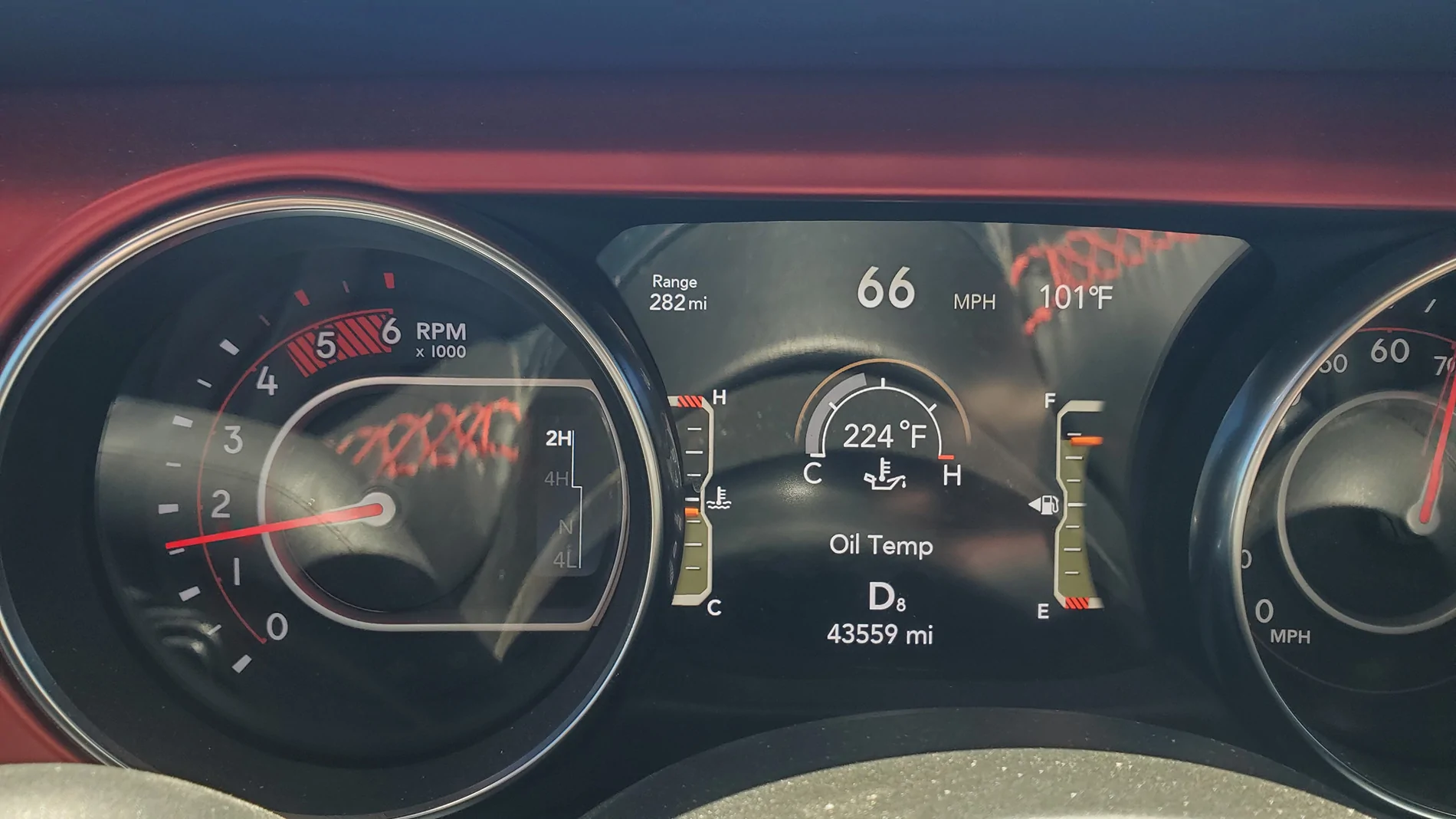

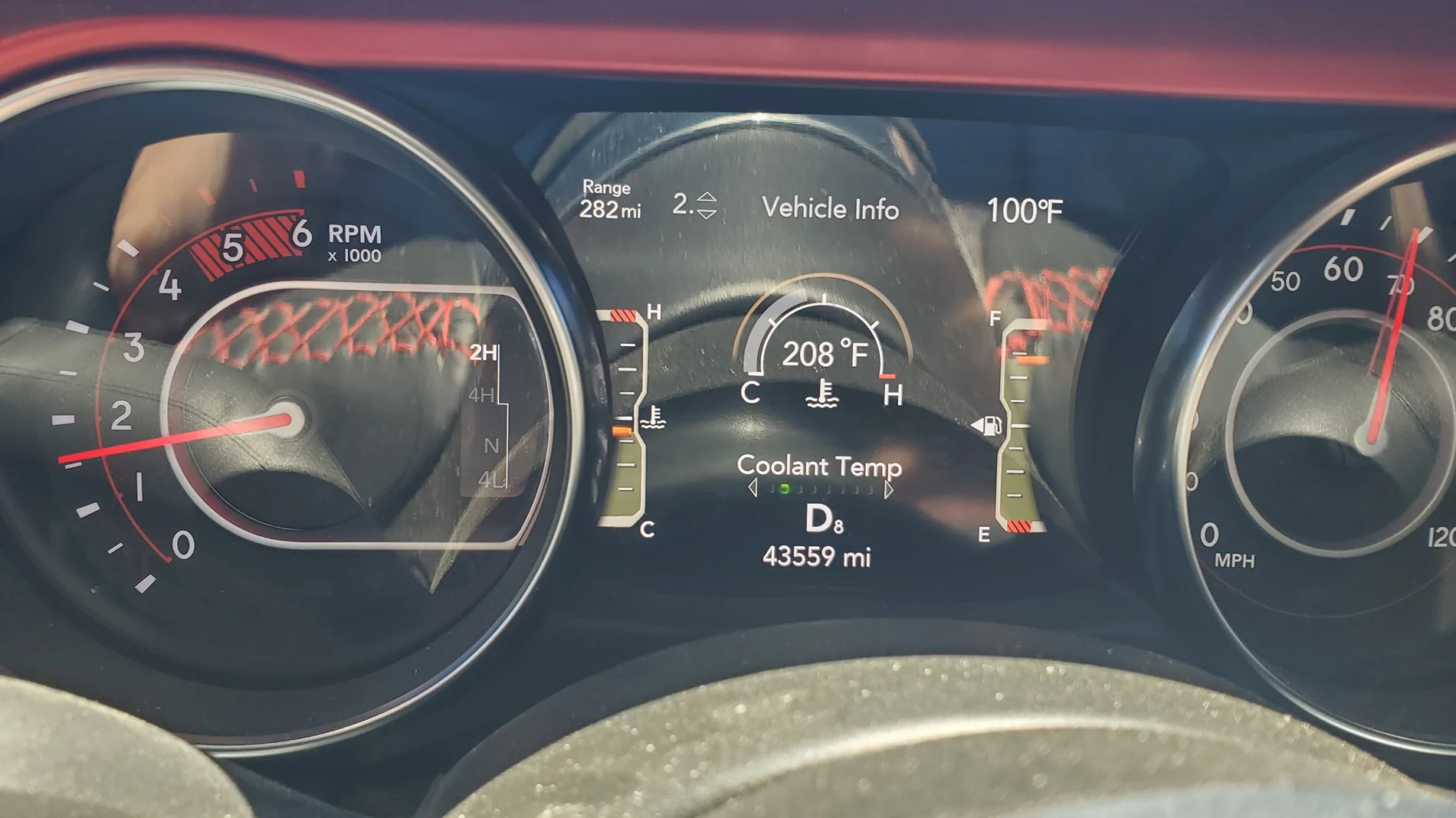

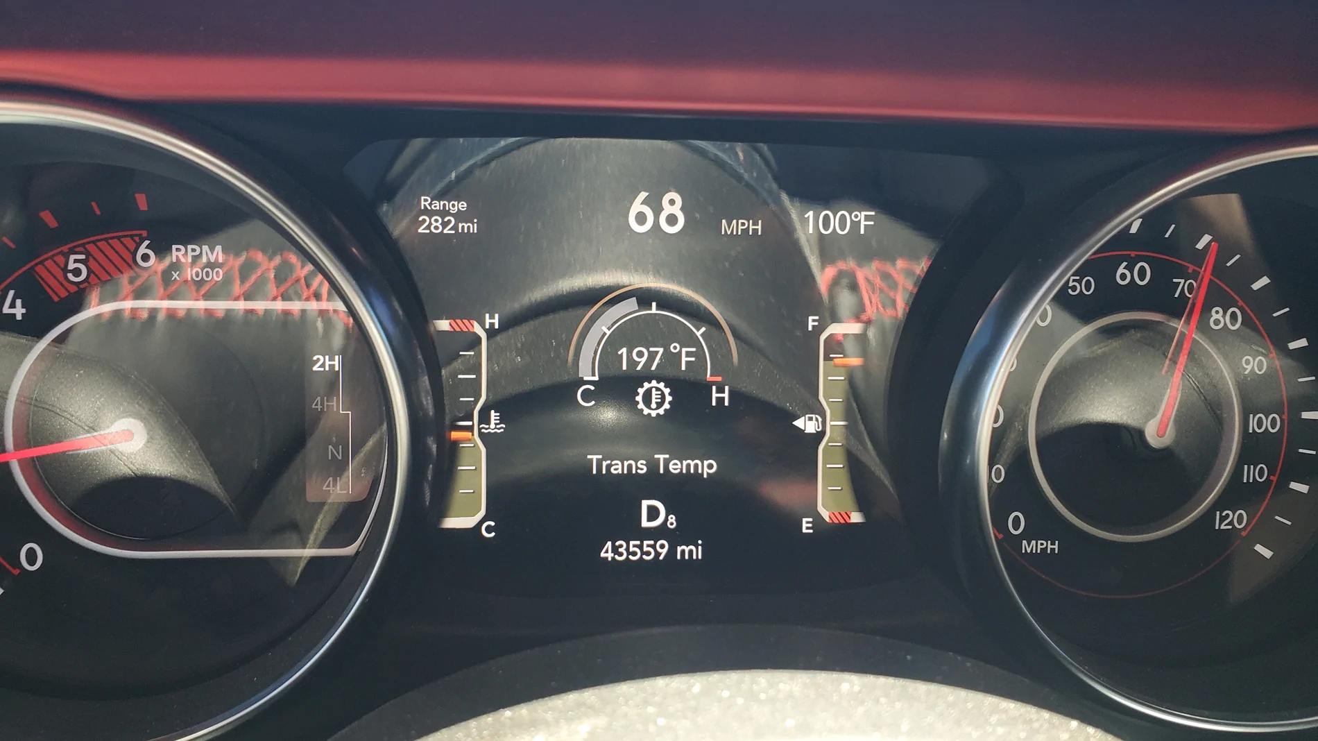

Got the CSF Radiator and trans cooler installed and removed the Horns, never use them.
Want to thank Chance575 for posting about this mod.
We have been in the mid 90's and it does help, takes longer to get to 220*+ and will cool down faster. I still use the Tazar fan on option as 6*+ grades 7k+ lbs 38's etc going 70mph makes some heat.

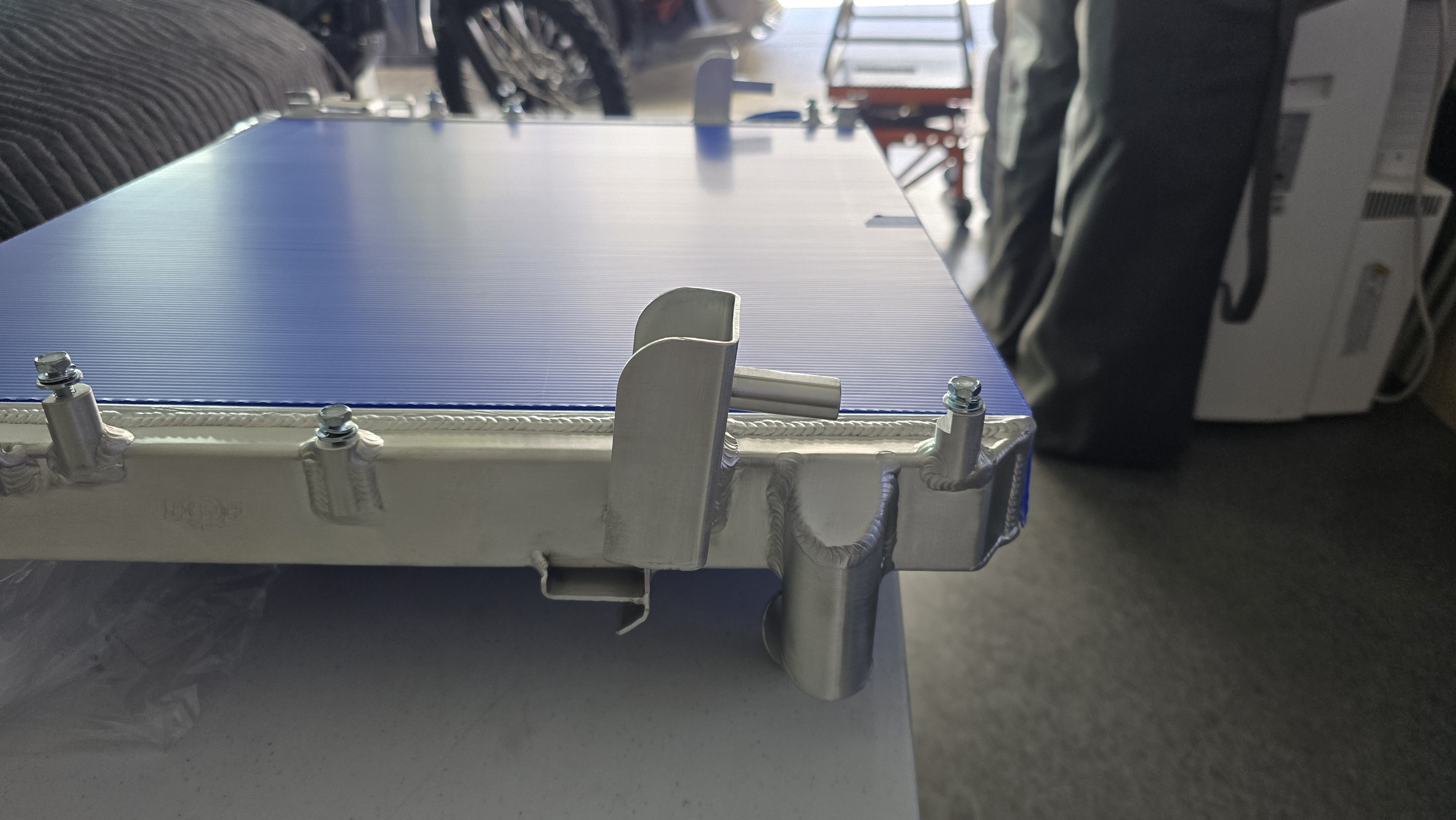

@caryt Quick question. I noticed the left and right mounting bracket/posts on my CSF radiator are at different angles. Hoping this was not some sort of manufacturing error. Do you recall if your radiators mounting posts were welded it different angles?

Looks tile yours skipped QC so let them know, hope you didn't start the disassembly.
