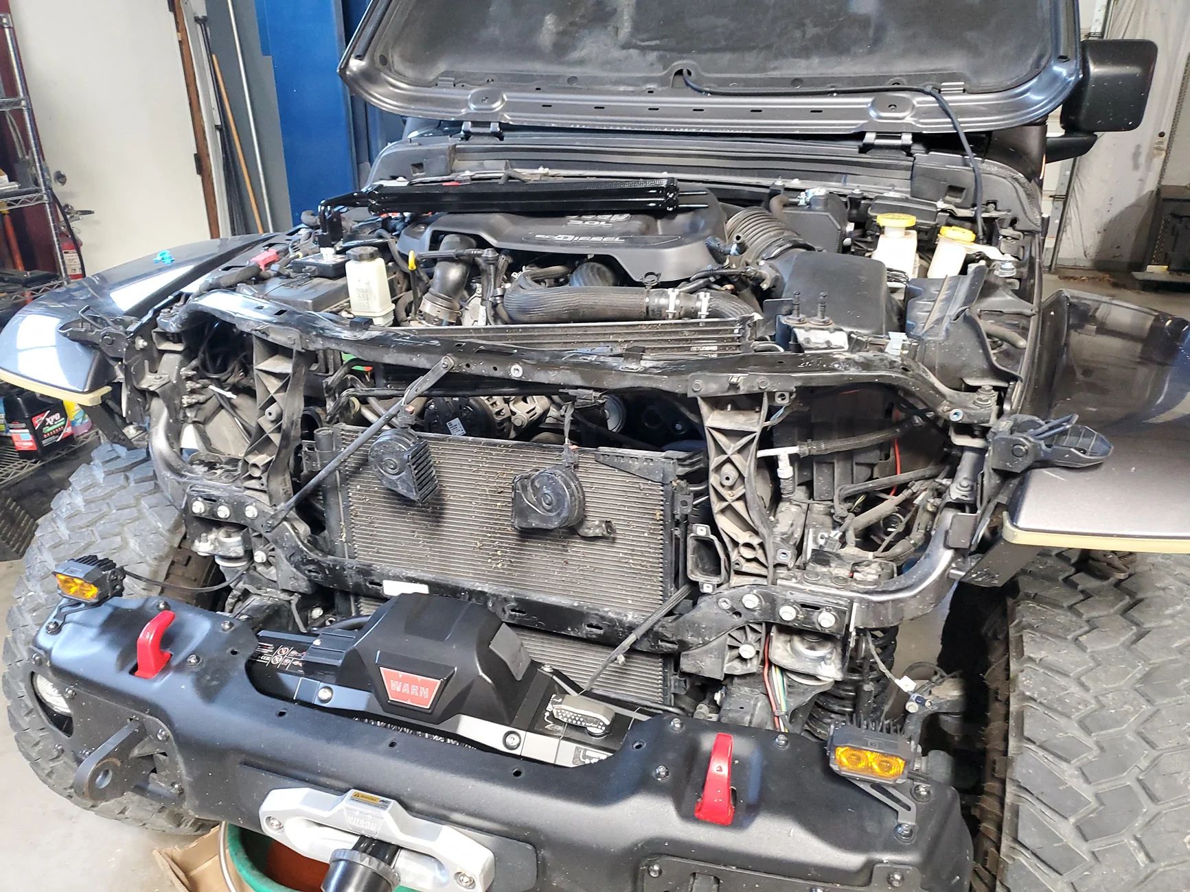

unfortuanely pictures in first post are dead.
I was told several times the trans rad does not fit....

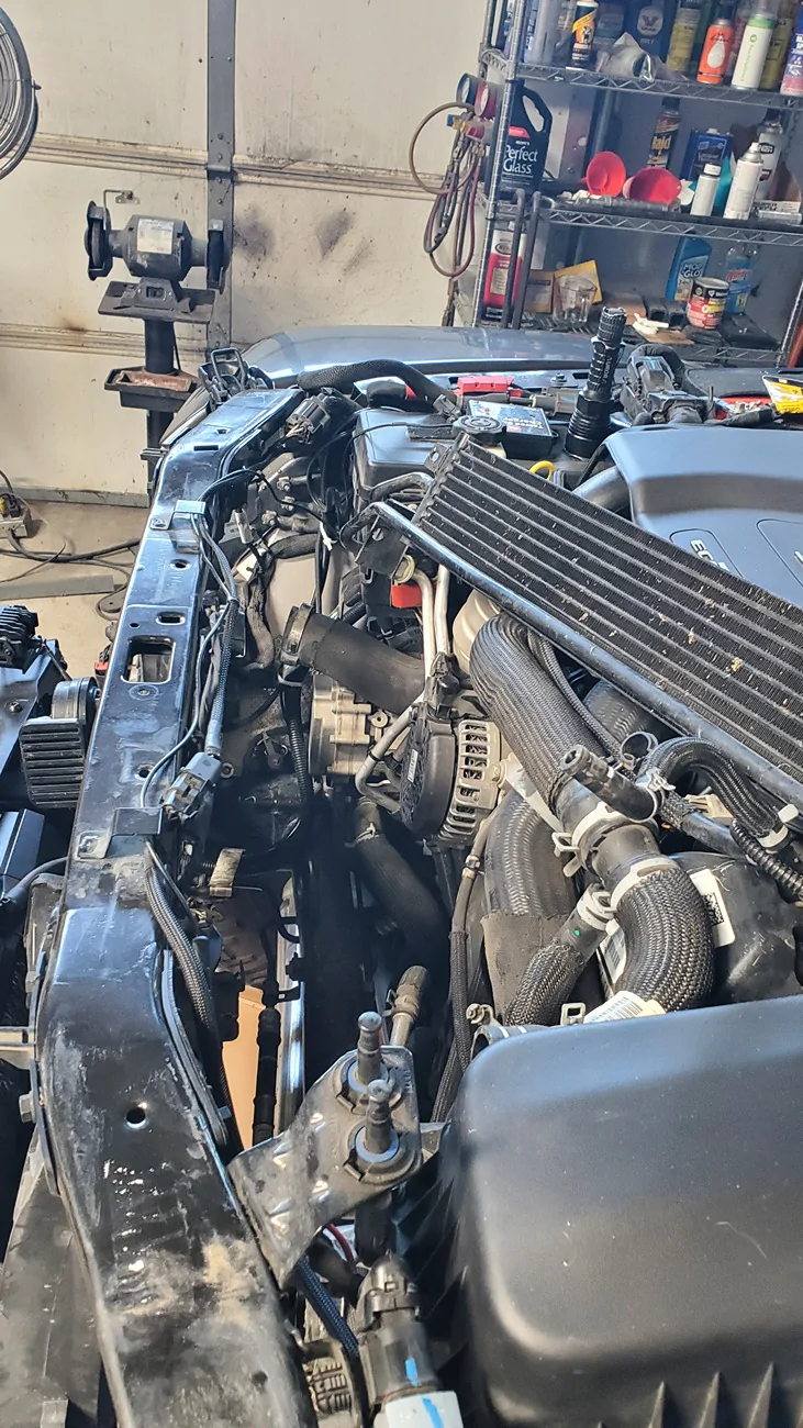

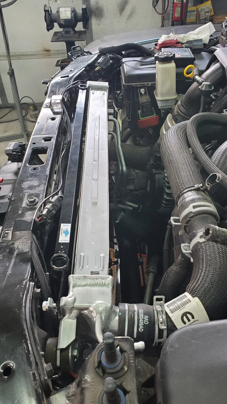

The pictures work for me.
Whoever told you that the transmission cooler does not fit is wrong. I have CSF's radiator and trans cooler installed in my '22 Gladiator EcoDiesel right now.

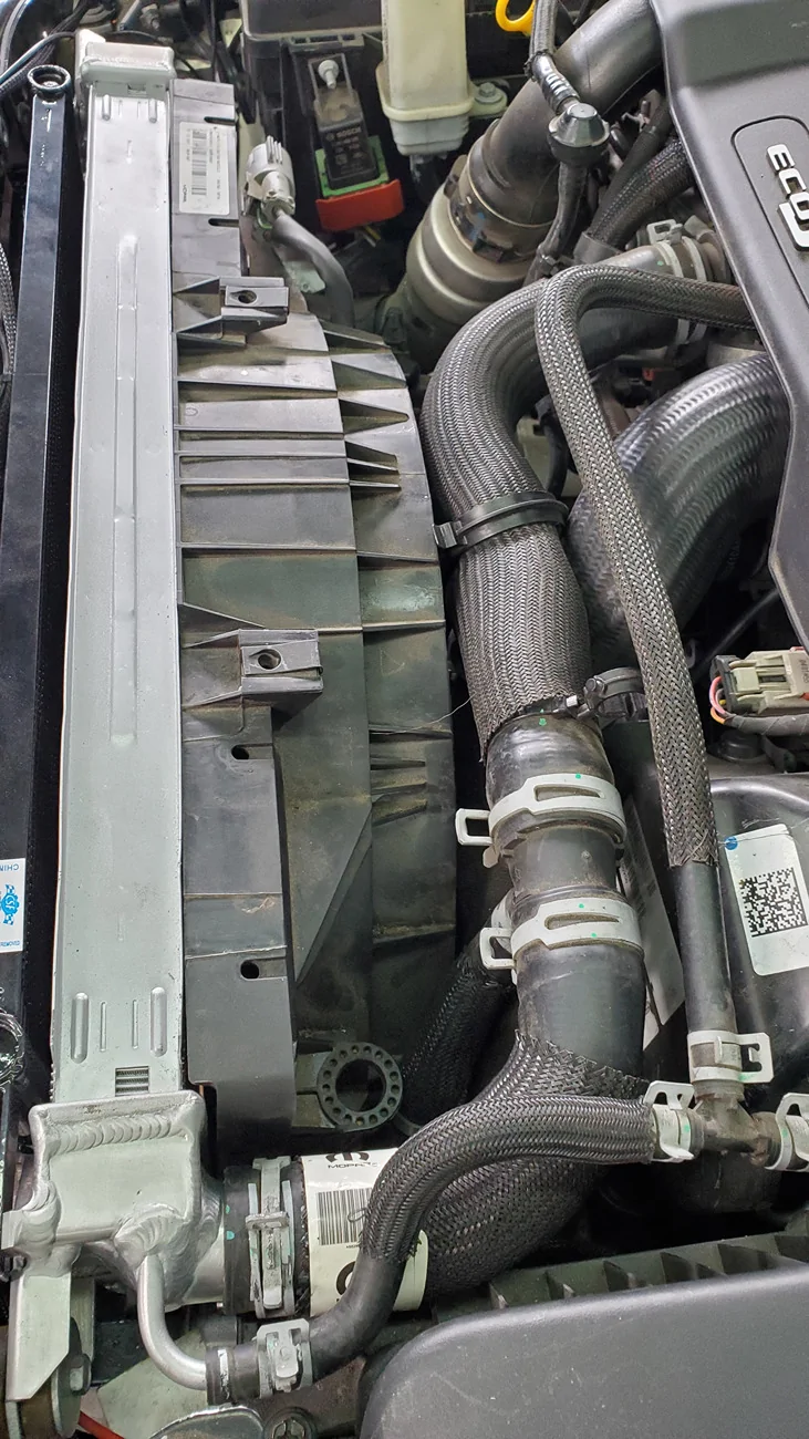

Is it possible to only install the trans cooler?
Are there any lines for the oil transfer that are needed?

The transmission cooler is a direct bolt-in replacement.
