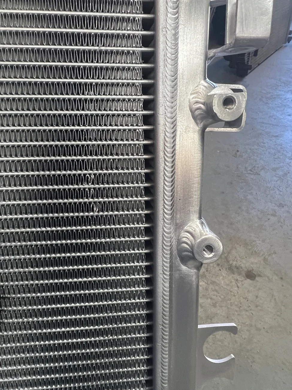

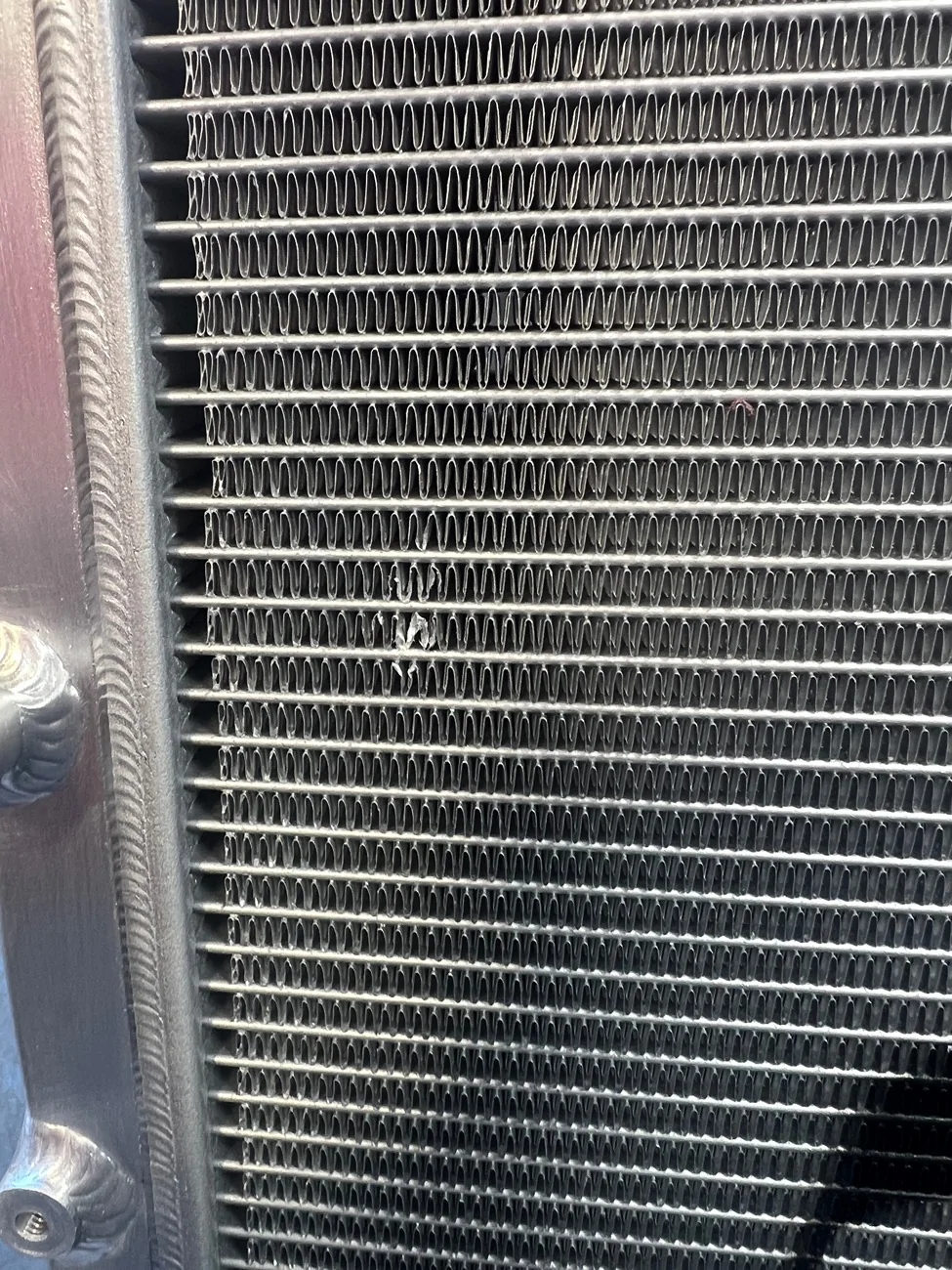

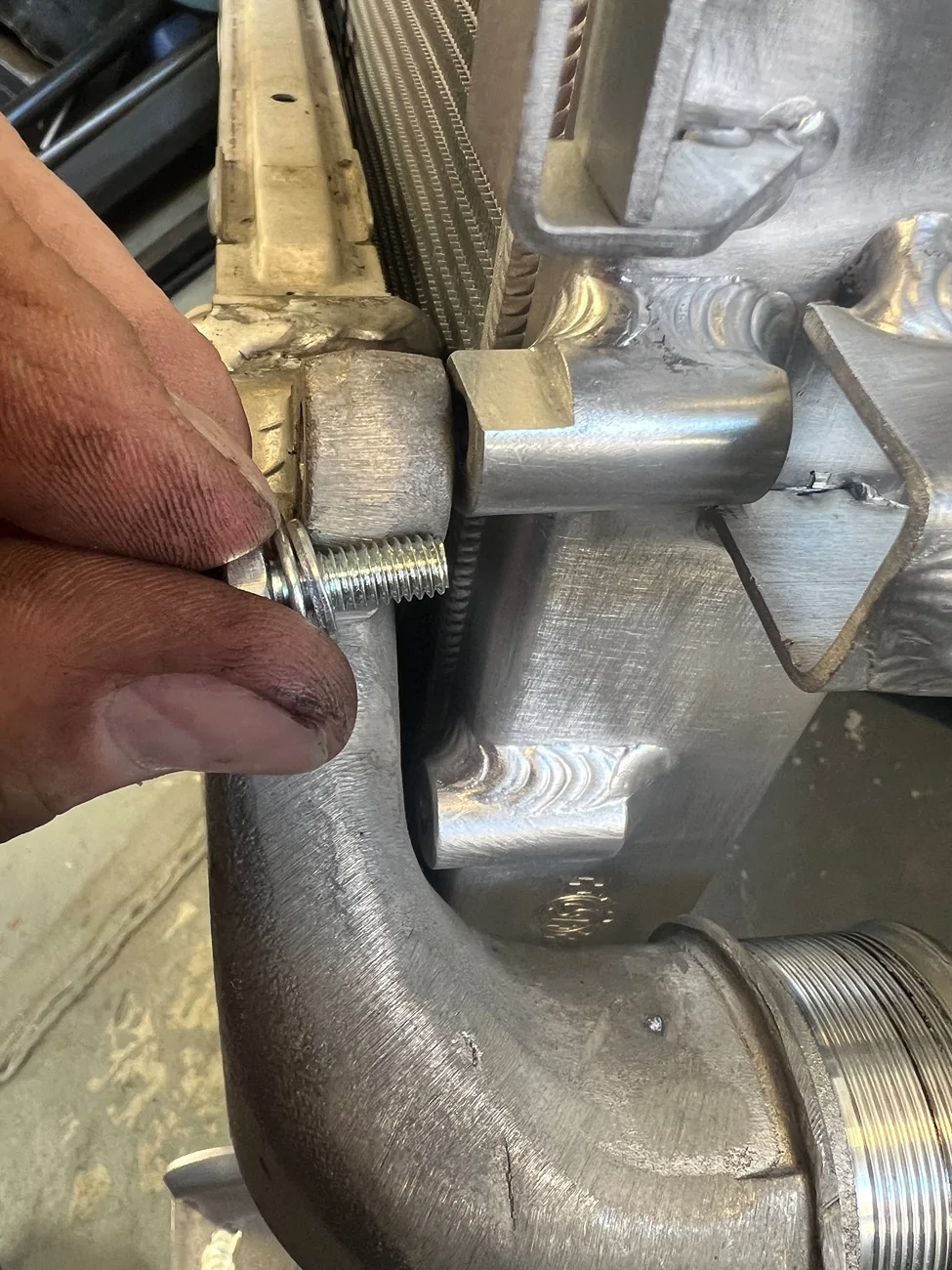

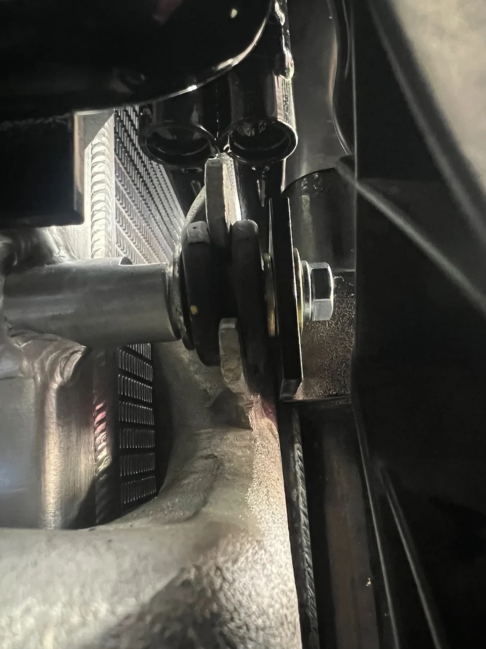

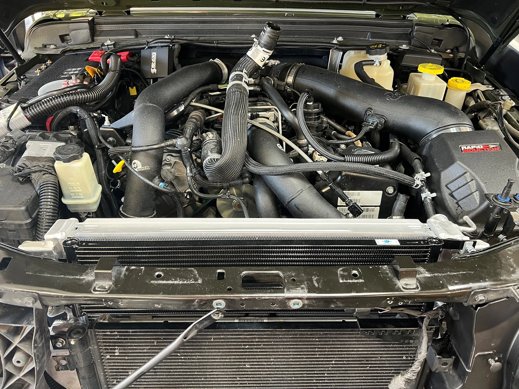

Start off by saying you’re gonna need to buy some bolts and washers for an install on the diesel. I used some M6x1.0 30mm long bolts and many washers (m6 and 1/4 standard and fender style). They give you short one which are probably fine for a gas install. The intercooler hit the radiator bolted directly to it and the a/c condenser hit the intercooler. I had to use washers as spacers with the longer bolts in between each item. The radiator cover doesn’t fit with the trans cooler with out some trimming. Also if you have some sort of hood lock it may not work with the trans cooler. I have a Lasfit lock and it will not work. The extra row on the cooler hits it. Pics of the short bolts and where the intercooler hit the radiator.

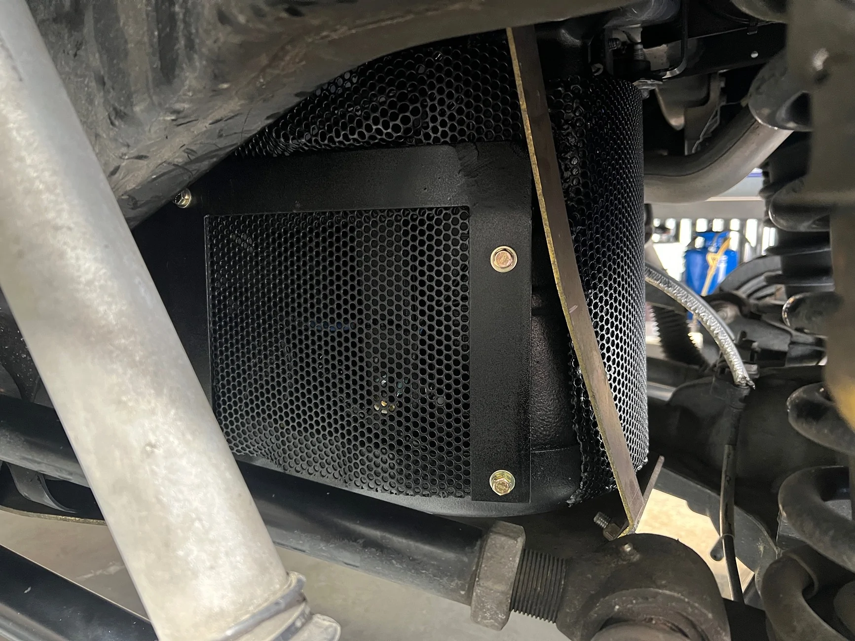

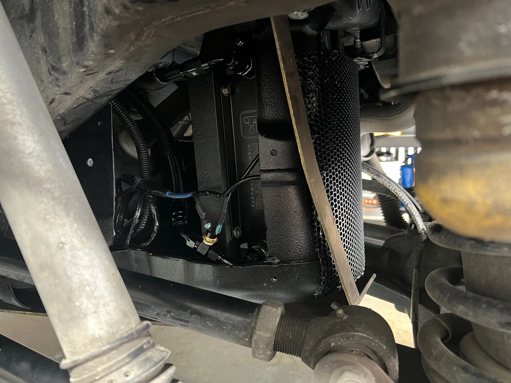

Upgrade, I tow a 5000 + travel trailer around this country and have seen high temps. I also have installed an insane diesel bypass oil filter kit with an oil cooler last month. Put the oil cooler in the def tank location, full delete here. Fully armored too. Pretty much done everything to cooler the motor off, I also have methanol injection
