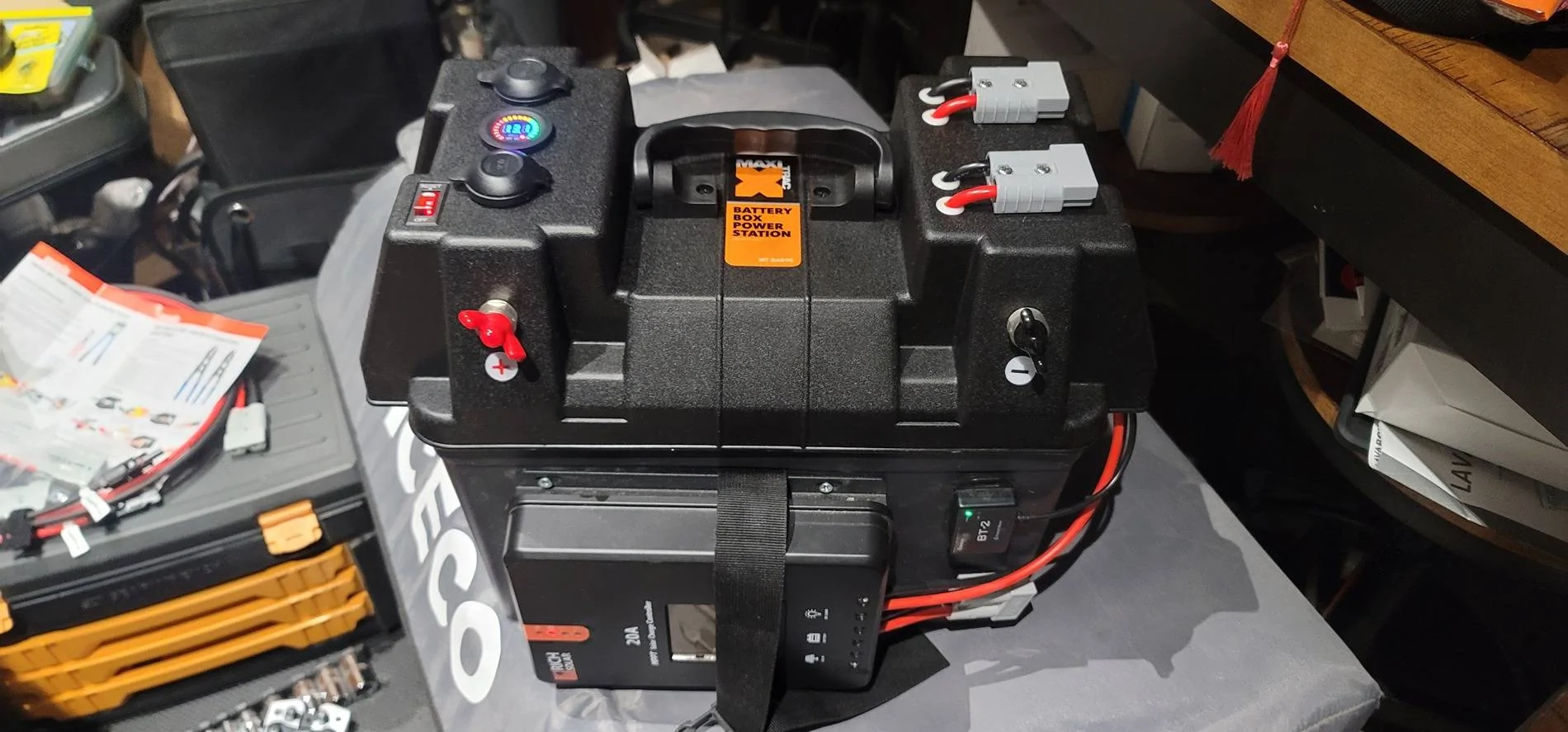

You can build a relatively cost effective unit with a 100ah lifepo4 (from Renogy or Litime). Drop it in premade battery box and slap a charge controller on it. Then wire it to solar and/or your vehicle.

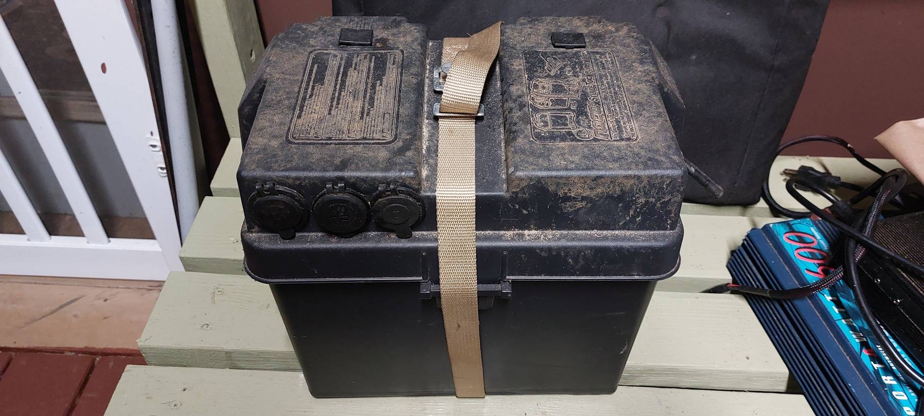

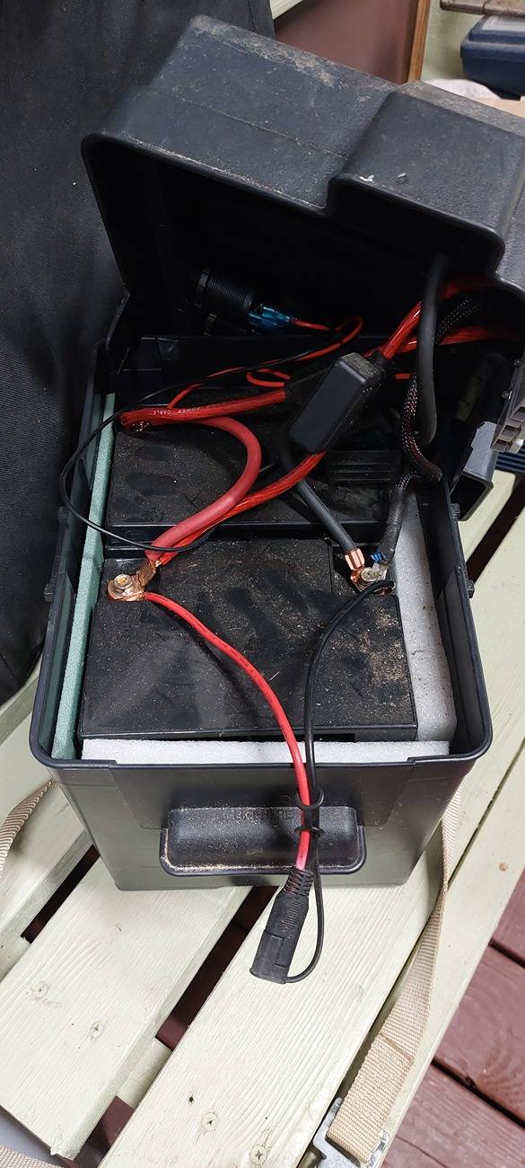

Two 36AH LiPo batteries, usable for my trolling motors in pond prowler boat and what ever else. Including a 2k electric winch 3 weeks back.
